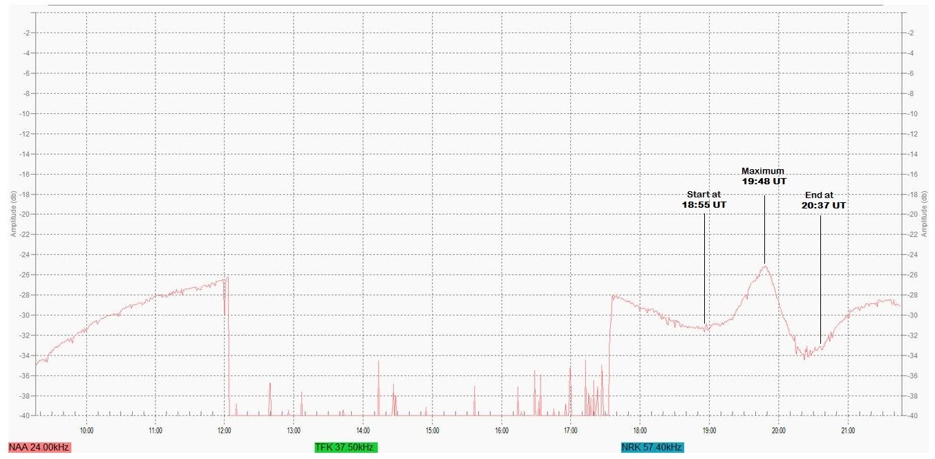

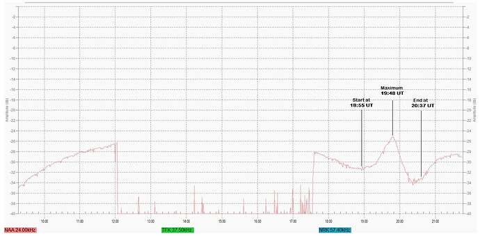

Here is my measurement of the 2024 eclipse over the US, along the propagation path towards Ireland. The amplitude of the 24 kHz NAA Navy transmitter in Cutler showed a noticeable change during the eclipse.
