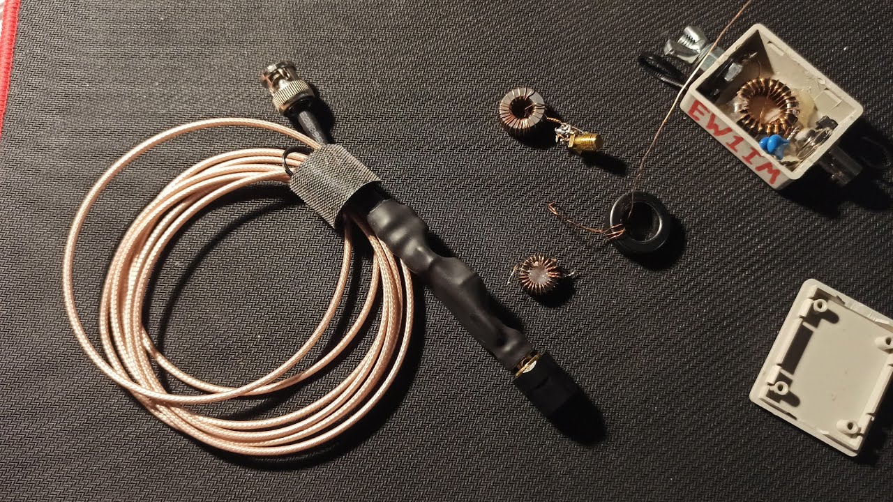

Hello folks,
Following recommendation about toroid winding I did a few experiments (not yet finished).
But a the beginning I want to say thank you for pointing to this ideas.
Here are what I got:
  1. Pic. Separated windings for primary and secondary but with crossing (W1JR). Too much inductance due to fact that this crossing reduced winding capacitance. I want to try 0.4mm wire instead of 0.6mm as on picture. But can be used if you observe to many capacitance (upper graph is reactance with step 10 Ohms ). Measured capacitance for lowest SWR is 88 pF but I soldered 100 pF (don’t have 88 =) )
  2. Pic. Common (not recommended winding) with gathered primary and secondary 3 turns and capacitor 150pF. Unfortunately forget to add reactance graph. Used wire is 0.4mm.
  3. Pic. Separated windings for primary and secondary but WITHOUT crossing. Measured capacitance for the lowest SWR is 70 pF but I soldered 100 pF. Used wire is 0.6mm
It is important to mention that wire diameter impacts on winding capacitance and that is why care about this and don’t solder 150 pF without measurements.
I used variable capacitor 20-250 pF for adjasting for lowest SWR.

Hello Armin,
Good point, all toroids are FT-82-43 Amidon.
Chris,
I am also very interested in to check this. Hope will find some time and compare with 20 meters DX-WIRE UL.
These are 3 different transformers, not rebuild of single core.

Hi Martin,
I did this already with different cores.
But testing with this approach requires one import point. The output impedance of transformers should be identical.
In my case, then I checked losses of two identical transformers (connected in series), I noticed that SWR of S11 shows about 1.5
This means that some transformer e.g. the first has 3050 Ohms and second has 3350. Checking SWR with 3200 Ohms shows the same almost SWR for both transformers. But in case of serial connection we need variable capacitors for both cores for tuning to 1.0 SWR.
Im my cases with and without capacitors the difference was about 0.2-0.3dB.
And my point in this that losses due to output impedance mismatch and measurements losses are bigger that lossos with different winding patterns.
I think the more important is inter-turn capacity of winding.
In case of producing tight winding the inter-turn capacity will be bigger than increased inductance =)
BTW, thank you for interesting discussion =)
