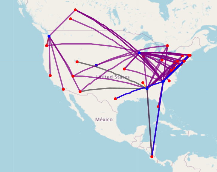

Would it be an abuse of the RBN website to just use their tool for it? It looks like what is needed can just be passed in via url, e.g., for current CW spots, the following generates the following map.
RBN - Reverse Beacon Network

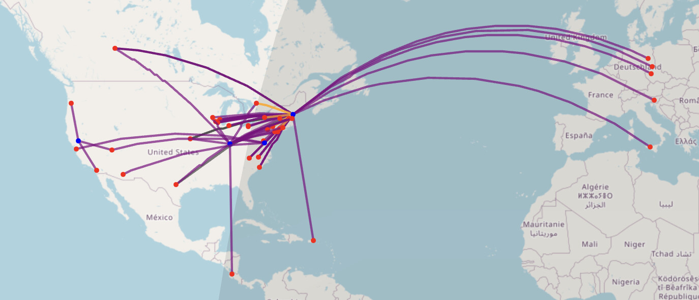

Maybe not exactly what you’re asking but it does map spots up to an hour old.
Made by @M0TRT
Thank for linking to this. I was thinking that map with the RBN spots overlaid. I will reach out to @M0TRT to discuss.

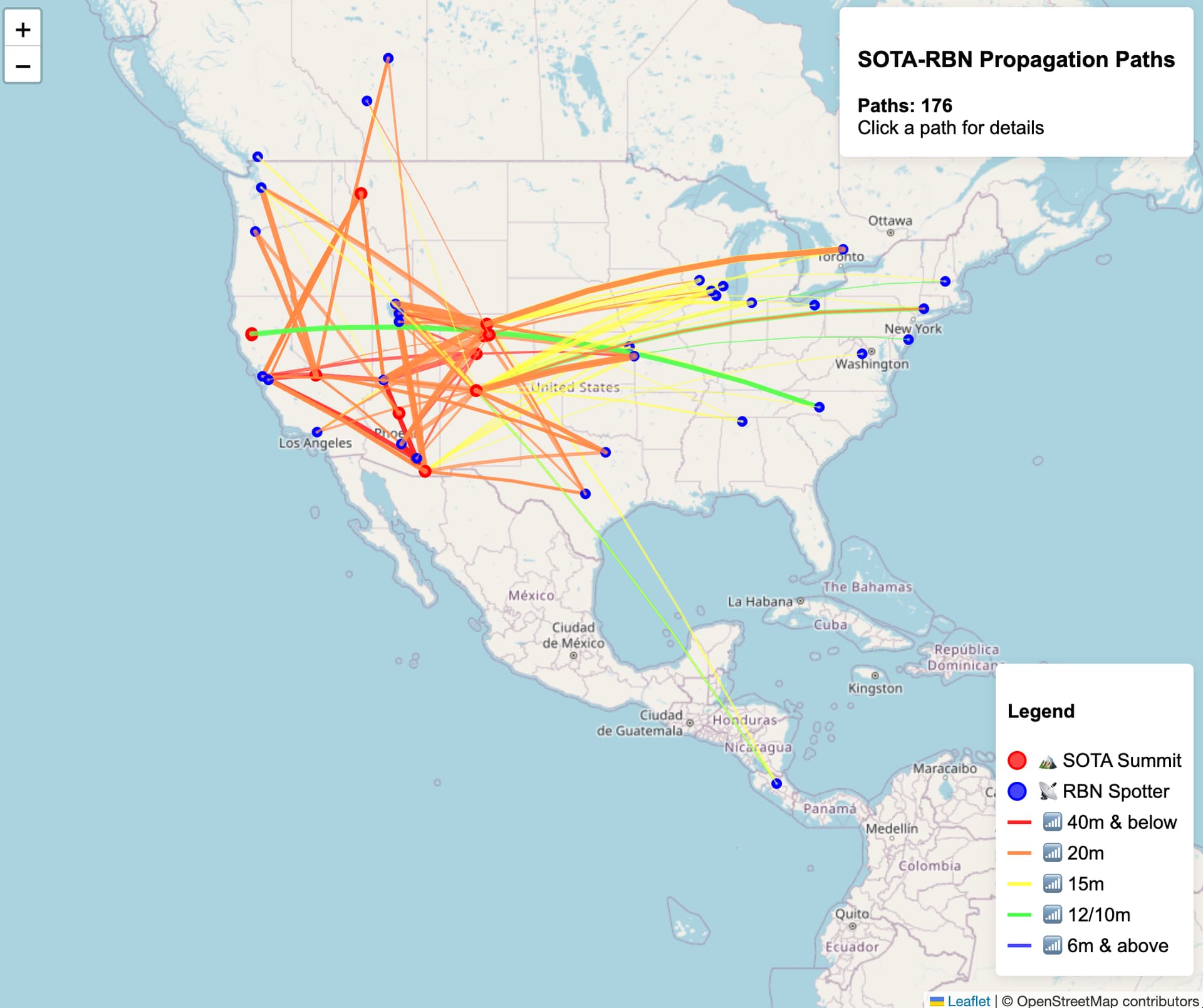

I’ve put together a bit more of a prototype on my end, it shows RBN spots liked to summits, on this map in the last 10 minutes. I can see a ton of activity on nearby RBN skimmers, for example. I’d love any feedback.
This was also an interesting exercise in Vibe coding, and has taught me a lot about what works and doesn’t work, but regardless clearly a very powerful tool. This took maybe 5 hours starting with basically no knowledge of how to make this type of page. It currently runs locally on my NAS and isn’t really a truly interactive site. On Github: GitHub - km6am/sota-spot-mapper: A local tool to pull sota/RBN spots and generate simple visuatlization
It is NOT a finished tool, but if anyone has feedback it would be very much appreciated. I am also not competent to set this up as an active webservice for the public so welcome anyone who would like to run with the idea/

I have a live version of this tool now if anyone is interested at km6am.com Any feedback would be appreciated!
