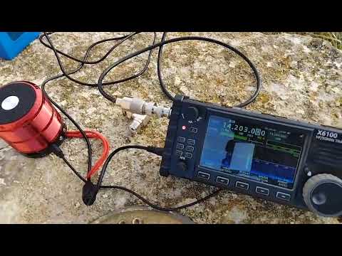

OK so I’m finally back home now. Here’s some neat things that are being down with this rig. Above my skill set but looks doable…

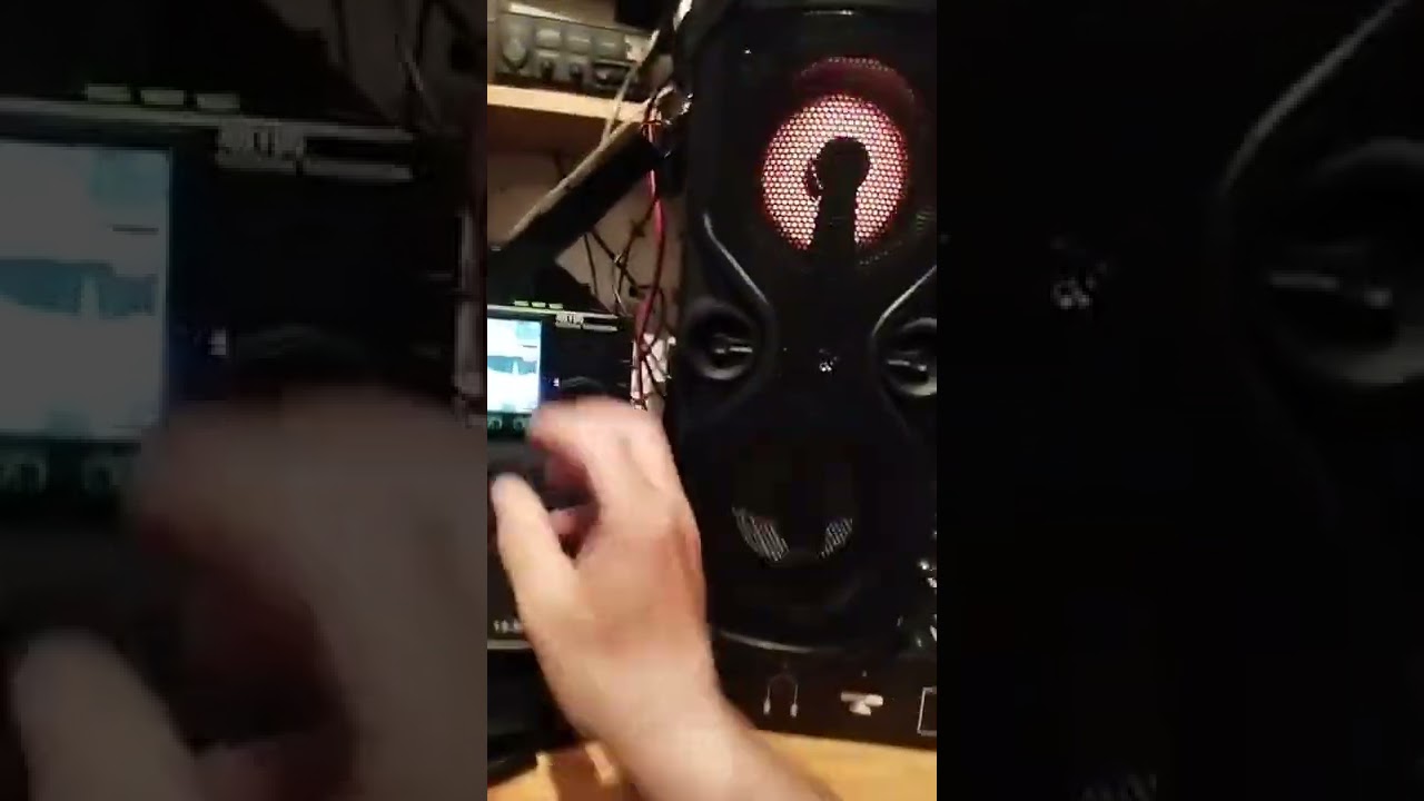

Here’s one with JS8 call running:
I had been watching KM9G’s youtube channels on their exploits on hacking the 6100 a few months back, but decided to go a different route and picked up the FX-4C to play with. Maybe should have waited :wink:
This is pretty awesome. One can go out in the field and operate digi modes without lugging around any extra equipment ie Computer etc etc…Pretty slick!
