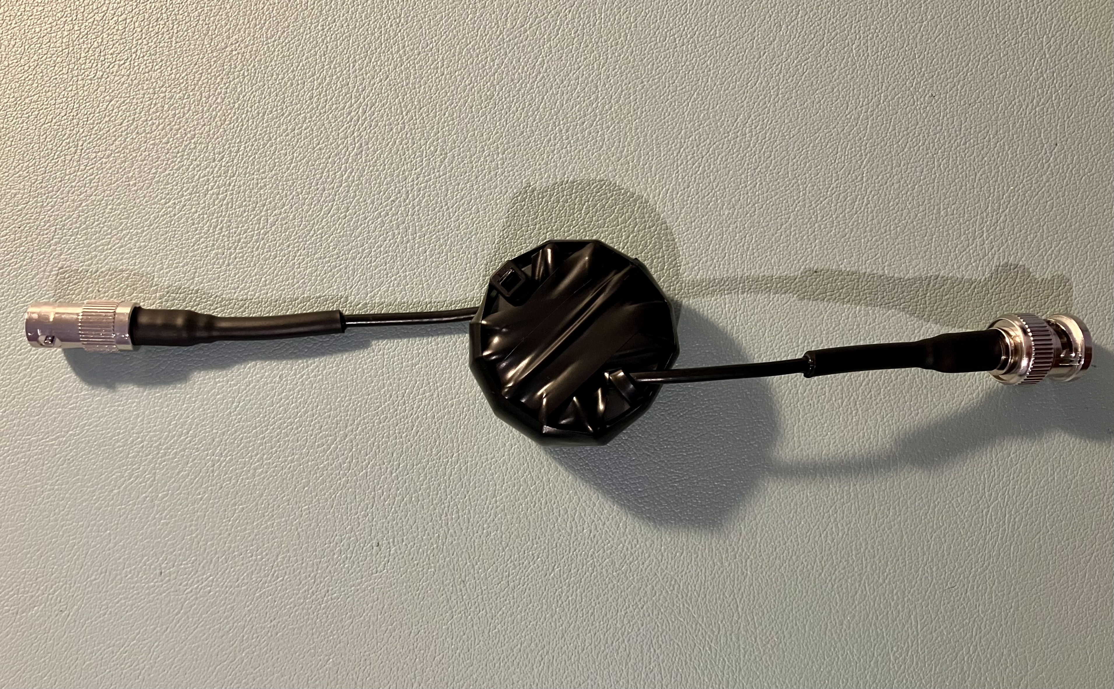

Ready for tomorrow. Hopefully it sorts the problem out. :crossed_fingers:
UPDATE:
Tried 10m today.
I managed Canada & Lithuania on a car battery, then switched to my tiny 12v 3ah battery to confirm there are no power problems, and bagged a USA contact. I managed Serbia but can’t remember which battery I used.
I think problem is solved. Just need more drive out of the mic (it’s a bit quiet). Nearly nearly there
 :+1:
