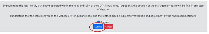

The submit button doesn't work with ADIF uploads.
I can’t upload my latest SOTA activation.
  • Selecting the ADIF file works.
  • All QSOs are displayed.
  • Verifying the log works.
  • Submitting the log works.
  • But the submit button doesn’t work in the last step.
    Nothing happens when I click.
I’ve tried it with Firefox, Chrome, and Firefox’s private mode. Always the same problem in the last step.
The ADIF file looks okay to me.
Does anyone have any idea what the cause might be?
73, Mathias
DH1WM

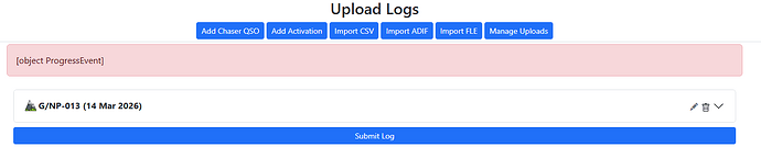

In fact there seems to be a problem with the ADIF from this one day. I just tried another day and it worked flawlessly. This is strange, as I directly uploaded the export file from the PoLo app in both cases. I will investigate this further.
Thank you for assisting. I might send the log to you later if I can’t find the problem by myself!
I think I can now exactly tell you, where the bug happens!
Sometimes when I get a GMA reference, I log it under the SOTA reference on the fly. When I clicked the “Verify Log” button, I got the expected error message, that the S2S reference is invalid. As usual, I deleted this S2S reference. Clicking on “Verify Log” again worked and I was able to submit the QSO.
But it seems like the online editor has a bug such that I got the error “[object Object]”. I confirmed this with two ADIF test files each containing just a single QSO. There is only on difference beween these two files:
  • File A has an invalid value for <sota_ref> in the ADIF, that I cleared with the online editor on the sotadata website before verifying
  • File B does not specify a <sota_ref> at all
In fact I was able to upload file B flawlessly, but file A lead to exactly the same “[object Object]” error.
Can you please check, that clearing a S2S reference in the online editor works correctly?
