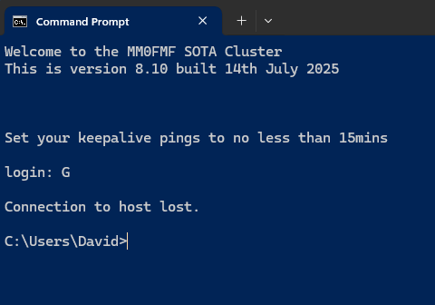

When I connect to cluster.sota.org.uk 7300, I get to the login: prompt, but typing a single character (and no RETURN) causes the connection to be lost - see image below.
Not sure why? But the late G3NYY reported a similar problem on the Reflector back in 2018/19 using the Telnet client from Win7 Pro.
Don’t know if this ever got resolved?
73 Dave
PS I believe Windows tends to use UTF-16 characters (2 bytes minimum) to accommodate the languages of all the countries for which it can be ‘localised’. Linux uses UTF-8 characters which are typically just a single byte for A-Z, 0-9 and a few more. May not be relevant?
Yes it doesn’t work. Sadly not ideal for Windows users.

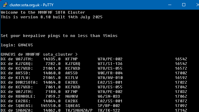

Putty works on Windows 11. I had to set Passive mode in the Telnet config.
After few tests, likewise for me, using Putty in RAW mode.
73 Dave
Thanks for the comments. I’m in the process of divorcing myself from Windows, I have a nice W10 Pro desktop that wont run W11 and having run W11 on Mrs. FMF’s laptop and my work laptop I have absolutely no desire to inflict more W11 nonsense on myself. Hence, and I’m sorry for those who are into the MS CoolAid, I wasn’t bothered that the console experience on Windows is not so good. There I’ve come out and said it, Windows is a second class target for me.
Now I know I have written in the past about Raw mode and PuTTY but when writing the initial post earlier today, Raw mode would not work. Just wouldn’t. Seeing Dave got it going all I could think was I had updated PuTTY since I last tried, so maybe this version has a Raw mode bug and so I updated to v0.83 and it now works in Raw mode. Also in Telnet passive mode on PuTTY 0.83.

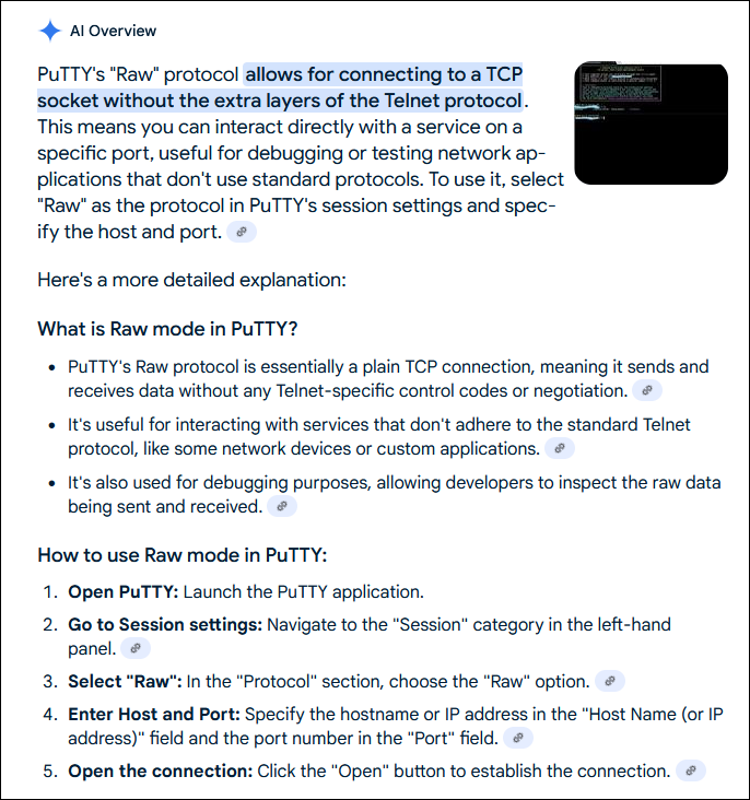

Consulting the Oracle (Greek mythology, not database) … Putty RAW is apparently just TCP without the Telnet layers:
73 Dave
