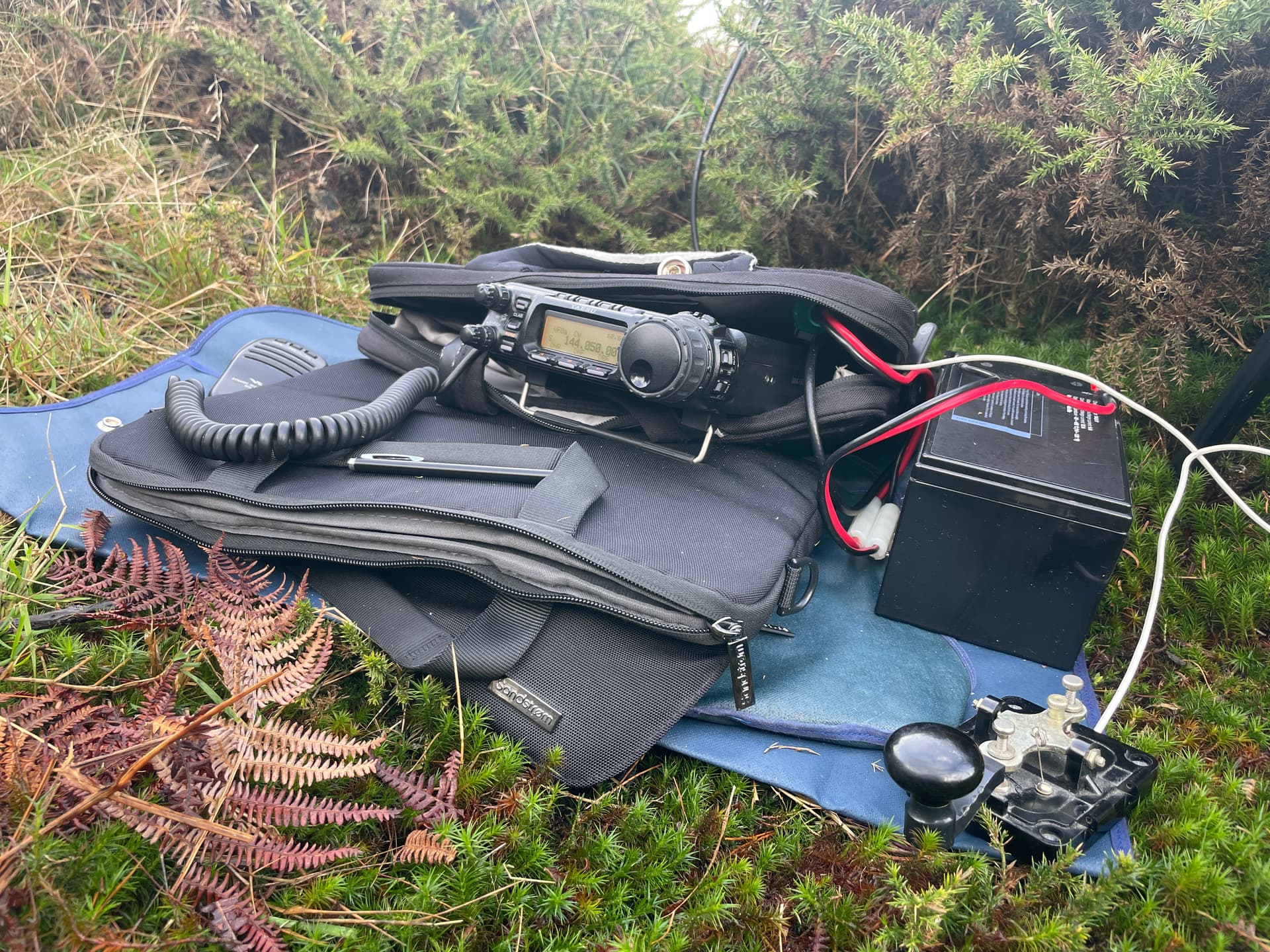

It was good. I’ve nothing to compare with though, but it looked to be ok. I still need to familiarise myself with the rig. I was running 20W into 3 el Yagi. Heard also GB3VHF beacon from JO01EH, that is 480km, quite promising so far.
Here was my setup, I’ve had nothing proper to fit the radio so used a laptop bag “temporarily” :slight_smile:

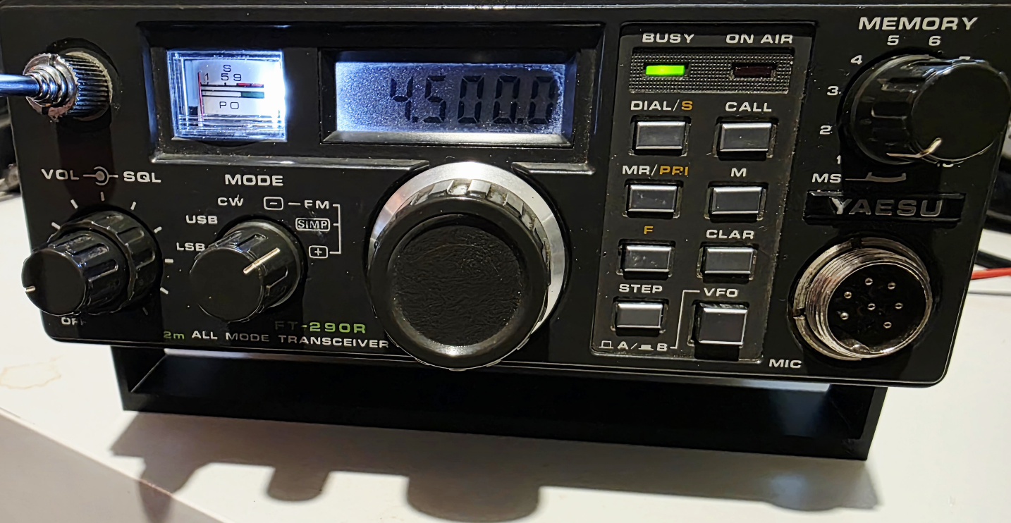

144.050 on the display too. Classy! :grin: :crown:

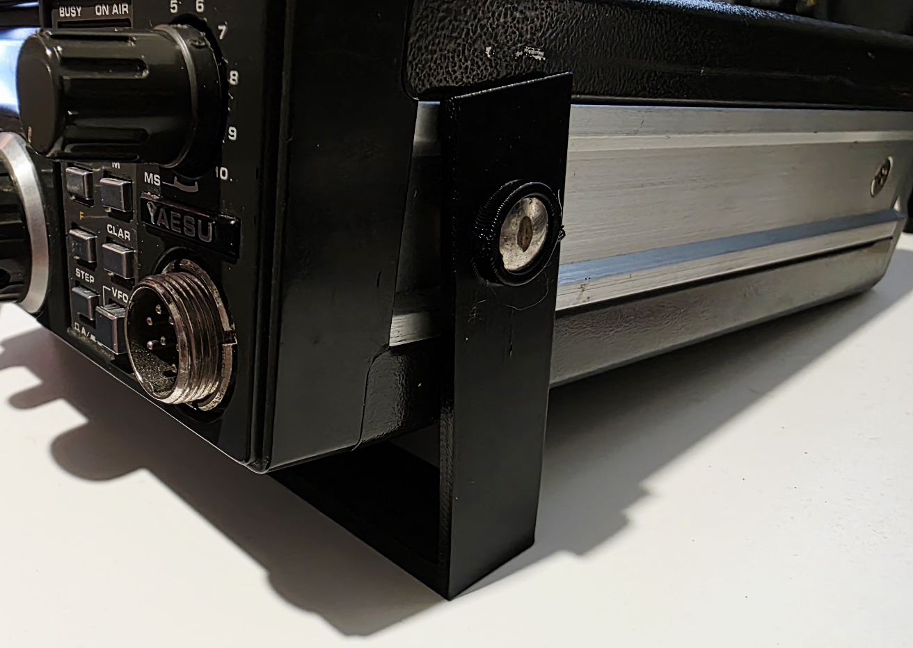

Just wanted to share a 3D print I made today. It took about 97 different revisions over the weekend, after I thought about it end of last week. Wasted about 432kg of PETG but here it is:
The Yaesu FT-290R Hyperstand Turbo 9000
You can download it here:
https://makerworld.com/en/models/1981747-yaesu-ft-290-hyperstand-turbo-9000
Here are some snaps of it. It works as both a stand (or Gareth Bale, whichever) and a sort-of-but-not-really-100%-trustworthy carry handle.
The (Gareth) bale simply press fits in to place around the lugs where the shoulder strap is supposed to go. Print it in PETG for the extra strength/outdoorsynessness of the whole thing.
I hope this rather simple little design will be of help to fellow FT-290R fanatics. :blush: :+1:
NOTE: The above snaps were a PoC print when I made the legs too short to swing over the dials for the carry handle capability. It hopefully shows it off enough though for anyone interested. It took about 73,812 megatonnes of filament because the shoulder strap lugs were a pain in the proverbial to line up, then the inside holes needed an extra bit of alignment to give the ‘press fit’ element to it.
Anyways, just a small contribution from a total beginner. Hope it helps. 73.

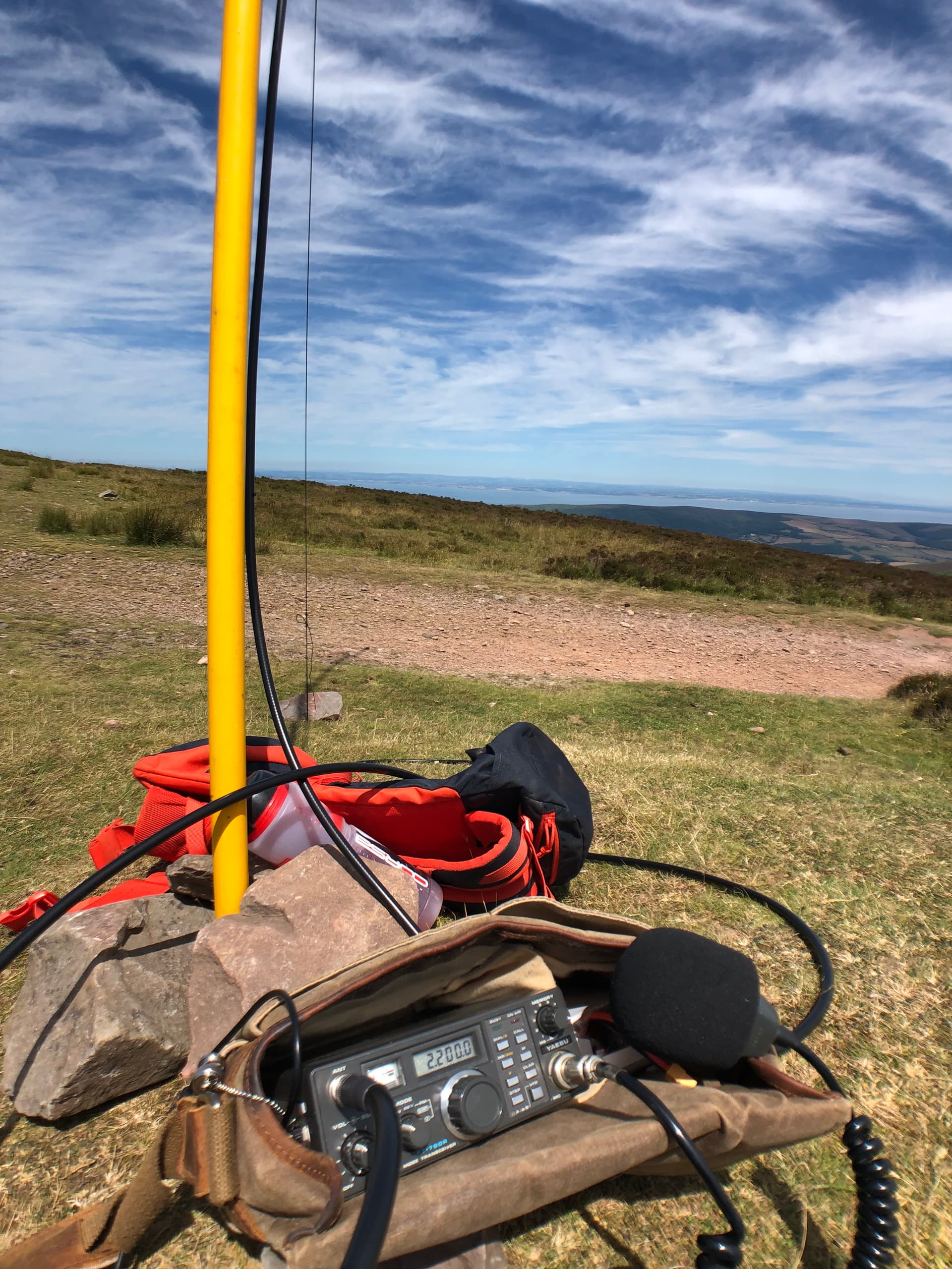

Loved this thread! I used a FT790R to activate Dunkery Beacon, and in conjunction with the FT290R, worked through a number of satellites.
