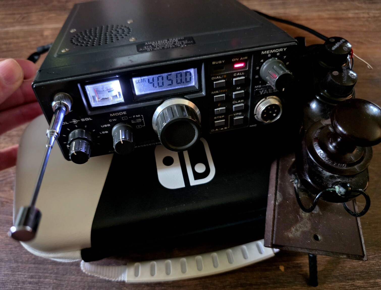

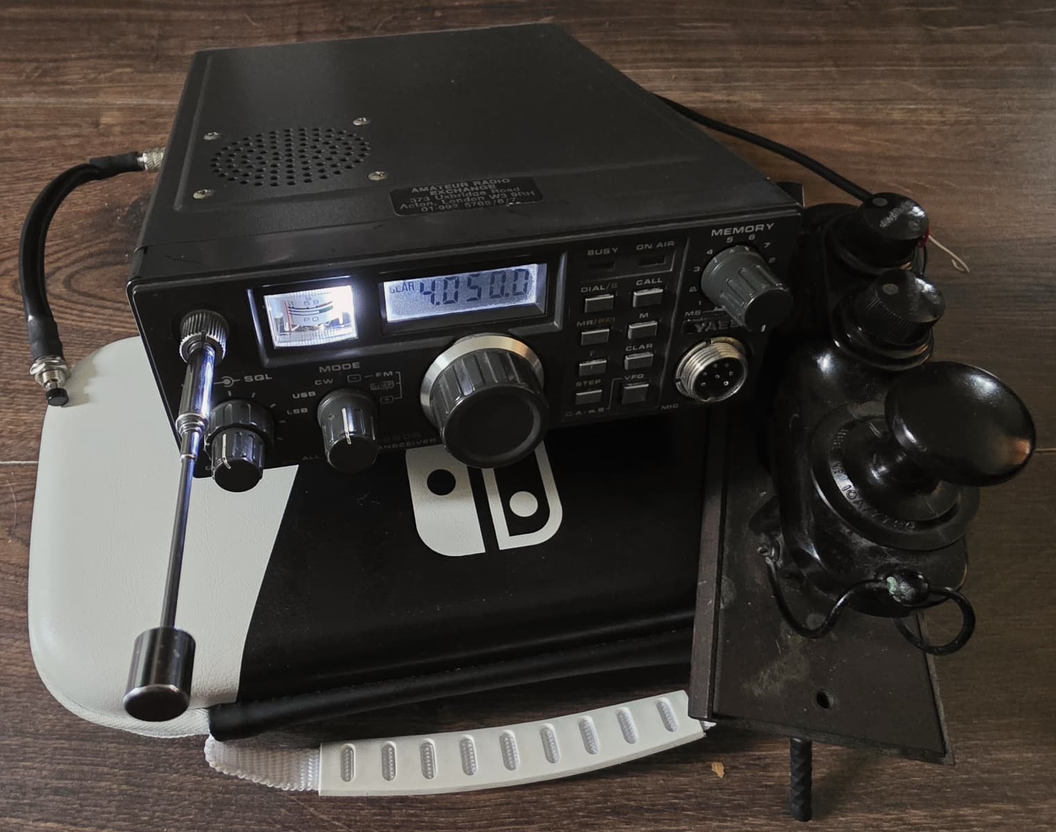

I couldn’t wait to try out Adrian’s solution so remembered I made up some momentary push switch morse keys which might work as a PoC.
I plugged it in to the standby port, removed the Yaesu mic to make sure there were no cameras, mirrors, trapdoors or David Copperfield’s knocking about the gaf and gave it a try.
It works!
Tried with my beloved bathtub key, no problem. You can also see the key transmitting the break in that the PTT would be doing, as shown by the red On Air LED illuminated.

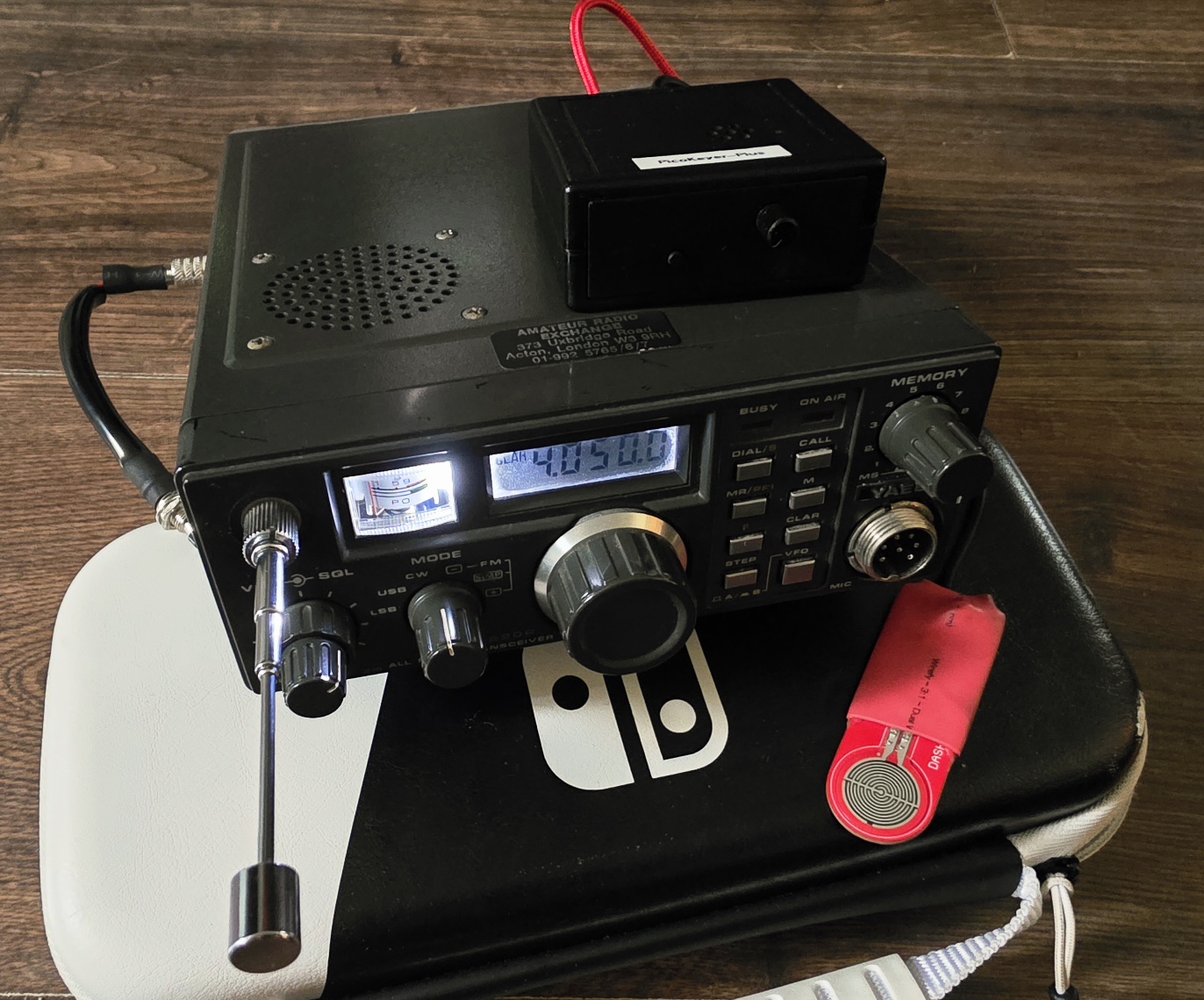

I then upped my game a bit and tried connecting a VK3IL paddle I made to my Picokeyer Plus.
It works!
Top tip though if you are using a paddle (or a straight key for that matter). Turn off the lamp unless you want people to think you are holding a warehouse acid house party! The strobing is not fun!
So now I just need to get a surface mount on/off rocker switch, wire it up to a 3.5mm jack (stereo works as well as I proved here though I only have one channel and ground wired) and pop it in to the standby jack!
