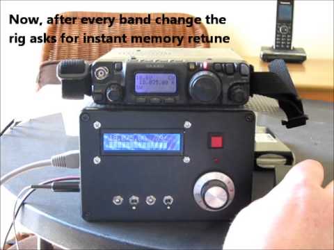

My mate Bernie made an Arduino based self tuning loop. It had a motor to drive the capacitor and SWR bridge and the controller drove the motor to get the lowest SWR whilst you put 500mW into the loop from your radio. I’ll see if I can find the video.
