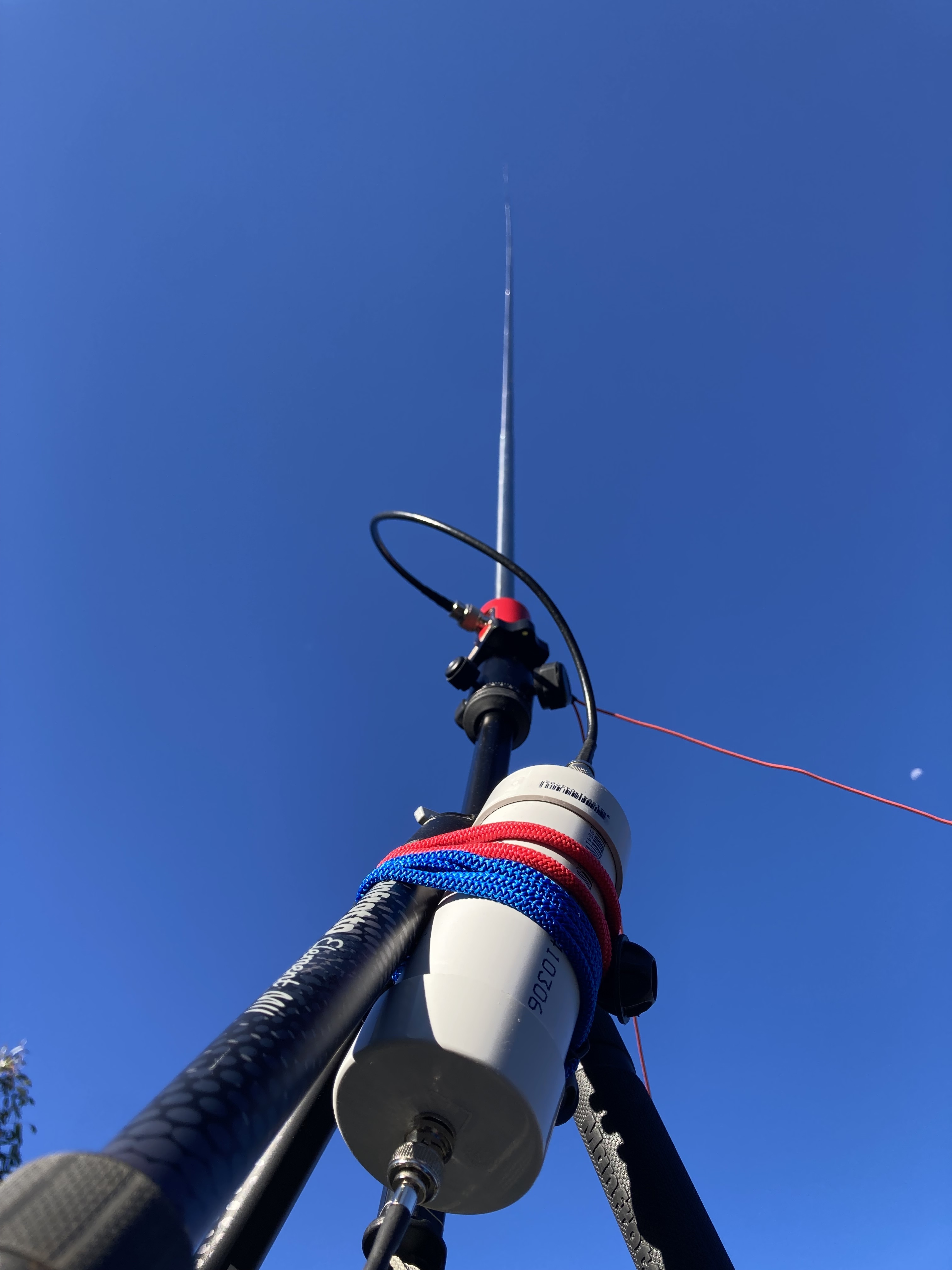

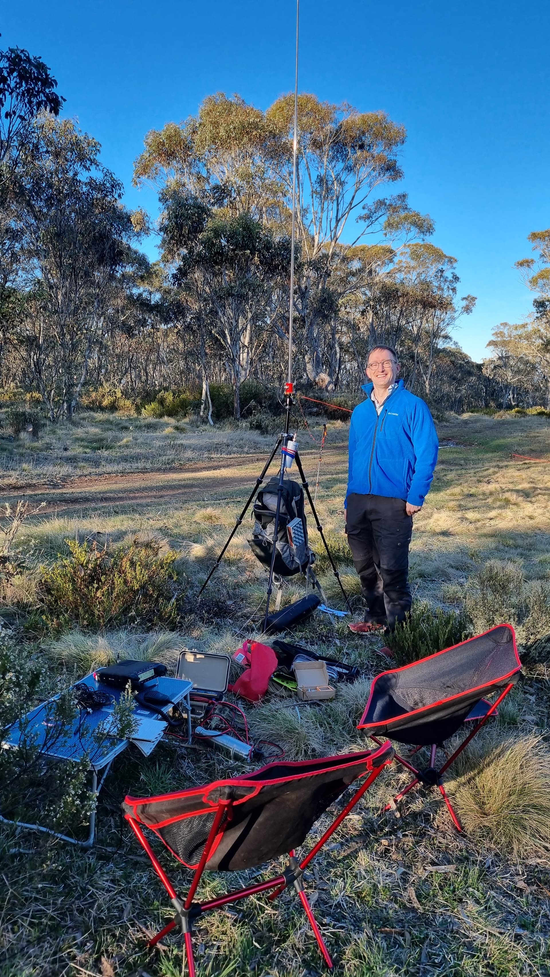

The antenna I’m standing next to is my version of the POTA-Performer, hastily built on Friday, including modeling and 3d printing a Arca-Swiss compatible dovetail mounting plate for the tripod.
First QSOs on it I believe were S2S’s with DM and OE. Very nice being able to fine tune the frequency by extending sections.

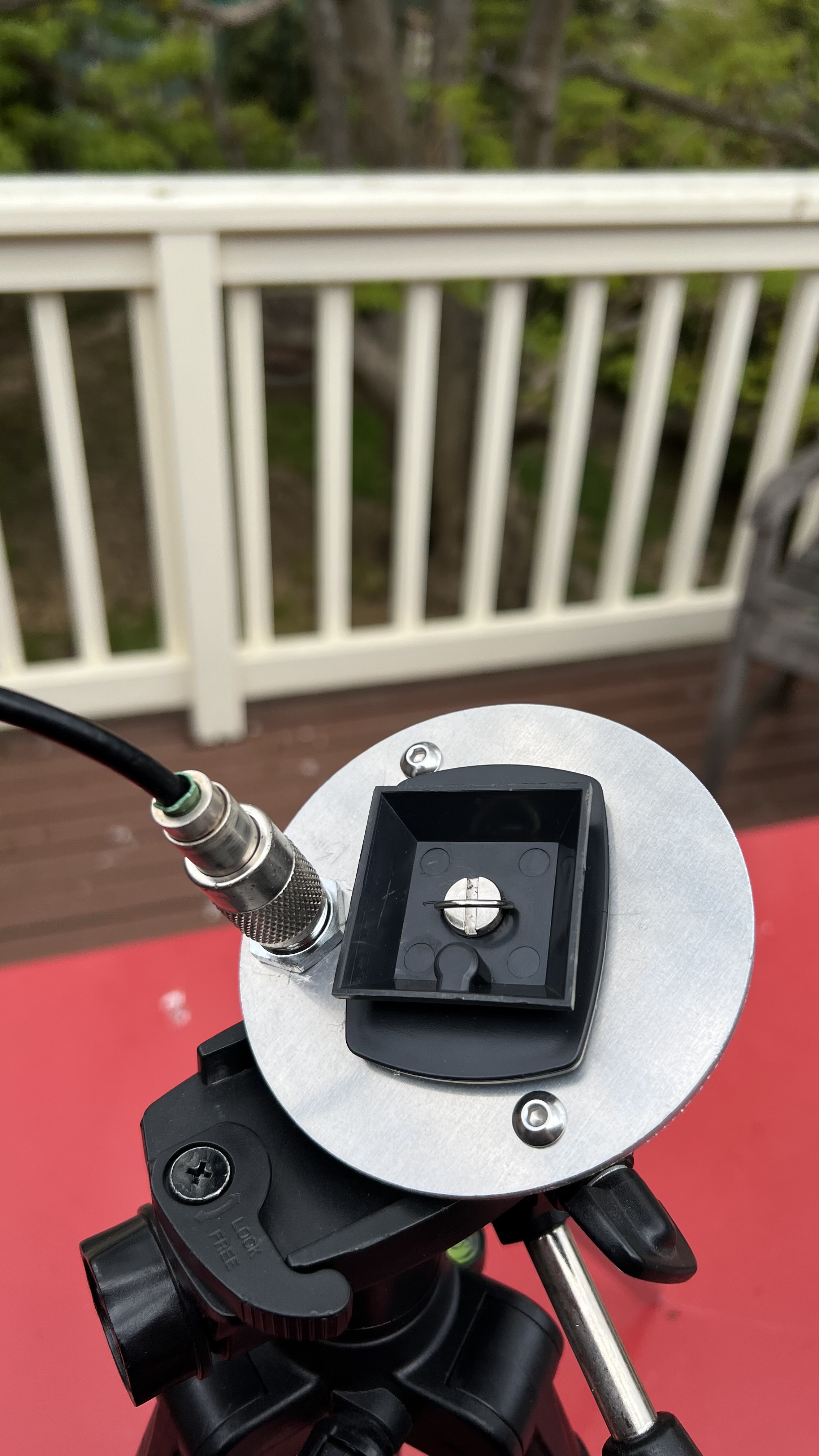

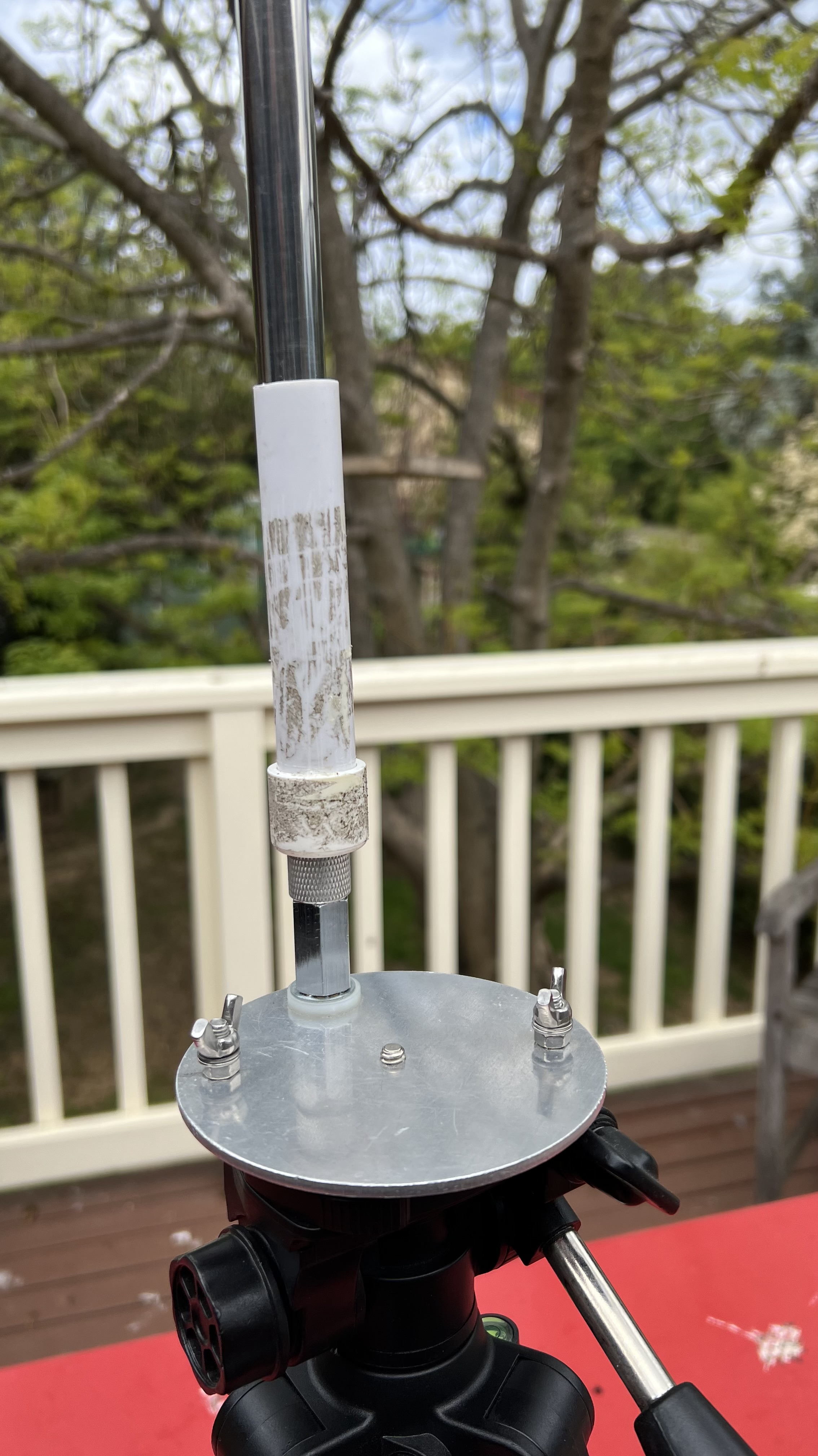

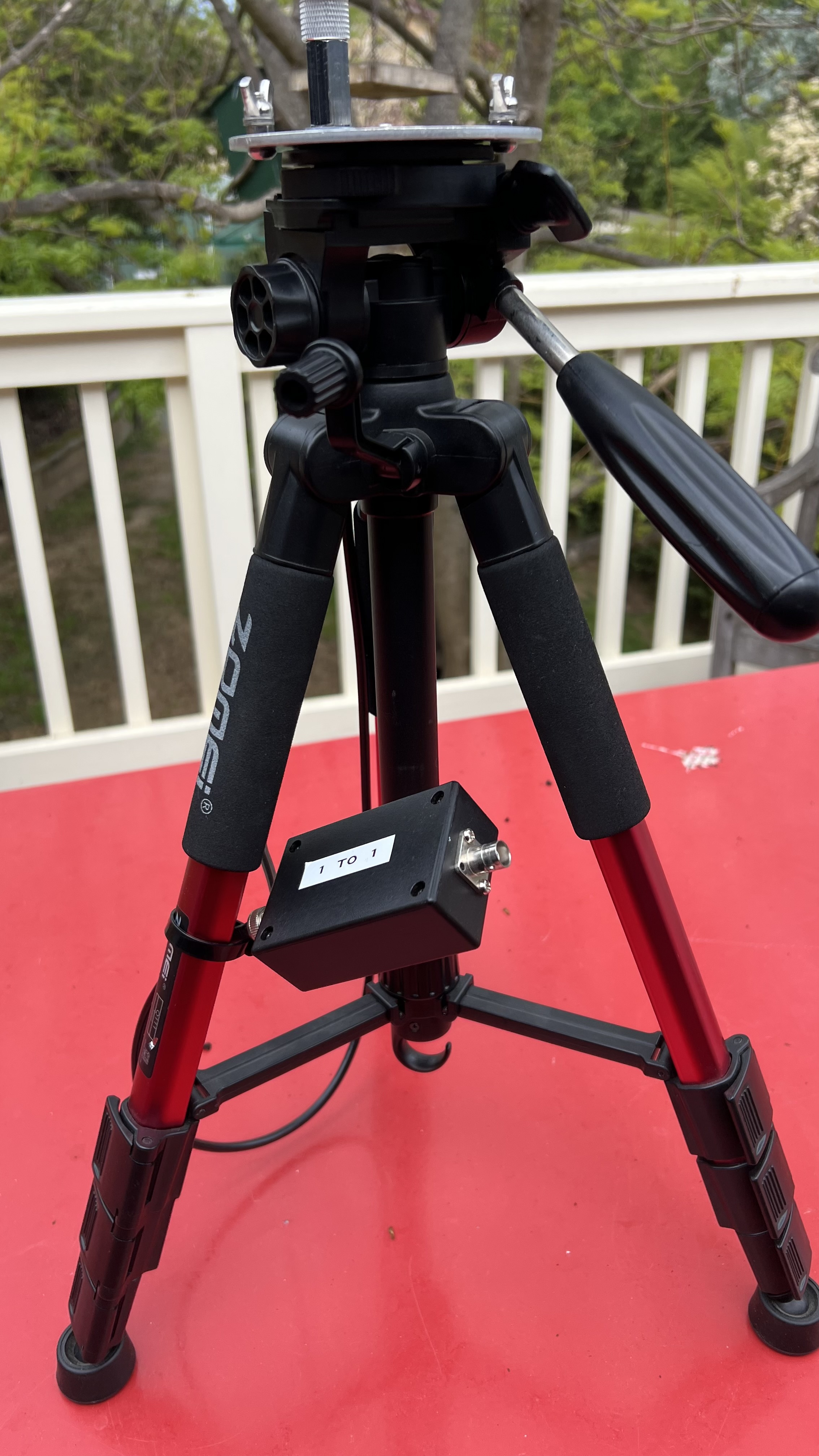

My version of the 20m GP, 5 metre stainless steel whip and tripod base. We may have similar construction techniques. The four elevated wire radials are secured to the aluminium disc by two M5 thumbscrews.
Andrew VK1AD

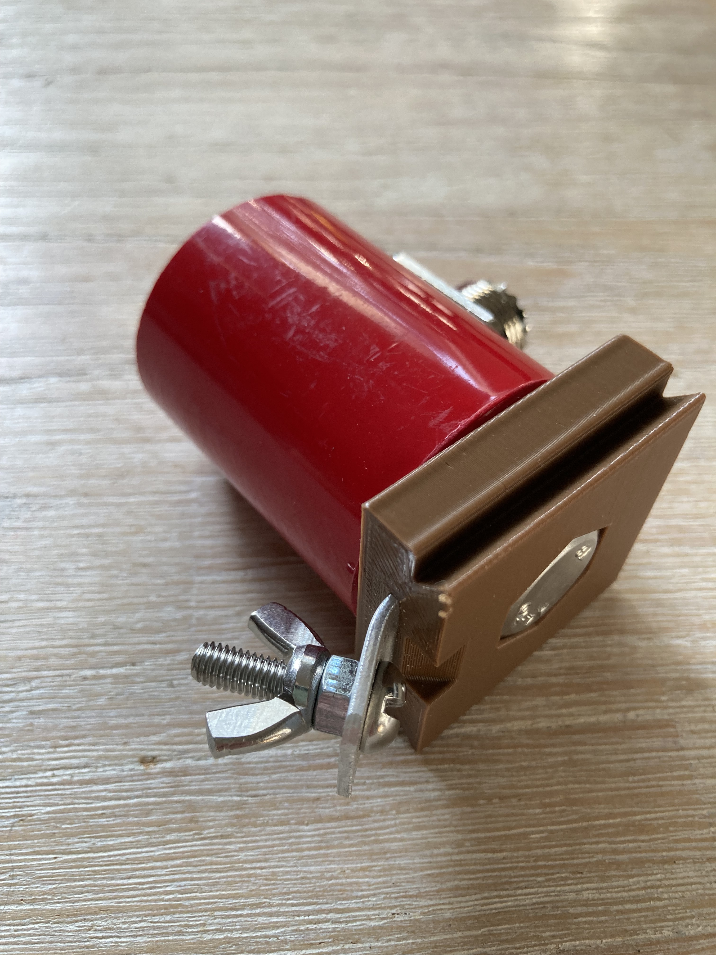

Mine is based on an aliexpress special:
I can’t tell you how satisfying it was for the 10mm bolt head to just slide in perfectly the first time.
Some settings need tweaking on my printer (rounded corners) and brown because I have 1kg of it for some reason…
The 3d print is not the weak point of that antenna. 40% infill and it feels indestructible. Not one for summits with more than a light breeze I think due to the whip and toppling risk. Only two radials at this point for directivity and time.

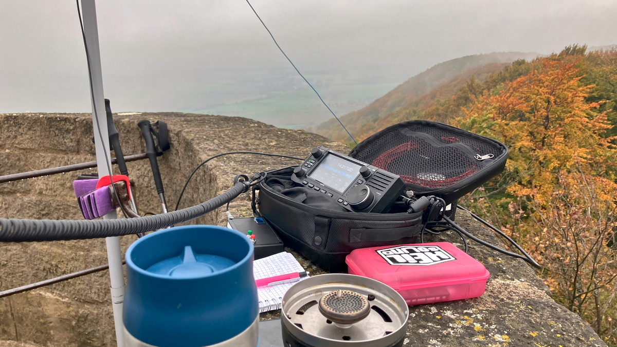

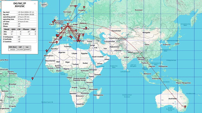

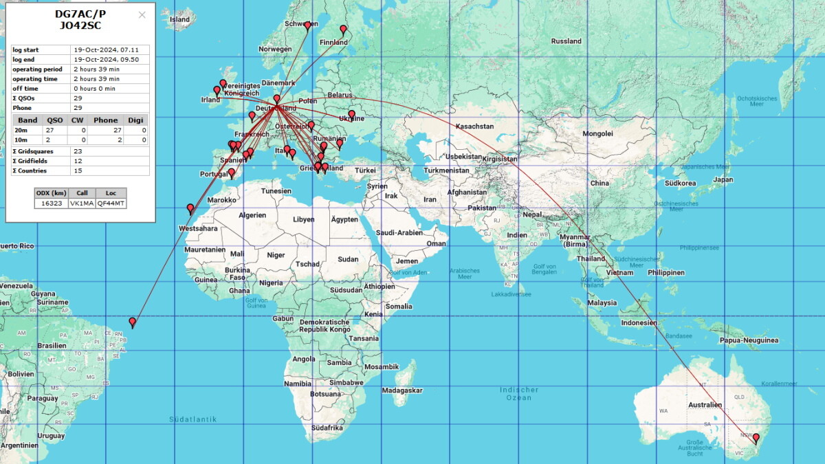

Once again, Lauensteiner Kopf DM/NW-135, 440 m asl
IC-705 @ 30 W, DG7ACF multiband vertical antenna 17 m agl
Not exactly fb condx. 10 m was a total disappointment. Only 2 qsos made, PX0FF + EA7.
20 m was so-so. Overall high noise level at S4, I don’t know if qrm or qrn. Maybe the M-class flare in the early utc morning hours is to blame. Anyway, some callers just didn’t make it through the noise. Sorry.
One of them was a station with 1 and ending alpha. As I was thinking I heard something like an ozzy accent, I just tried the first VK1 callsign ending alpha that came to my mind, VK1DA. But it wasn’t VK1DA. Sometimes, this strategy works, this time it didn’t.
At 0818 his signal increased and it turned out to be Matt, VK1MA. Now he was 57 in the clear. A nice chat followed, however it was a technically difficult one with qsb dragging Matt’s signal down to noise level several times.
