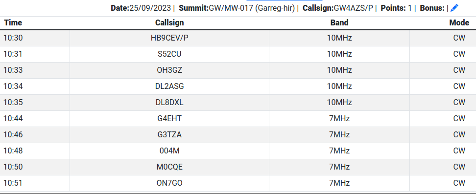

I mentioned in the alert that this would be a short activation as I didn’t want to push my luck, and in the end I worked 5 stations on 30m including an S2S with HB9CEV/P, and another 5 on 40m. In each case I worked the callers responding to my RBNHole spot, and then closed down once a few CQ calls went unanswered - so the first apology is for closing so quickly, I usually try to wait at least ten minutes after the first spot, and then a few more minutes after the last caller.
