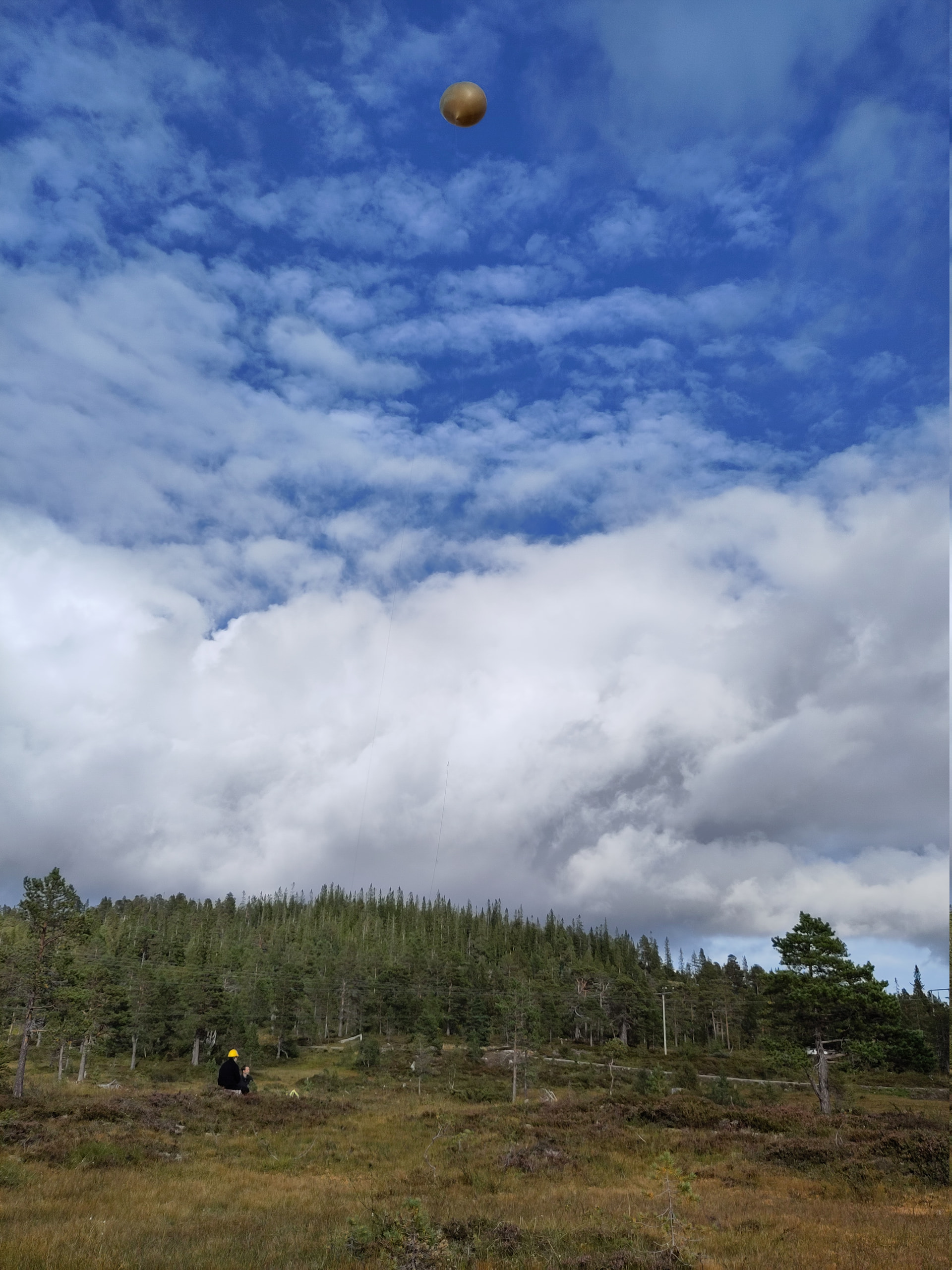

We used an old weather balloon to support our 160m vertical on Field Day 2023. It worked well as antenna support.
We had around 2 kg of reserve buoyancy, which was sufficient for us. We also guyed the balloon to keep it up against the wind. I did not try without the guy wires, but I expect it would have been quite far from vertical without them at the 4-6 m/s wind we experienced. We used fishing lines for all the structural wires, both because they are fairly lightweight and because we hoped they would not soak in the rain and interfere with the antenna pattern.
We sketched up some more details and pictures in this blog post. We found this to be a very fun project, and we intend to make another attempt this year.
