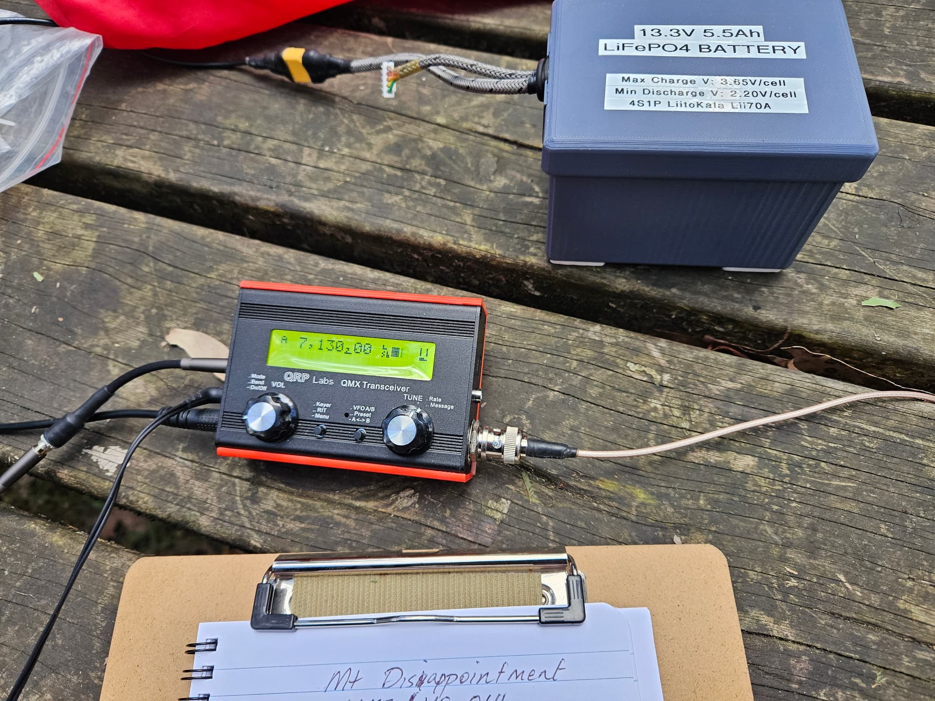

The antenna was a link dipole on a 7m squidpole and power was a 4S LiFePO4 battery via a 12V regulator. I only operated 40m SSB and made nine contacts from the usual eastern states that I would expect to work on that band. My signal reports were good for the 5W PEP power level, mostly R5 and signal strengths from 3 to 8. Comments on the audio quality were good.

I’m a little surprised by the size and capacity of your battery. With the theoretical 70Wh, in my experience, you should be able to activate it for 24 hours continuously.

Thanks for your comments, Chris and nice to hear from you as I’ve been following your QMX Carrot build with interest.
You are right - the 13V 5.5Ah battery is way more than the QMX needs, but it is what I had available. I am using an LDO linear regulator to provide a steady 12V to the radio as I’m very nervous about how I power it. It’s an LM1085IT-12 in the module covered with black heatshrink, visible in the selfie photo next to the water bottle. I plan to make up a smaller battery with 18650 cells to better suit portable operation with the QMX.

David,
What are you using for a microphone?
Warren vk3byd
Hi Warren,
The mic is visible in the selfie photo in front of the water bottle. It consists of the case and PTT switch from an old Motorola lapel speaker mic that I picked up cheaply at a hamfest. The internals were removed and a new electret mic insert from Jaycar (a local hobby parts supplier) was mounted in the centre of the grill.
I used it for a while with an mcHF transceiver, but noticed the mic was sensitive to causing RF feedback if there were power lines on the summit. I reworked it with a lining of copper foil shielding, changed the cable to a better shielded one and fitted a clip-on ferrite suppressor at the radio end. It seems to be fine now.
