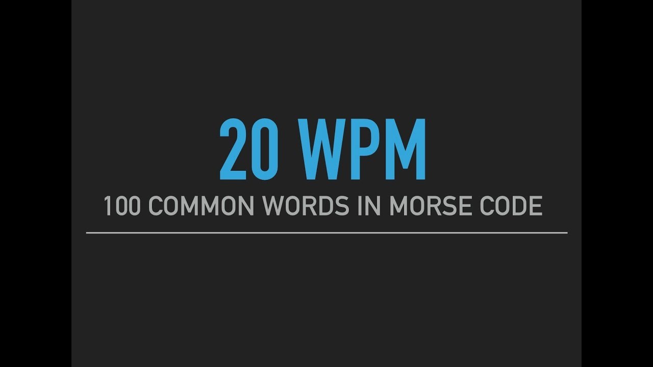

I give an example how to learn the 100 most common words in English: a link:
There is a series there where you can switch to the 500 most common words.

Thanks for the link, I’ll check it out later. The Ham Morse app also has the 100 or 500 most-common English words.
