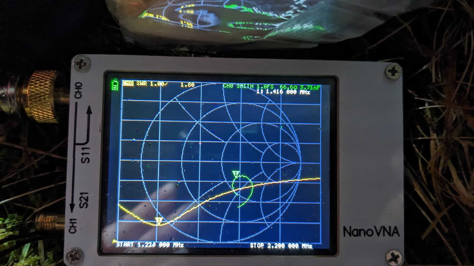

We didn’t manage to get an measurement with the antenna standing but when it had collapsed on the ground the impedance at the end of 10m of RG174 looked like the photograph below. The weather didn’t encourage to many experiments. Lying on the ground will has reduced the resonant frequency.
The rain on the screen was from inside the shelter.

Hi Kevin,
Thanks for going to the trouble of measuring it, but I was more interested in the impedance it showed while at the elevation you were able to achieve. The impedance of antennas varies greatly with height above (effective) ground, so at 6 or 7m agl, the radiation resistance would be predictably quite low, then you’d have to add ground losses which would be considerable. Hence my prediction of a relatively high impedance….
If you have time and the analyser with you, it would be interesting to see what the impedance is when it’s up in the air.
Good luck and dx. It’s so interesting to see you getting such good results from a horizontal low dipole, which the purists don’t think works at all on that band.

Hi Andrew,
I have packed the antenna analyser. We will do our best to get some measurements for you this week.
