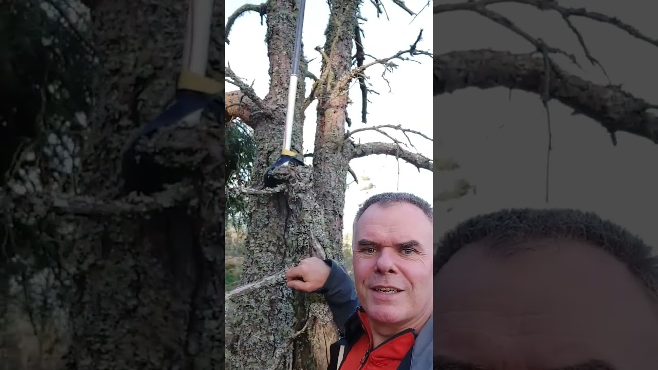

I found a more organic method.
Of course, I’ve done the same thing a number of times (first two photos). But on several summits around here, I wanted to set up away from tall trees, or didn’t have any tall tree. Usually, I had waist-height low trees but they are not strong enough to support Carbon6 under wind by themselves. One ground stake and loosely tying to the low tree worked well (last two photos).
I’ve also used my wooden or bamboo trekking pole as an extension to Carbon6. They work well but requires a bit more work, especially during winter.
