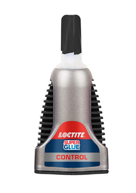

Recently, I’ve been buying the loctite hard plastic bottles that contain the gel type. You squeeze the grey plastic bits on the sides and a few blobs come out. There is a metal pin in the cap that keeps the nozzle clear. I’ve actually managed to fully use a couple of bottles, it keeps so well. Not the cheapest, and definitely over-engineered, but it works.
https://www.amazon.co.uk/Loctite-Flexible-Non-Drip-Vertical-Applications/dp/B001C42J9I
Amazon link for reference, not necessarily the best deal!
