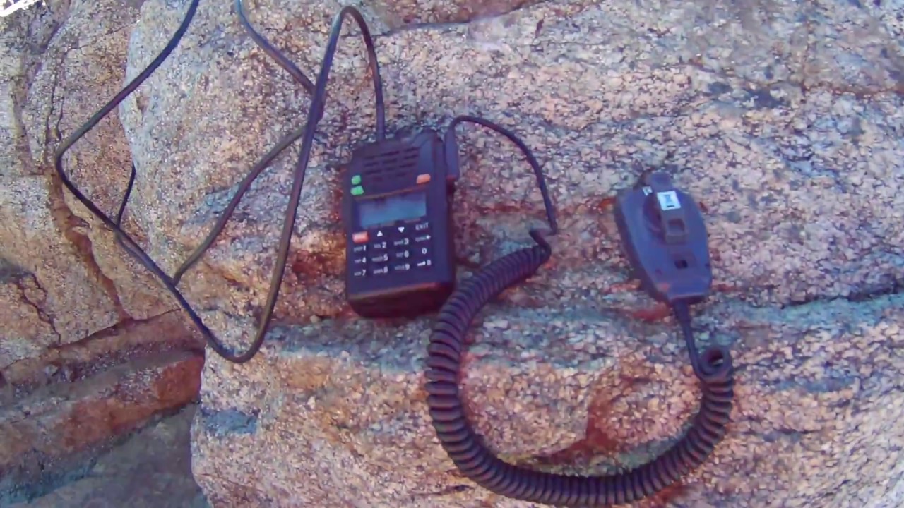

The bracket has the antenna, a helical counterpoise and a PL259 (ugh) socket output; the antenna elements unscrew. I run a coax from the antenna to my handheld via a BNC (or SMA connector) at the rig end.

I’ll use a SMA Male to BNC Female Plug Adapter Antenna Pigtail Cable 13" cable. The 13" is a bit short for my liking but the BNC is a chassis-mounting type. So, my plan is to mount the BNC on an L-shaped bracket and bolt that to a big bulldog clip I have.
EDIT UPDATE:
I’ve thought of a better solution. I’ll use a chassis-mounting BNC-f to BNC-f adapter which I’ll mount on the L-shaped bracket. That way I can use a (longer) standard BNC-m to BNC-m coax cable between that adapter and the BNC-to-SMA adapter on the HT.
