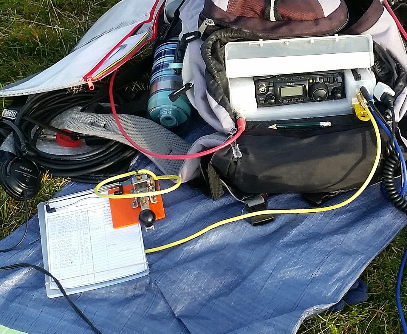

My activation key is a right rag-tag thing which originally had a plastic base, but that split and I had to reassemble it on a piece of perspex. I clip the perspex onto the clip board that I use to hold the log paper which I steady with my left hand while sending with my right. As for where I stash my pencil when I’m sending, well usually a lump of moss or a flat rock makes a decent temporary depository, indeed wherever is most convenient.
