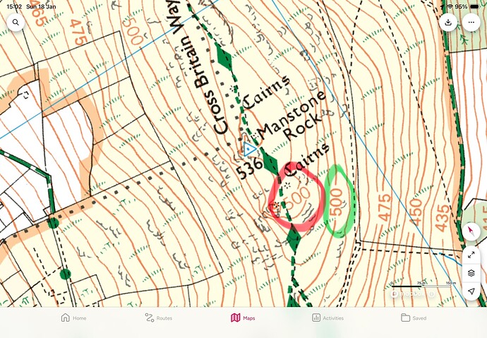

Just searched for this hence awakening a zombie thread.
The higher 500m contour line on Stiperstones, G/WB-003 seems to be incorrectly labelled on OS 1:25k maps. It seems that this should actually be 520m. There is a second, correct, 500m contour line, four contours lower.
I have just reported the error to OS, but wanted to raise it here, incase it causes anyone else confusion. It gave me a few moments of confusion on Stiperstones this morning :joy:

It certainly does look like a bit of an error.
As the 500 is not inline with a specific contour perhaps it it supposed to read 525m for the highest point just to it’s left. In a similar way to the 500 indicated by Cranberry Rock, which appears correct. Will be interesting to hear what the update is from your query to OS.

Update: OS have accepted the error, and will update the label to 520m on the next revision.
See excerpt from OS response below.
====== start =======
Morning again Paul,
This is an update from Ordnance Survey regarding the contour error you reported to us.
Pleased to say we’ve logged the contour at OS grid ref SO 36775 98485 for correction to 520m Paul. The change will be made in line with our update policy and will be updated the next time that area is revised. Apologies as of sending of this email I do not have a date for said revision.
I hope that helps and thanks for reporting this to us.
======== End =============

Great result Paul. OS confirming the error and that it is to be updated on next revision. :partying_face:
It still looks to me like it should be 525m for the main contour to the left. :thinking:
Will be interesting to see the final update. :grinning_face:
73 Peter
Not the next revision which is due in about 12 weeks but the next revision of this part of the map which could be years away.

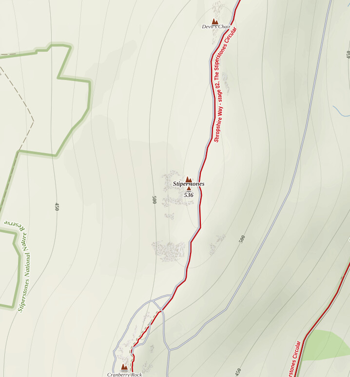

I prefer Mapy.cz open from Sotl.as
