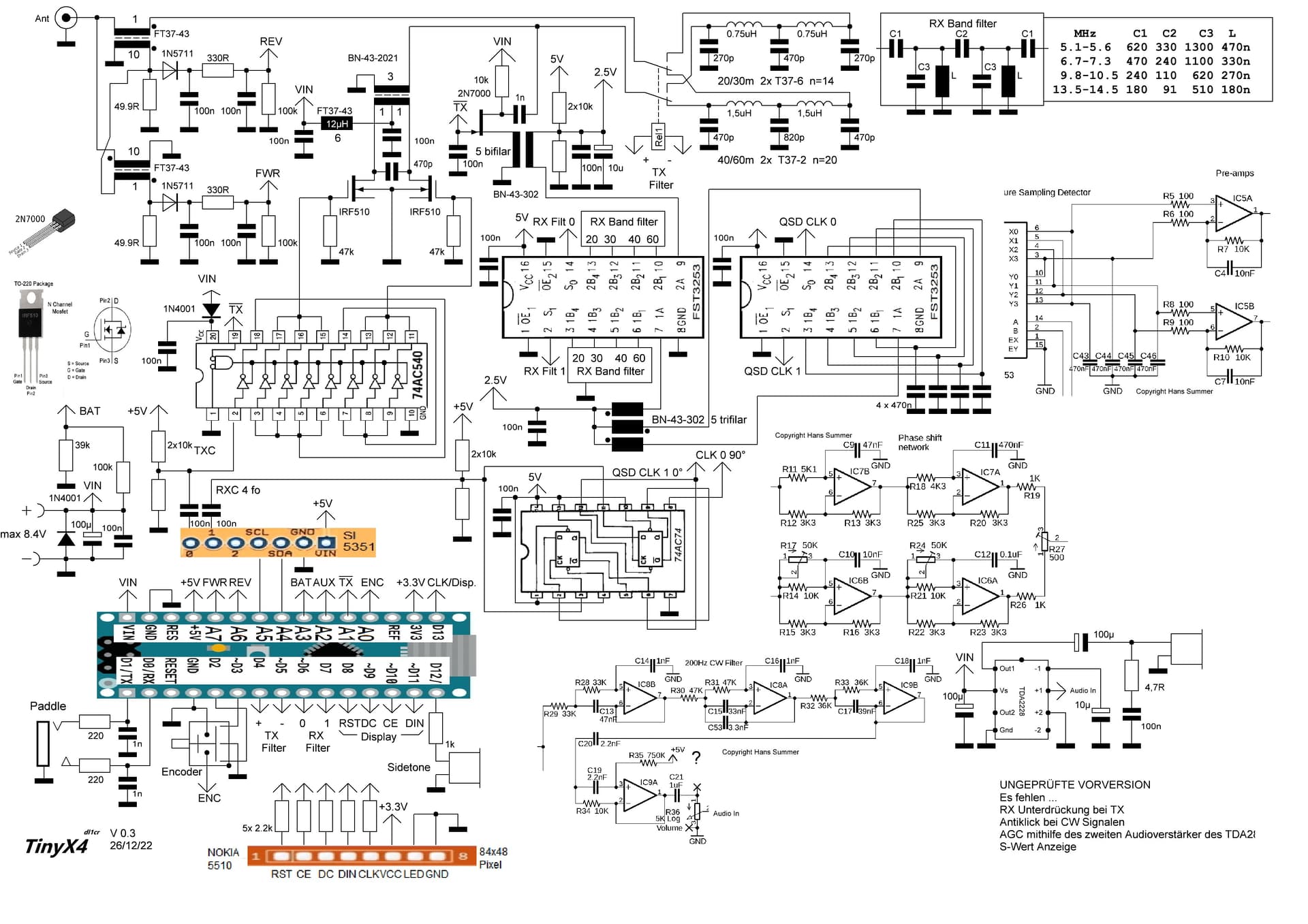

It’s not entirely a coincidence that I numbered my baby one. There are still many possible improvements. (An almost finished assembly with Tayloe mixer is waiting for me in the drawer, check below the current early status.)
At the moment I’m interested in developing a concept that’s as simple as possible.

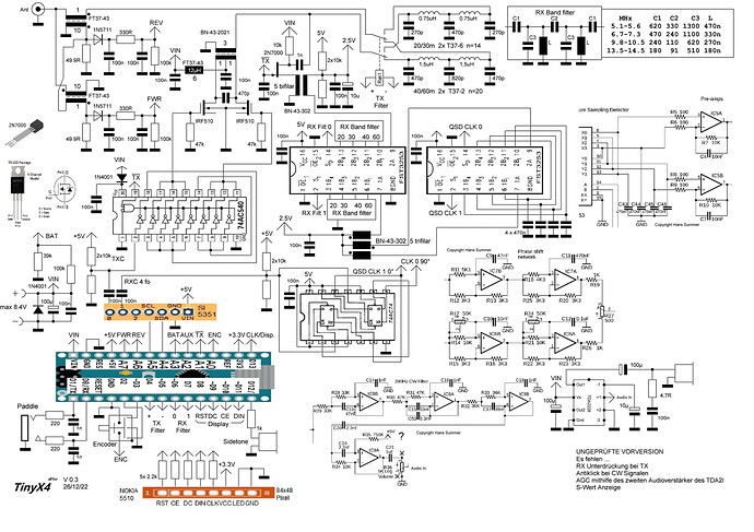

Circuit of a 4 band cw trx
Software of a 4 band cw trx in german

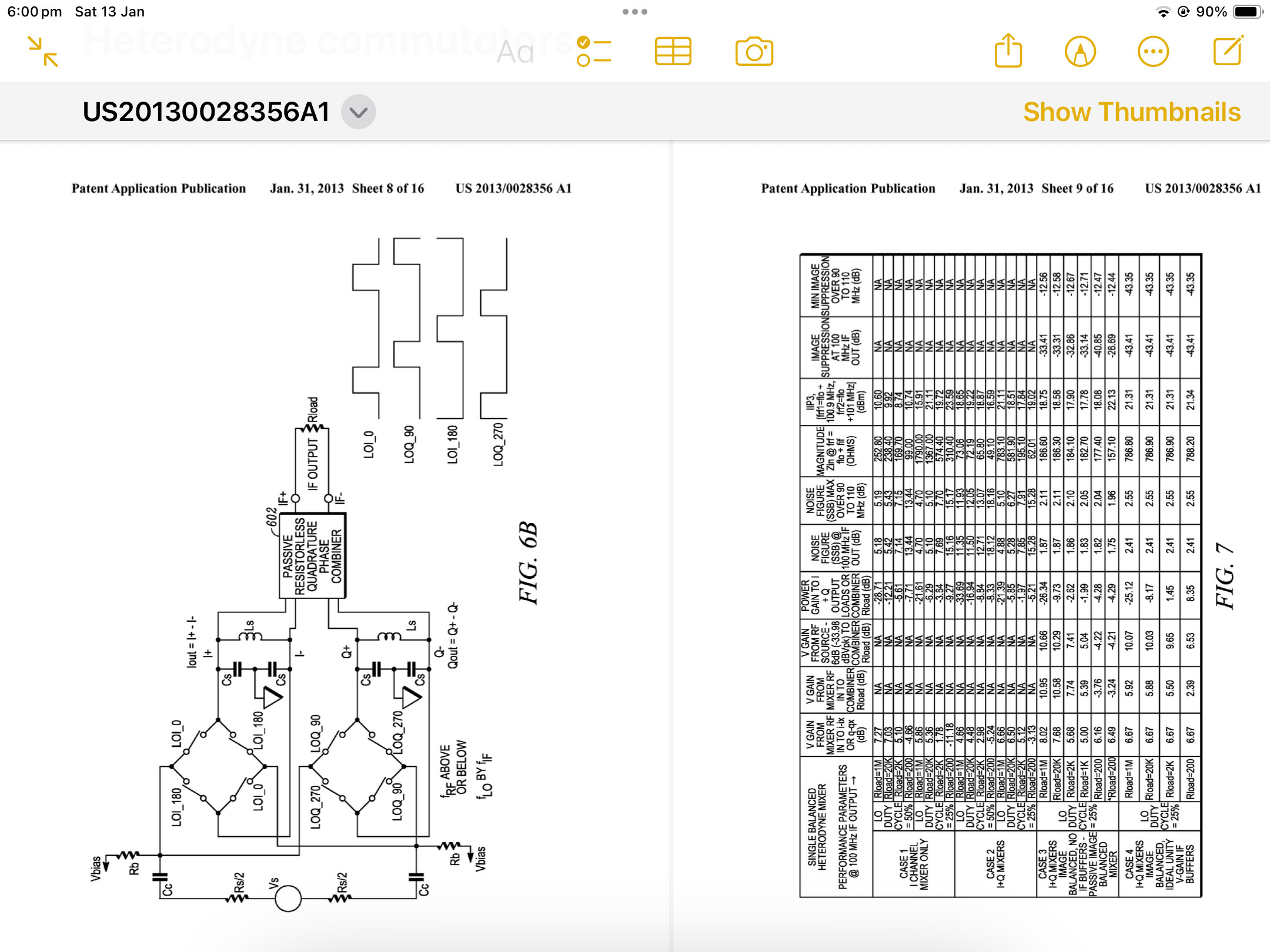

We all own to Motorola by the publication of their Tayloe QSD. Recently in 2013, they have done it again with another US patent that might change the way we brew https://patentimages.storage.googleapis.com/d9/5d/e2/68925bc2d4e55e/US8428544.pdf
Which is literally used a QSD as an Heterodyne mixer, meaning an up or down conversion with two Tayloe QSD in cascade, that solves the high gain audio amp saga of the DCR and superheterodyne without complicated circuits and in case of upconversion, a unique LPF can replace a whole myriad of band pass filters.
The performance of the heterodyne commutative mixer is very impressive.

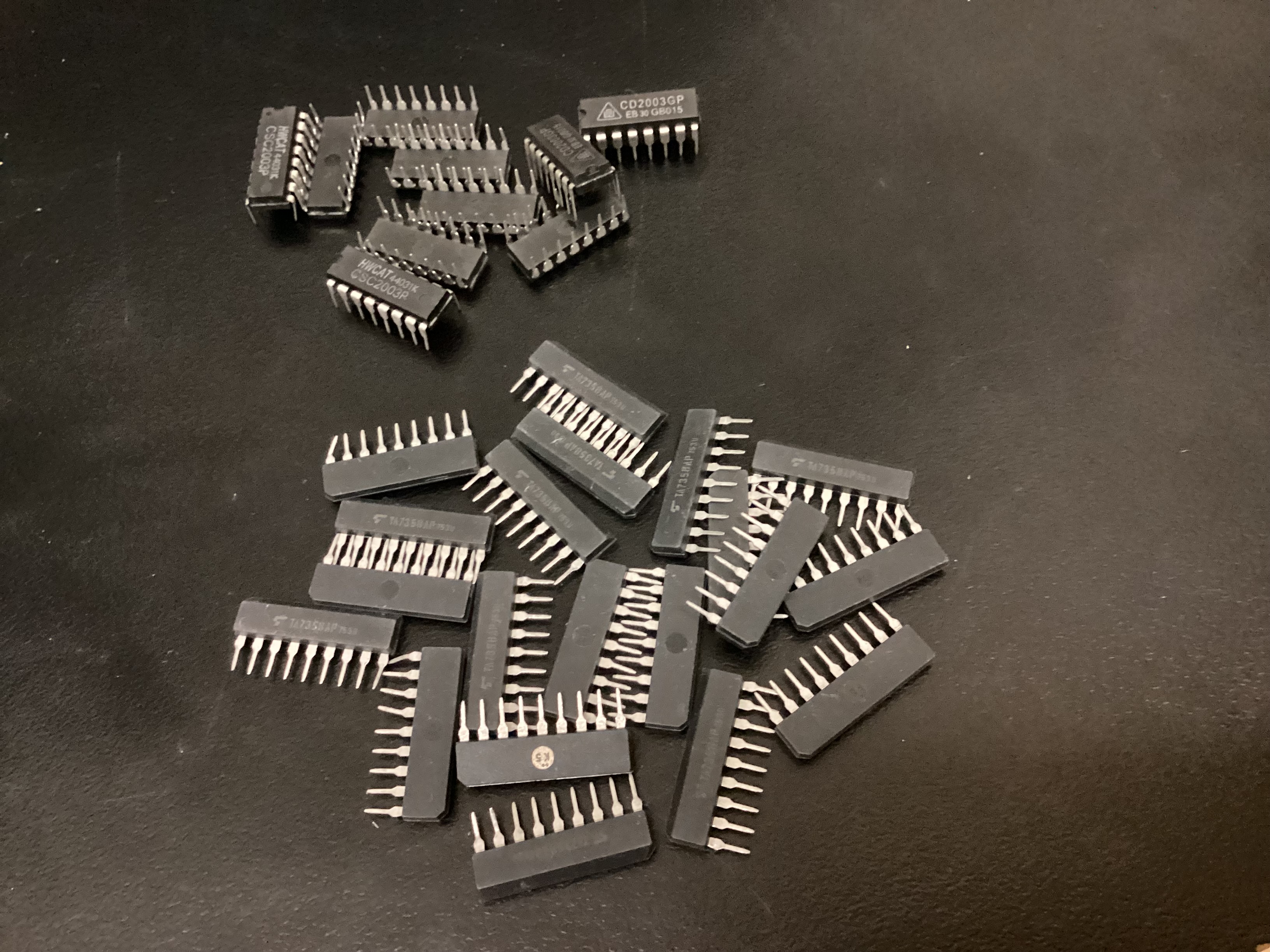

They cost less than a fancy cappuccino, I don’t worry about fake products, able to claim refund if shipped products not matched with advertised photos.
The CD2003 is rarely fake as they have billions in China, TA7358 needs to be cautious, I select products having photos with beveled corner chip at pin 1 and beveled front face, reject any offers with engraved laser.
AD831 mixer board wth SMA connectors, 5AUD delivered, it’s a steal!

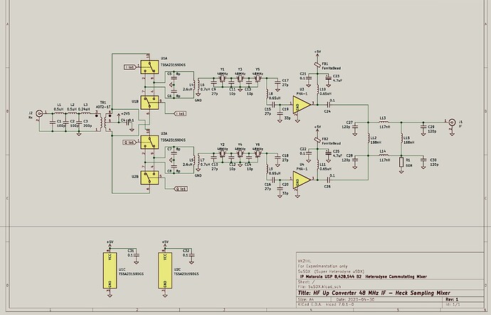

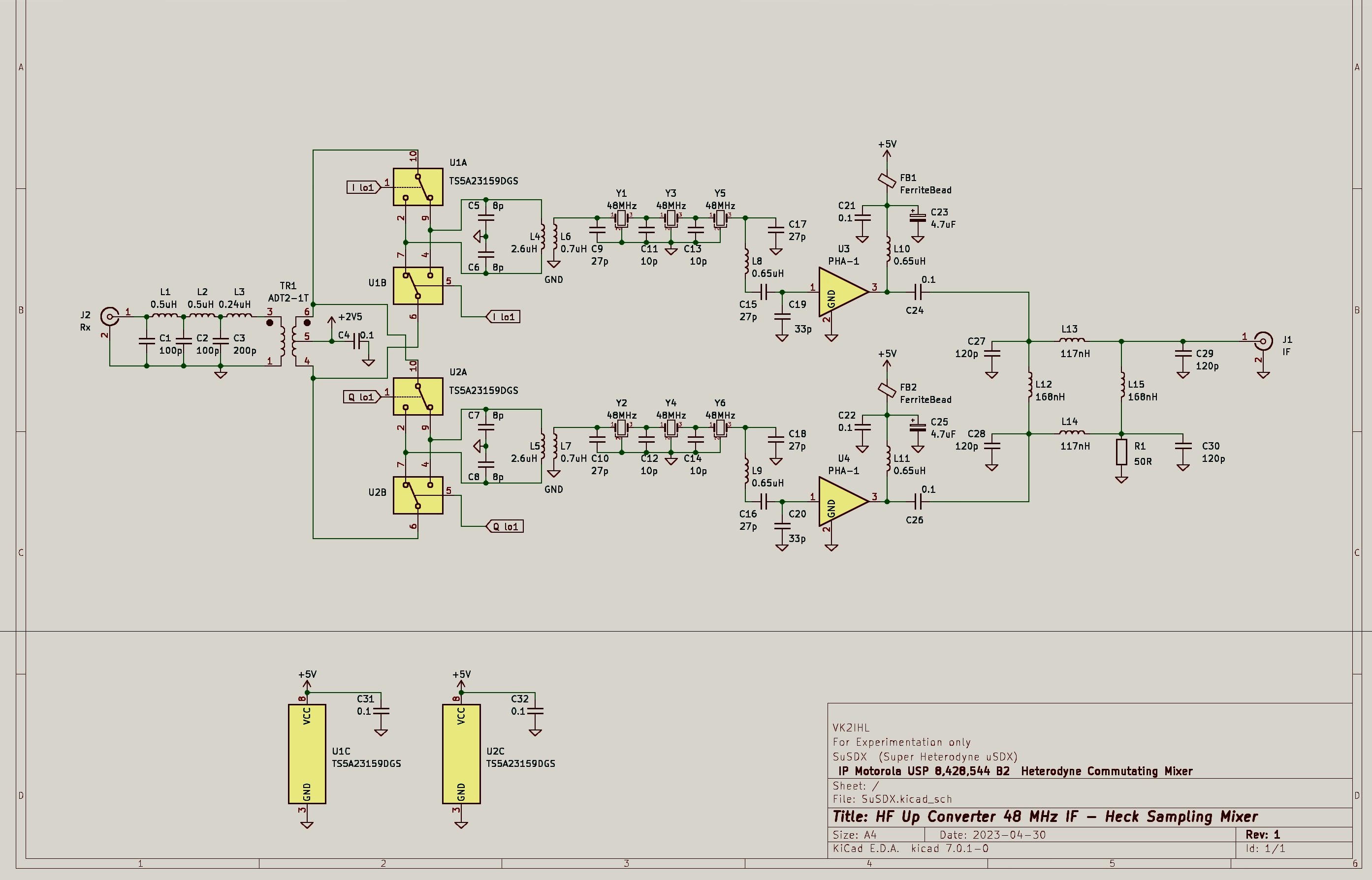

I am working on my Heterodyne Commutating Mixer, I called it a Heck mixer, to heterodyne my uSDX.

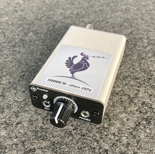

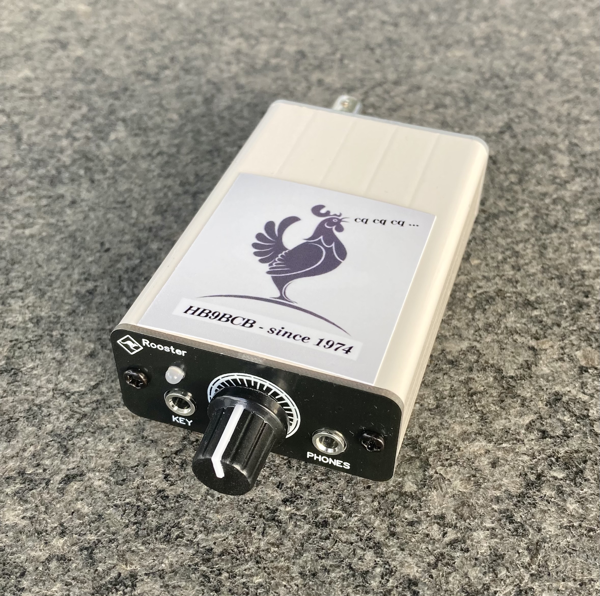

Seems that Kanga had a look at your.baby …“Rooster 40M” https://www.kanga-products.co.uk/ourshop/prod_8079267-Rooster-40m-CW-Transceiver.html

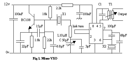

Very simple design, except the VFO is using varicap, that I might replaced with a “Mixer-VXO” http://g4oep.epizy.com/mixervxo/mixervxo.htm?i=1 claimed 50kHz pulling!

This is new for me, Pascal. What a nice idea, a VFO with tuned crystal and down mixing.
For Spota Two or as an upgrade??? :thinking:
The tiny 40 m Rooster from Kanga has been in operation for 2 months now with 2 watts on my 2x 4.90 m indoor doublet antenna (on the 2nd floor) and has been a lot of fun.
I’m now curious to see what the receiver sounds like on a full-sized portable antenna.
By the way, radio operation with a DC receiver is probably not for everyone and requires some practice.

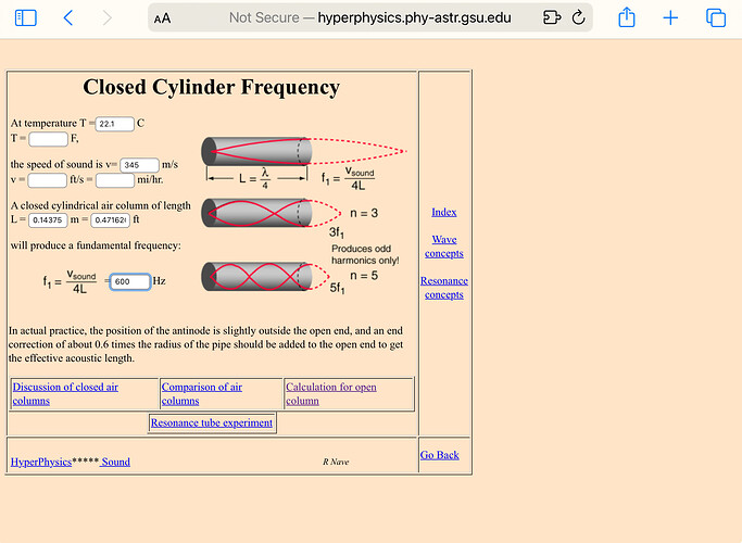

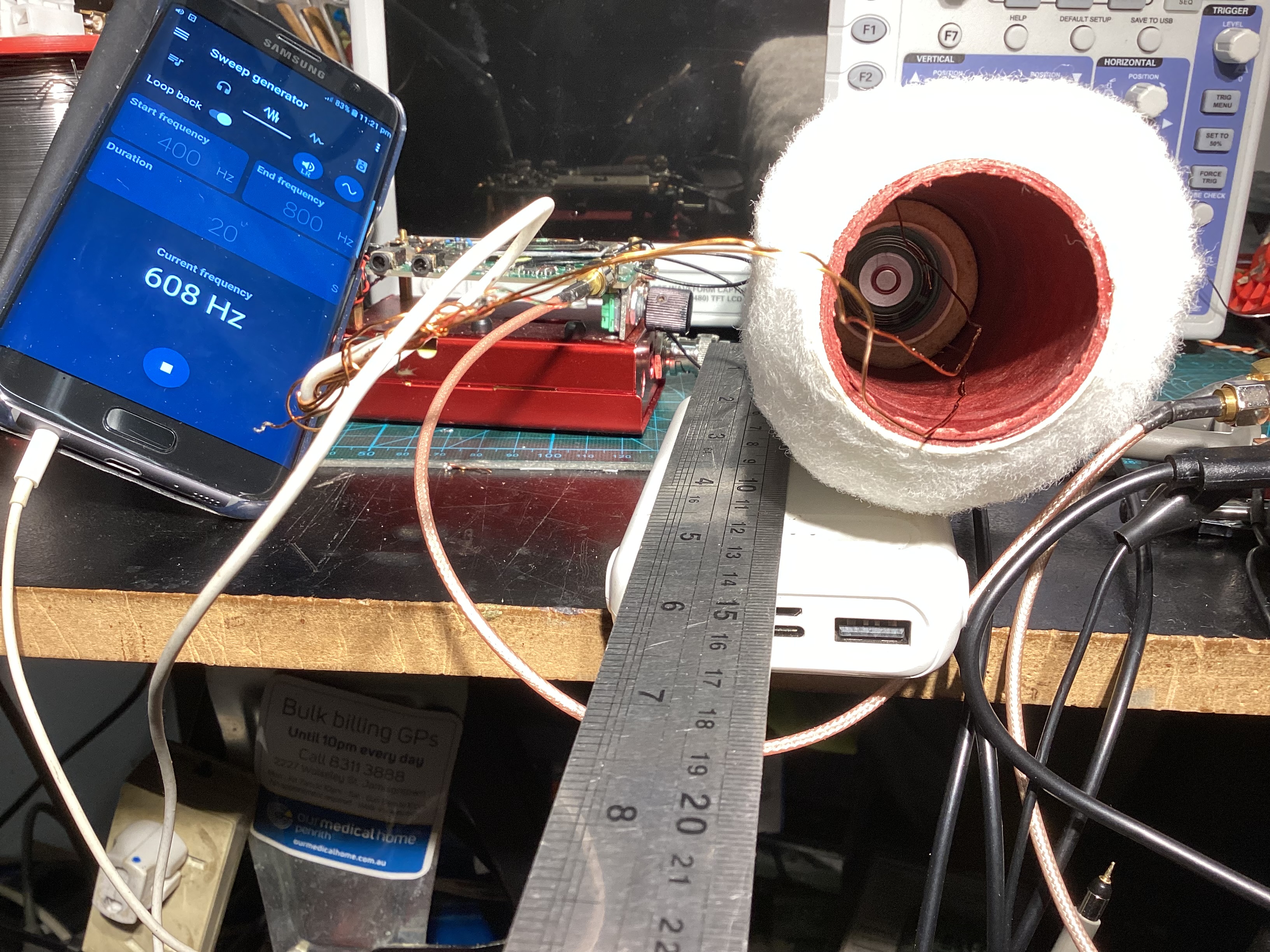

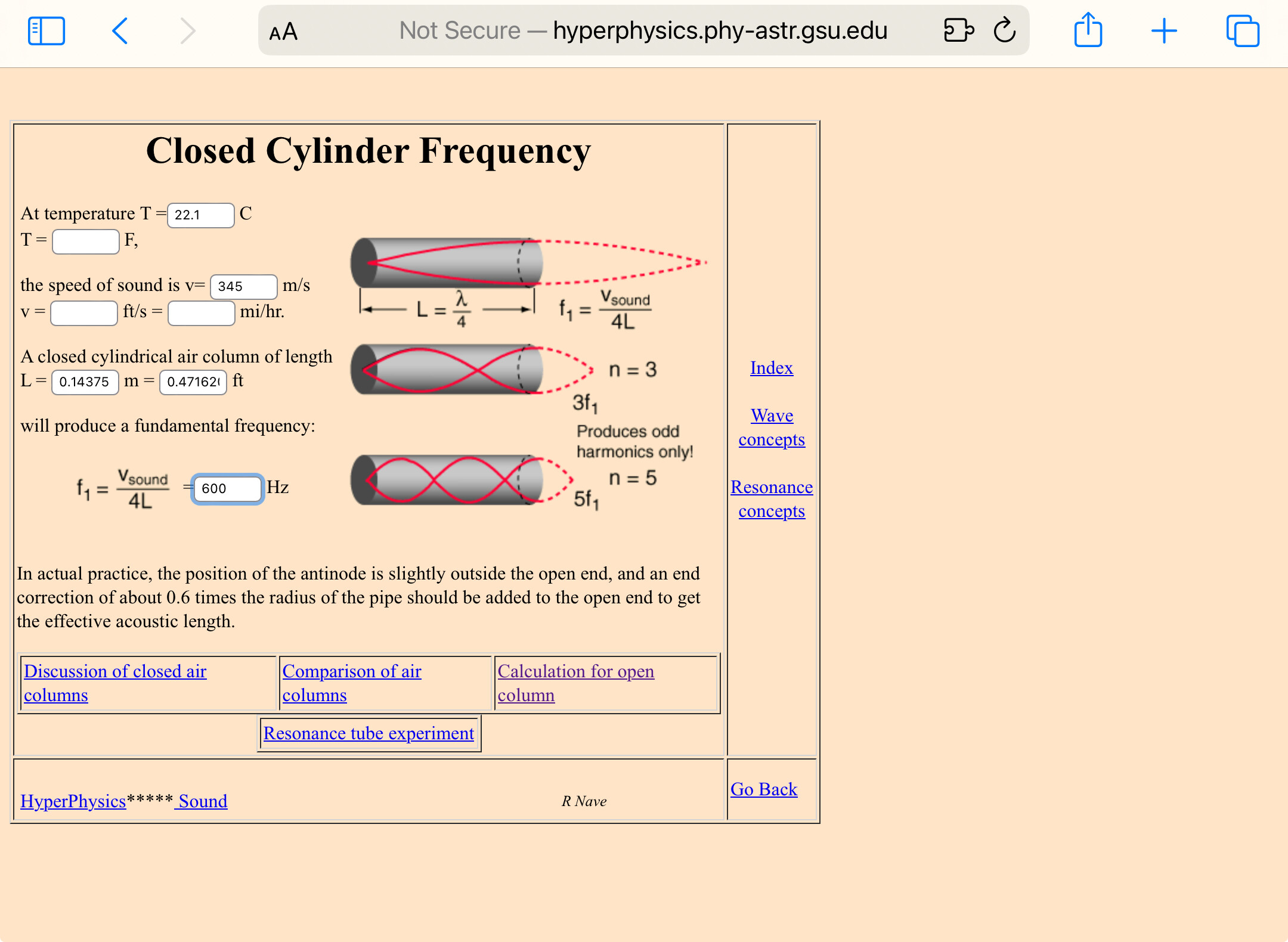

The mother of all 600 Hz filter
I think that your 15x8x3.5cm enclosure will have room for a straight tube which resonates at 600Hz (use an audio sweeper to cut precisely at 600Hz resonance) .

The component list for the Spota One is ready. I come to around 90 euros for all parts, including the housing, Lipo battery, waterproof speaker.
The Spota folder in my Dropbox contains the schematic and the parts list and the DigiSpark script in C.

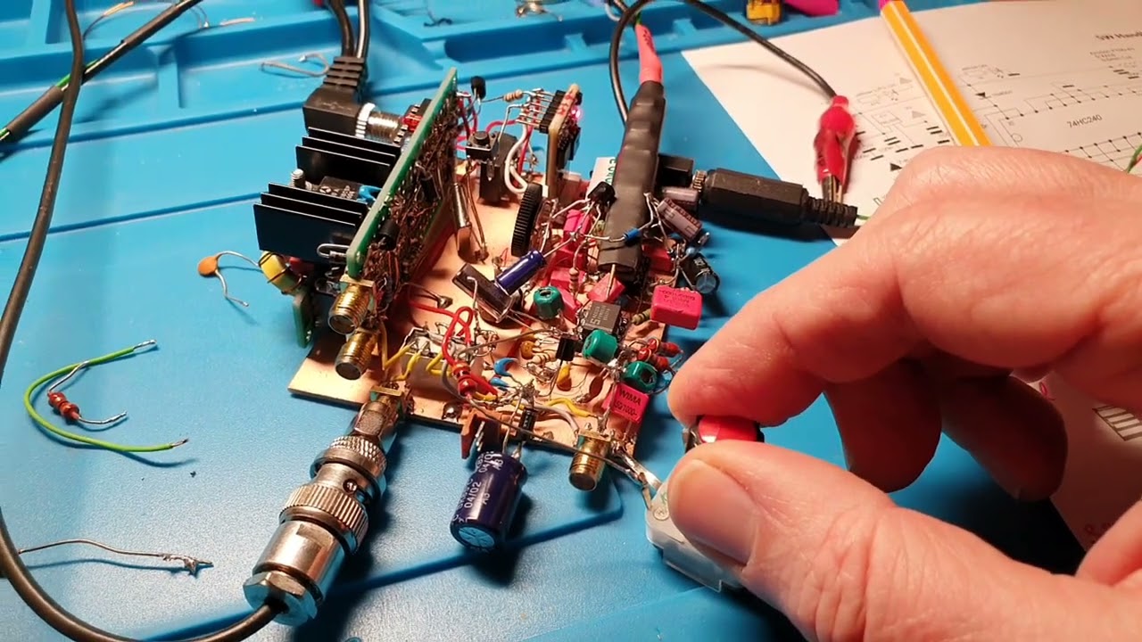

Today I followed your suggestion, Pascal and made the crystal rx frequency variable. The clip below shows the result. Now I have to do this to the tx frequency. I’ll submit the modified circuit later.
By the way, you can now also find the Arduino script with the keyer software in the Dropbox folder below.

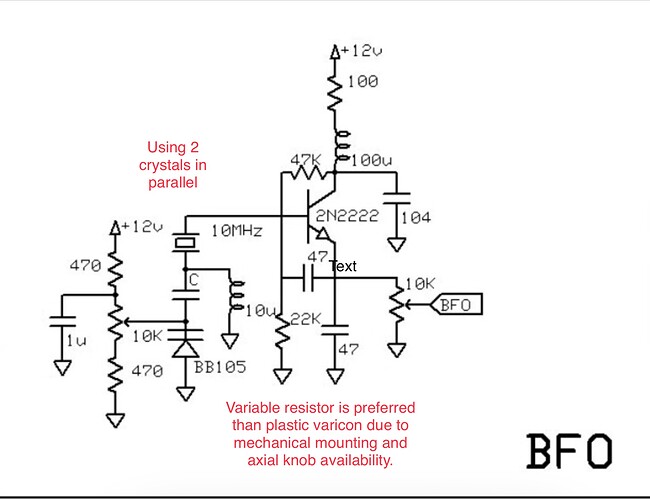

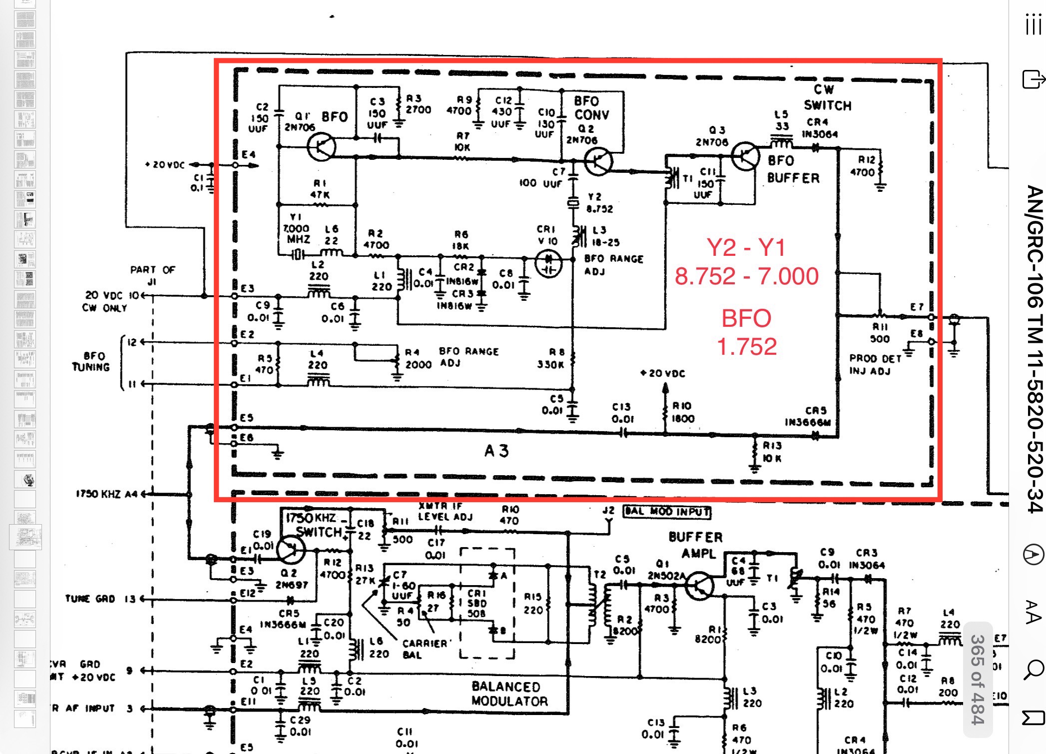

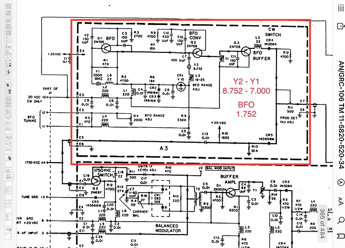

Lot of fun with crystal mixer, back to the 80’s I bought two sets of AN/GRC-106 from the RAF surplus and found this:

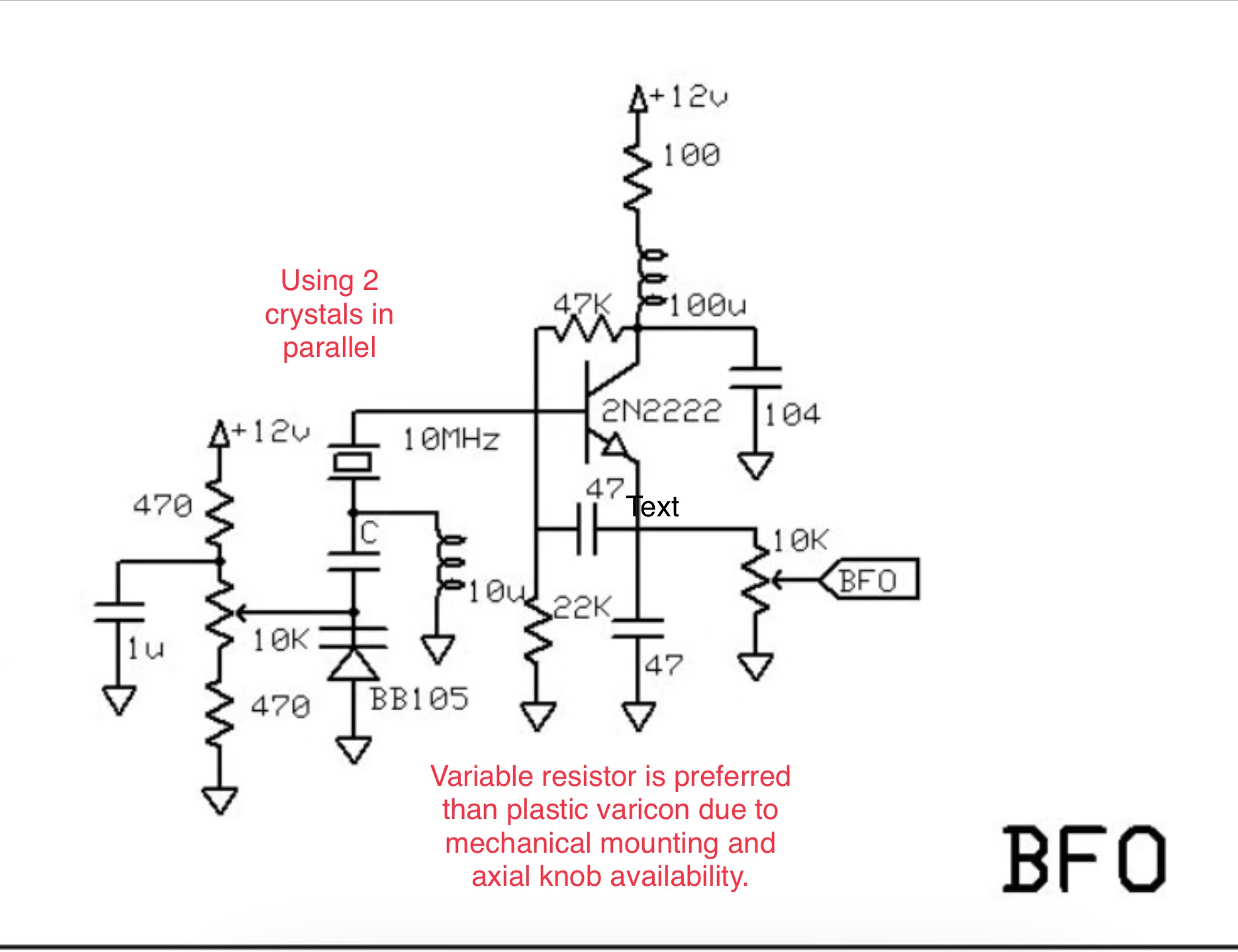

In case you had been infected with bugs from VE2ESE, any high hFE transistors can be substituted for the crystal mixer.
If you do need more than 5kHz from your video clip, put 2 crystals in parallel such as:
Lot of things to learn from VK3HN’ SP series, marvellously published in
https://vk3hn.wordpress.com/summit-prowlers/
Great tip, now it’s delta 11 Khz tuning. I’m also testing variable capacitance diodes.
