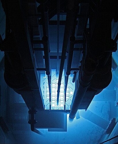

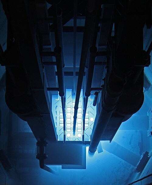

And so as we deal with speed of light, it’s time for someone, me, to introduce Cerenkov Radiation where you get stuff travelling faster than the speed of light giving the cool blue glow seen when radioactive materials are stored under water.
(C) University of Massachusetts
