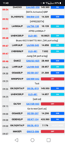

I use SOTA Goat for spotting, and so was wondering is there a way to set the QRT flag (image below), from the comment field? Rather than have to use the button in SOTAwatch?
I have tried the obvious QRT but that doesn’t seem to work.

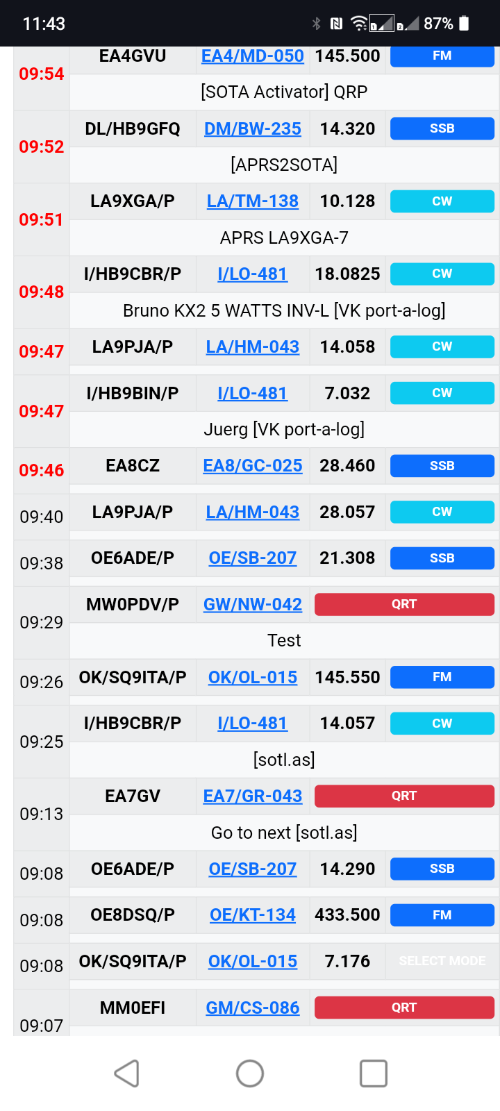

This is SOTAWatch on my Android phone using the default Google browser. I don’t know how it will display in Apple’s browser on an iPhone but it ought to be something similar. It’s also sizable with finger so you can squeeze it a little bit to get everything in the width if you need to.
Stangely, I had to select “use desktop site” in Chrome otherwise it was too small to read (the reverse of what you would expect).
