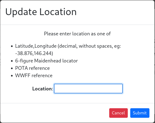

If you enter QSOs manually or via a CSV file, you can specify locations that are not S2S using the Add or Edit Activation screen, using the map icon at the end of the row:
This will pop up another box to enter a variety of options:
And finally on submit, will display a green map icon when there’s location data present.
