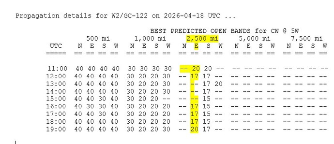

The SOTA Weatherbot hosted by Dave, N7LKL https://sotaweatherbot.wordpress.com/ also includes a summit-specific propagation forecast based on a VOACAP (Voice of America Coverage Analysis Program) model using typical QRP 5 watt CW with ground-mounted vertical transmit antenna.
It looks like 17M will be my best bet looking East on Saturday for trans-Atlantic s2s, likely followed by 15M.
Stay well & 73! Mike, WB2FUV
