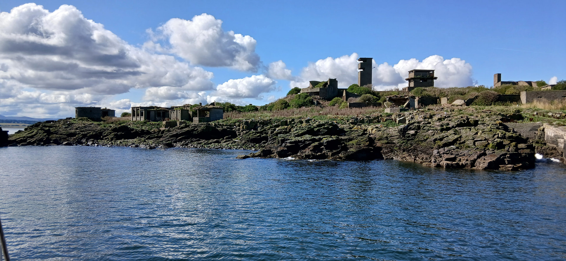

We had damp all around us today whilst chasing sota and pota activating /maritime mobile.
You were about 3/3 today as we listened at Inchmickery island but faded right down into the noise when I went to call you.
MM7MOX/MM
17m SSB 10W Chinese 5.4m Telescopic whip GM/SS-125
