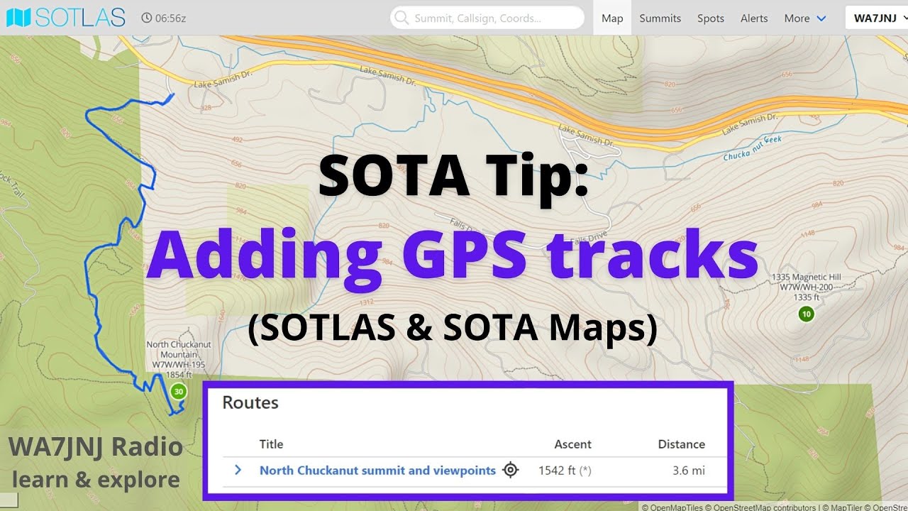

SOTA Tip: Adding GPS Tracks to SOTA Mapping & SOTLAS...
After researching a summit with multiple approaches, it was very helpful to one day see the “blue line” for GPS tracks in SOTLAS (sotl.as). I’ve seen GPS tracks in various websites, blogs, etc… but loading tracks to SOTA Mapping Project (SMP) is a great way to have all in one place…and visible in SOTLAS. (Please see the help link within the various SOTA Mapping tabs for additional information)
If you activate a summit without GPS tracks uploaded, thank you for taking a few minutes to upload and share with other activators. Thank you, and 73. James WA7JNJ
