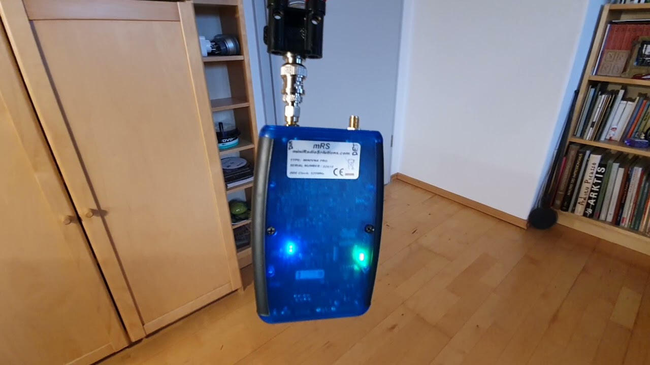

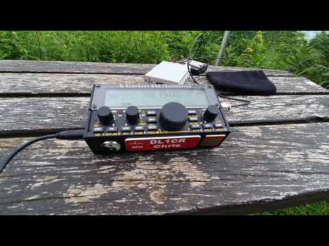

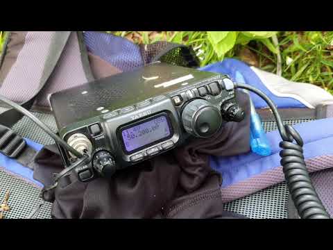

This a quick and dirty way to build a well tested and very small pack 6m antenna. Sorry, only in german:
