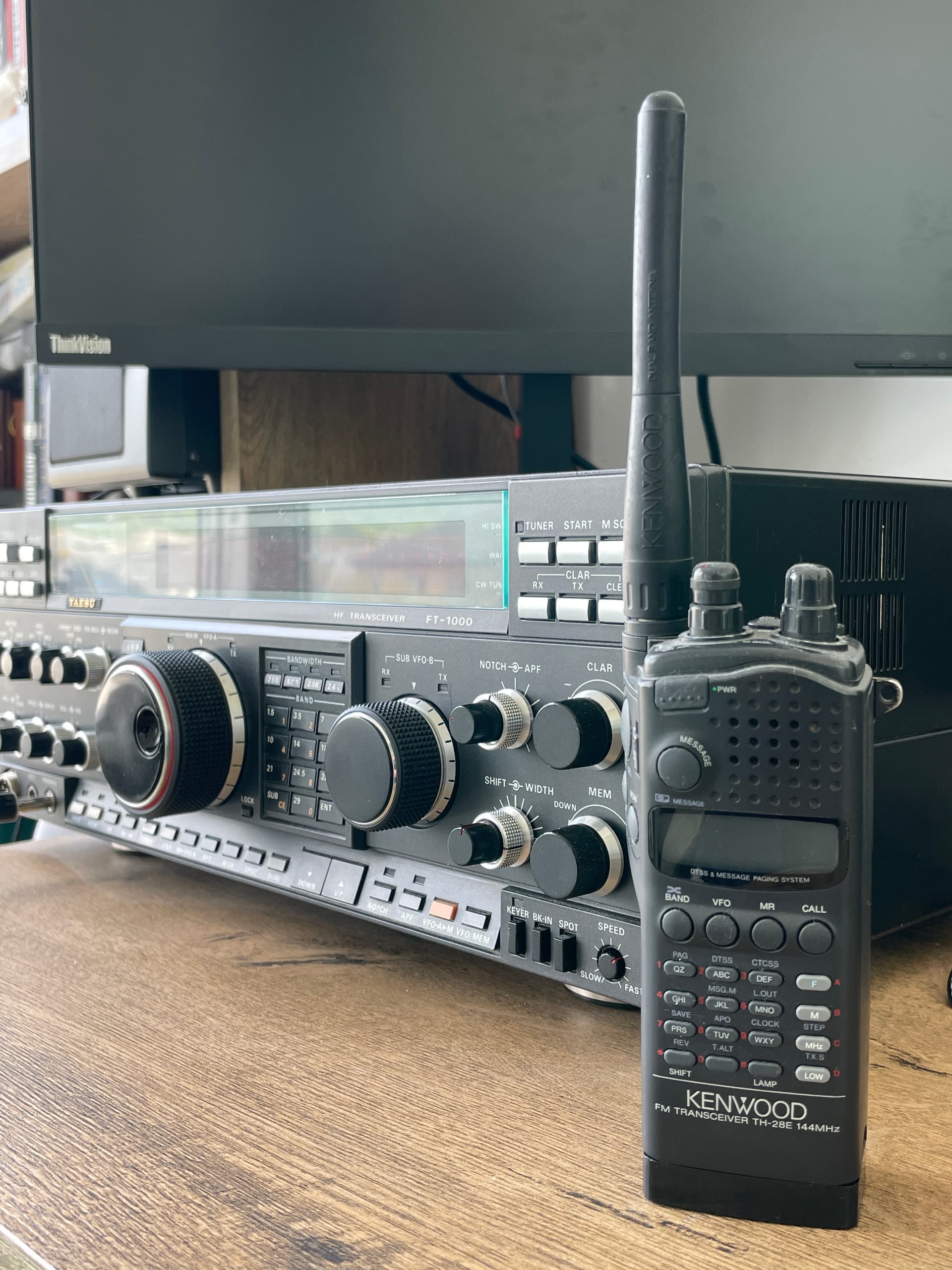

That is what I have, Kenwood TH-28 is what I had my SOTA activity started with few years back. Now proudly sitting on a shelf, but still works as new and can be taken out in a Field when desired! The main beauty of it is that it can run as low as 20mW. On the background is my main FT-1000 HF rig.
While not exactly “old” for most of us, being over 30 years old those two perhaps qualifies to be at least named :slight_smile:
