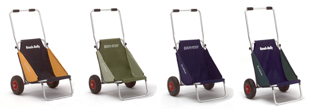

Christophe, thank you for those links. This one looks very promising. It is smaller and made of aluminum (I think), so it should be much lighter than the game hauler that I found.
The cost would be greater (double+?), but I would be more concerned about those pneumatic tires. Himalayan blackberry “weeds” are everywhere in this area, and have wicked thorns. It would be perfect with semi-pneumatic replacement tires made of hard rubber. 73

There are also golf bag carriers and golf bags with wheels - good for narrower tracks. What about a shopping trolly of the two wheel kind or a wheel barrow?
We have a gas cylinder trolley at work and it has similar tyres to those in the picture but they are a sort of foam filled inner so no punctures. They do look a did small for certain terrain I presume.
