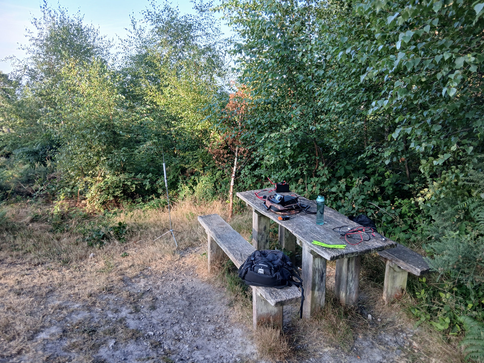

Leith Hill, G/SE-002 is the closest summit to me, roughly a 30 minute drive away. It’s a well-known local beauty spot, and as such can get very busy, especially during weekends and school holidays. It has become a tradition for me to undertake an early morning activation once a year during the summer months before the summit gets busy.

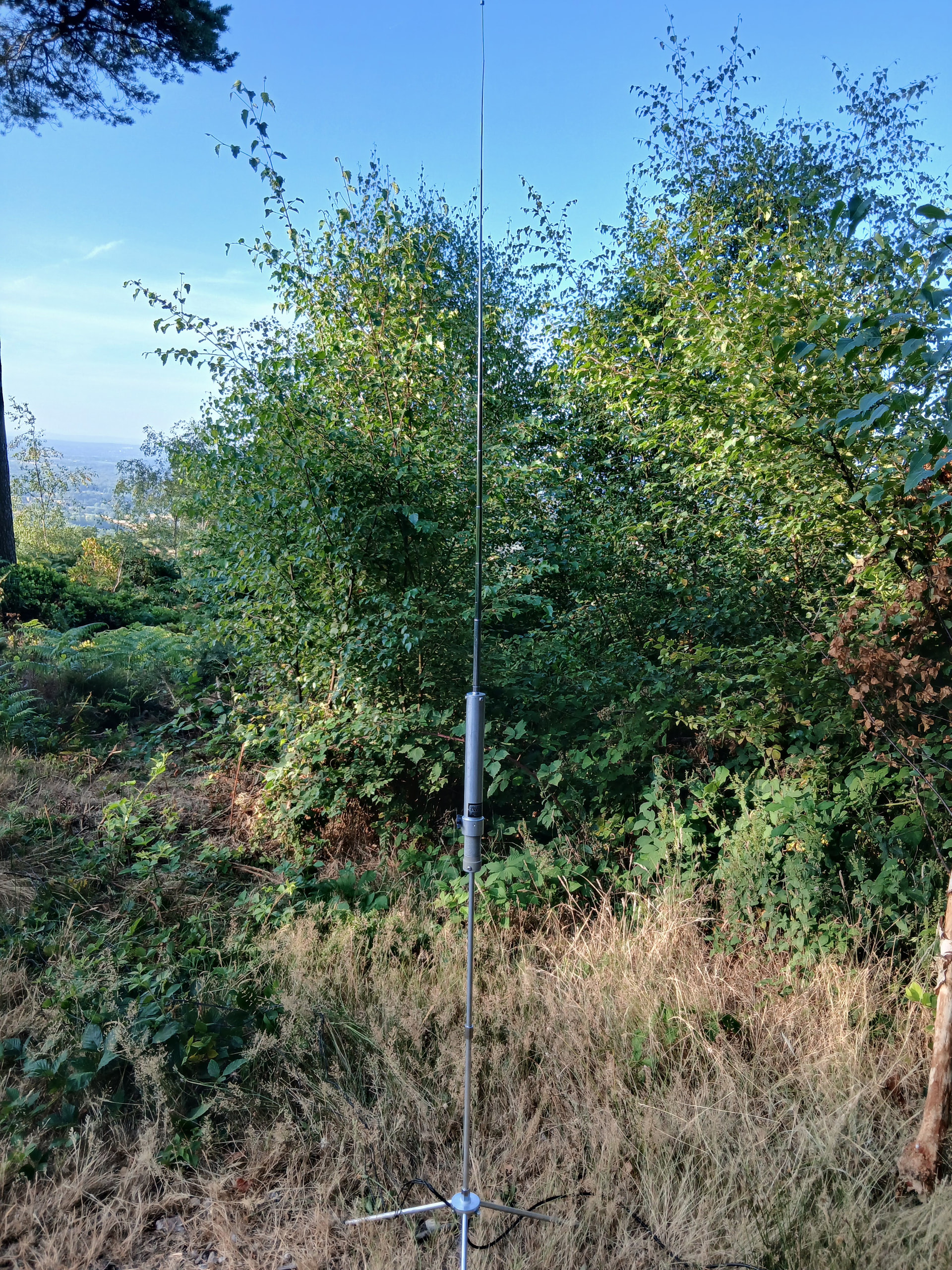

I usually bring along the Super Antenna MP1 vertical for this activation. Not the most efficient antenna of course, but it is something I can set up easily whilst keeping away from the footpaths, and it always seems to work well enough for me to get the activator point.
For this year’s edition I arrived just after 5.30z (6.30 local time) and decided to try some cw on 20m. I had noticed from the spots that Ian, @vk5cz was also activating on 20m, so had a quick listen on his spotted frequency. Possibly something there, but couldn’t really make anything out, so started calling cq on the key. I had brought my ICOM-7100 along and decided to crank up the power to 60W. Just in case!
