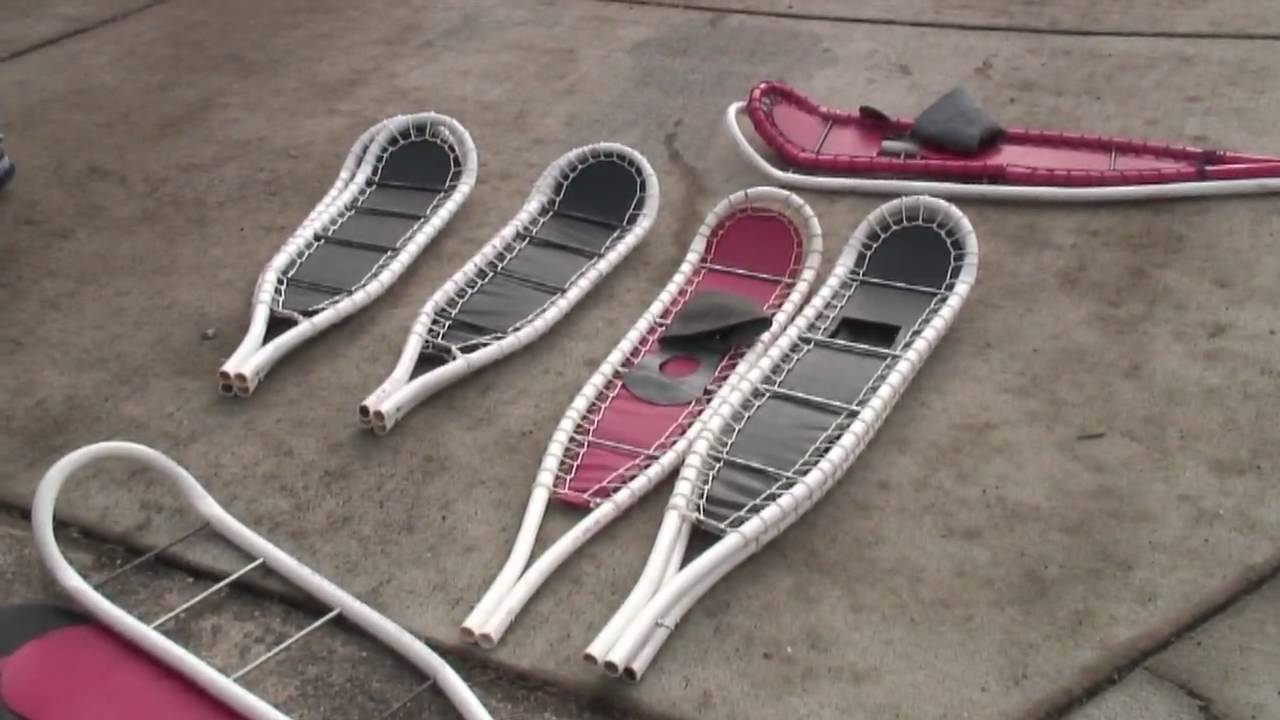

You could always DIY.
Not difficult to make!

I’m picturing dustbin lids and gaffer tape. Probably no less elegant than my normal walking style :smile:

Don’t forget, snowshoes have been around much longer than Mr Decathlon!
