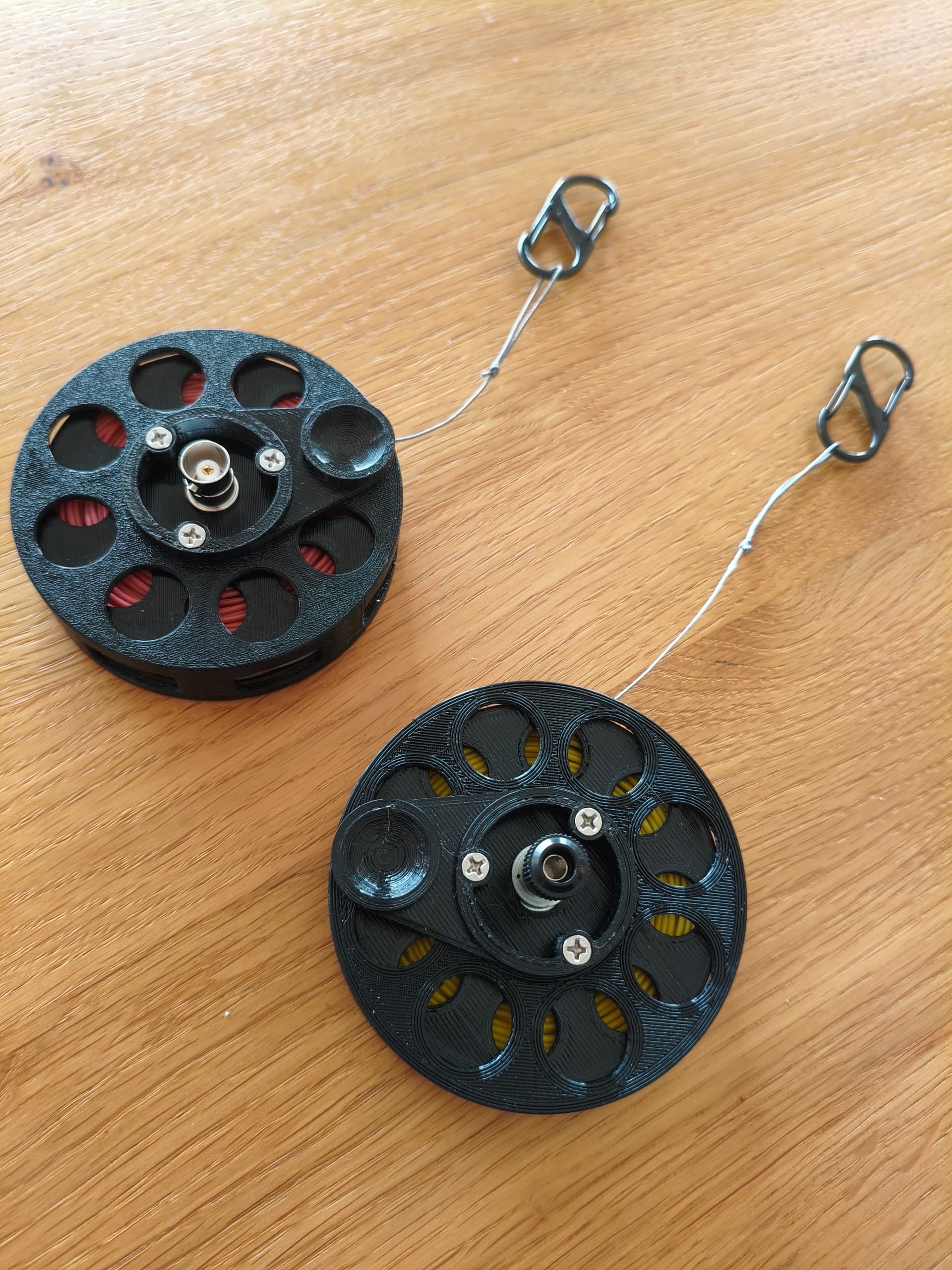

For portable operations, it’s great to have an antenna that is pretty efficient; small and light to carry; and fast to deploy and take down.

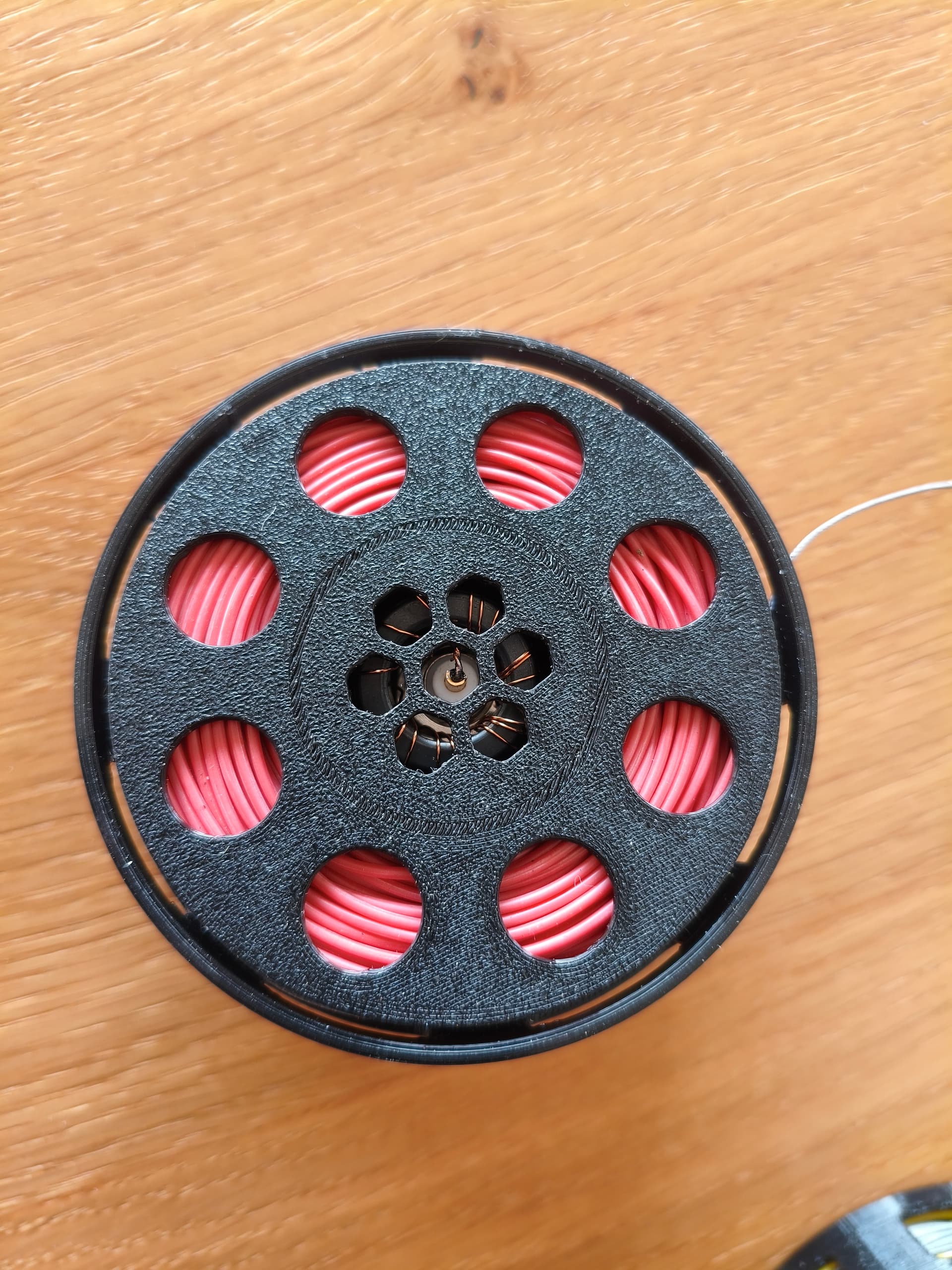

For me, that’s an EFRW of between 21+m and 6.5m, with a small L-match. Recently I came across a neat design by Denis K0TX (digirig). It’s a small spool (diameter 8cm), with the option of putting a transformer into the spool. He sells it as a 10m long EFHW.
I put together two of these. One is simply a 21+m wire for hooking up directly to the L-match; the other has a 9:1 transformer, and uses 5m RG316 as CP. Fits on the small spool if you use 28 wire. Both are quick to deploy and, more important perhaps, very quick to roll in. An benefit of this design is that you can adjust the length continuously, down to using it as a 6.5m vertical on a pole, by blocking the spool putting a hook through the holes (works well down to 30m with the L-match). 100g all in.
The files for printing the spools are at Digitenna on Printables.

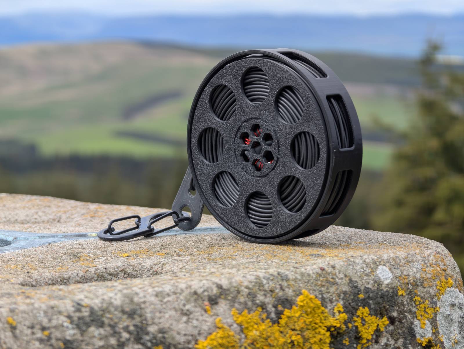

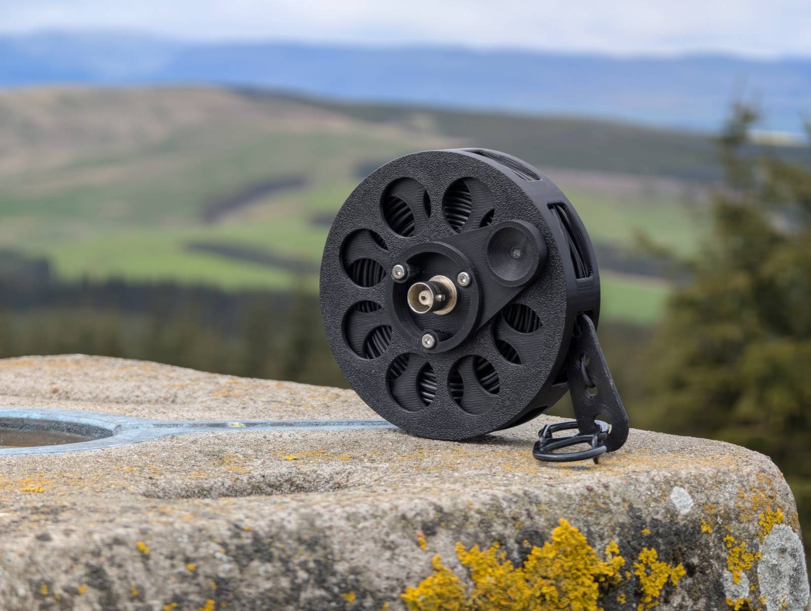

I recently built this antenna and it is now my go too antenna for portable activation’s because I’ve struggled with stowing other reel designs in the past when activating SOTA summits because of cold hands. This design makes stowing simple and easy, even while wearing gloves.
  • It’s fast to deploy
  • It’s very easy to stow
  • It’s small and compact

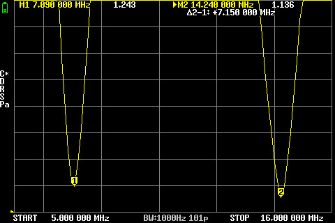

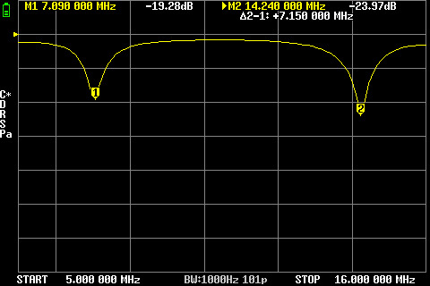

I built mine following the guidence from the Printables page and build video, using 20m of antenna wire and tested a good return loss of -19db at 7.09Mhz and -24db at 14.240mhz.
I was happy with the results achieving a very good match at 7mhz and 14mhz and a very acceptable SWR reading on both, when deployed as a inverted-v at 6m in height.
