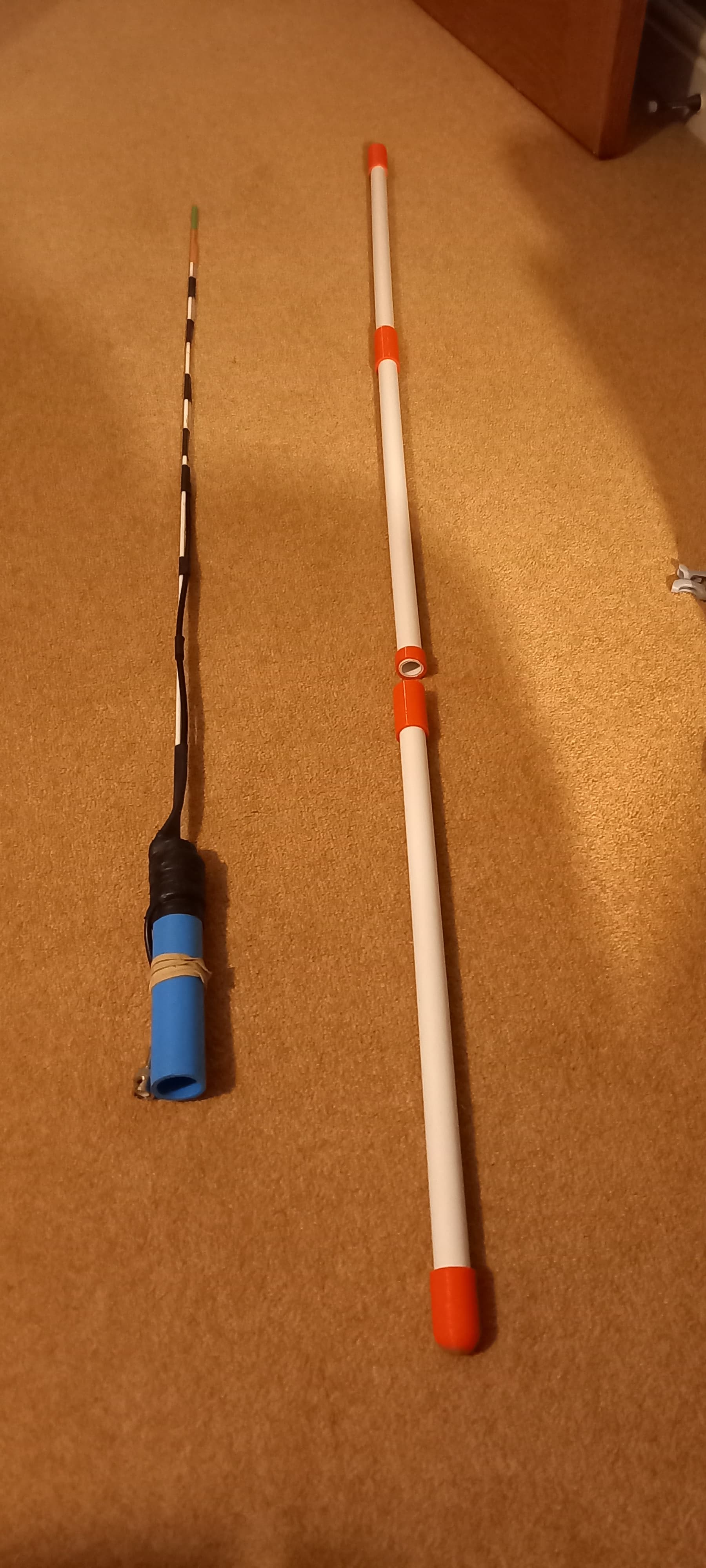

I thought I’d share this, its my 2m flowerpot that Andrew, @G4VFL gave me a few years ago. It is extremely robust and has been smashed around Lakeland fells without breaking. a 40mph+ wind managed to break the short mast coupler that stopped my Robinson (G/LD-021) activation yesterday.
The mast is just 20mm conduit cut to fit into the rucksack and some 3d printed couplers. I guess I’ll print another coupler :slight_smile: . This gets an absolute hammering as well as the ground is almost always rocks and I like to make a small cairn to foot the mast when the weather is particularly “Cumbrian” (which is common)
Cheap, robust and a great performer. Highly recommended for 2m.
Alex
p.s. love the hentenna @OE9HRV, like the man said, very trick
I wonder if it would be worth redesigning the couplers to have a flat cross section on part of the outer surface, printed lying on the flat side, with supports in the central hole.
If printed as above, the filament lines would run axially, preventing a reducing likelihood of the type you have seen.

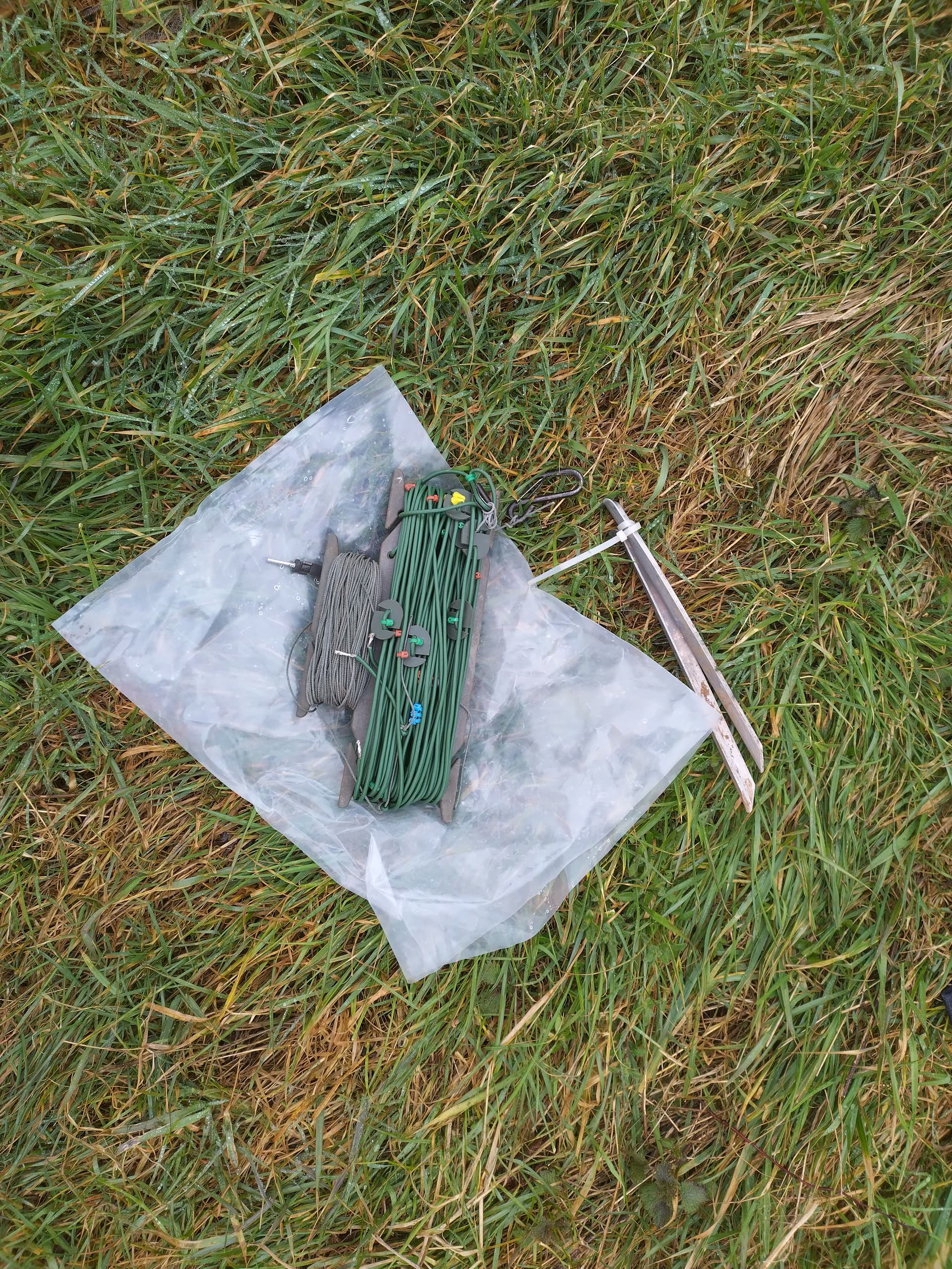

My current favourite for hills and woods is my homebrew version of Bushcomm Mil-1 antenna which I generally mount witht eh highest point at 2m or less above ground. Very broadbanded - can use on 160 to 6m without a tuner. It comprises a 9:1 unun with 4m wire to ground stake, the other side of the unun goes to 16m wire with 470R load resister and a further 8m wire beyond the resistor. I’ve made it using a mil surplus Racal kevlar reinforced wire element and it’s cost me about £20 all in.
Of course with a load resistor it has some loss, but there again mounting low to the ground introduces bigger losses! But the big advantage is set up takes 1 minute, I don’t need a tuner, and I don’t need to make adjustments to the antenna when changing bands. Frequency agility and quick set up is was I like as I only get very short sessions in.
Today, on an impromptu set up at Ditchling Beacon G/SE-006 in dense fog and rain I managed to log 9 great contacts in an hour in response to my CQs on 15m. The closest was just 21km away and the furthest was 6500km; not bad for 5W CW. I still got back to the car quick enough to go and pick my wife up from work at the hospital!

Normally Matthew its been fine. Some of the gusts were approaching 45-50mph so I’d expect it to have a bad day at that kind of loading. It is very weak in that plane in comparison. I could splash out and use proper couplers but I didn’t have any and orange ones are much nicer :slight_smile:

Dear Alex,
I could not agree more and as said earlier in this thread, I like the design, too. I appreciate your efforts to make it bulletproof and thight against all adverse effects like rain and wind. However, what I also like about the flowerpot antenna is, that it can be rolled up and transported easily. I use a 7 m fishing pole and simply stick it through the coil. The pole is made of fiberglass and it has actually no effect on the resonance frequency. As you can see from the photos below, the antenna top is fixed to the mast tip by means of a bit of fishing line and shrink tube. [Discard my red “wind indicator”, this has no function in the antenna design. :smiley:]
I have used the antenna in gusty winds (~7 Bft.) and nothing broke. If the antenna gets damaged due to the impact of UV light or anything else over time, a new one can be built within an hour.
Vy 73 de Peter, DO4TE
That’s pretty clever! Nice work.
Neat idea Peter. Really clever space saver. I’ve given mine a very hard time and I’m not sure how much longer it will last. :grin:
Hi Alex,
Well, not my idea, the “portable” version is already described in the original publication. https://vk1nam.wordpress.com/2018/02/10/portable-2m-144-mhz-coaxial-dipole-antenna/ I just added my two cents by concluding that a flexible wire and bending fishing pole would be better in strong wind than a ridgid plastic pipe that provides more surface area for attack. Not really a big deal. :slightly_smiling_face:
Anyhow, good is, whatever suits your needs and this is what counts. I am relatively new to 3D printing, using predominantly PLA as filament. This seems to be pretty “hard”. Maybe, PA or something “softer” might be a better choice for the connectors. Just another thought that came into my mind when I read your report. Good luck with your repair job and many more successful activations with your flowerpot antenna!
