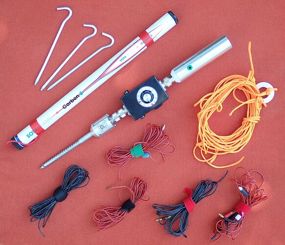

I’ve received some questions by e-mail regarding the dimension and parts of my antenna.
I’m going to answer it here, so that the information is available for everybody, who’s interested in.
The radiator is 6m long (40 and 30m), with a link at 4,20m for 20m. It is fixed to a Carbon 6 pole.
The four radials are each 5m long.
For the variable inductance I used a T157-2 core with roundabout 40 windings (approx.16µH).
You can turn it stepwise (windingwise), till you reach loudest receive noise and when SWR is still >2 one click cw/ccw will fix it.
See picture.
I have a base for the antenna with a wood screw. That suits my need to built it up in most cases.
On windy summits I can add the guylines with pegs or fixed to stones.
If I what to fix the antenna to a flat table or bench I use the tripod base with a belt.
See picture.
If you have any questions, let me know.
