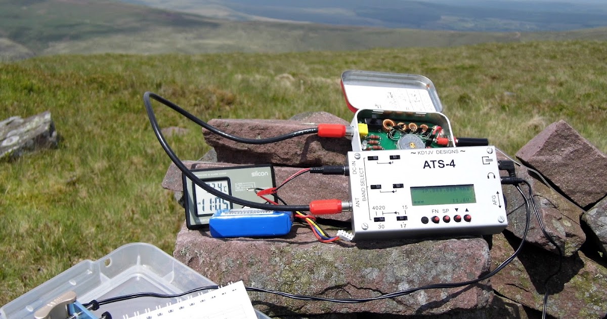

Generally speaking I’m always using the same gear.
ATS4 or MTR and EFHW with 3-4 watts OP depending on state of battery.
I normally work about an average of 50 stations with that, (sometimes triple, sometimes half) but as I prefer nowadays to attempt multi-summit activations, I can’t spare the time for anymore anyway!
Pete
