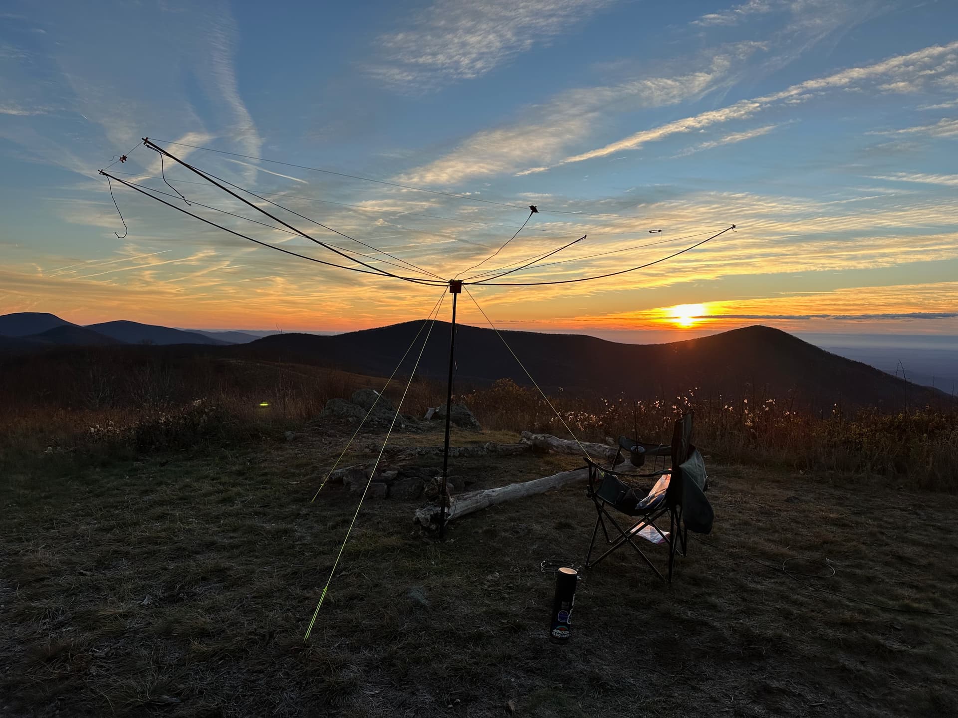

I had a couple of configurations set up, but for our QSO, I was running a 66-foot EFHW as an inverted V. I was going into the K6ARK matching unit connected to an Elecraft KX2, running 10 watts.
Additionally, we had a 10-meter moxon set up, but that wasn’t what I was using for our QSO. This is a pretty cool picture of sunrise from the peak.

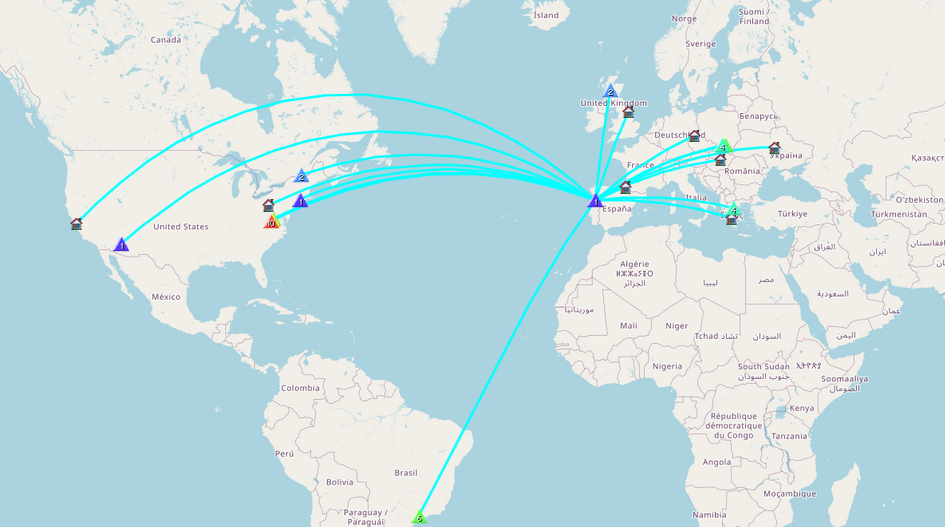

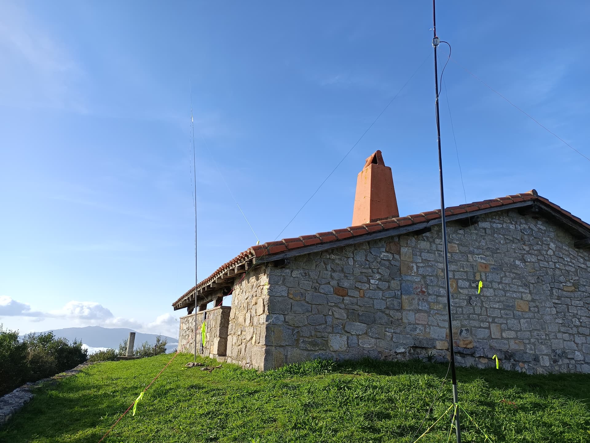

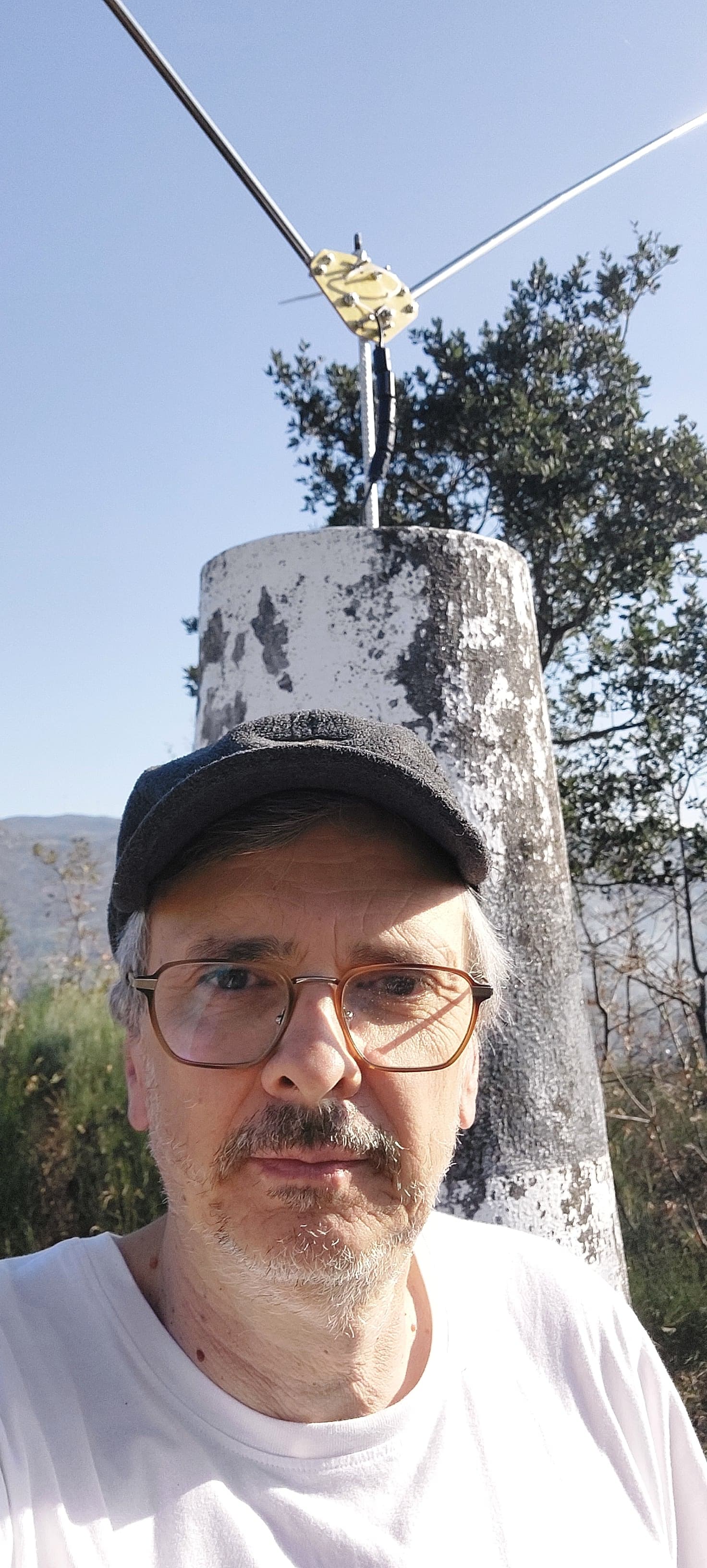

Fun day, this is my report of the “Trans-Atlantic S2S Event 2nd November 2024” from EA2/BI-057.
117 QSOs
10 Trans-Atlantic S2S (10 m)
19 S2S EU
Very nice weather, until late afternoon when fog appeared with same weater.
My working conditions werw 1/4 weave with three elevated radials for 10 m and NorCal doublet for the rest of the bands. I used an FT817 with a small 30 W amplifier.
Many thanks to all chasers and activators.
73 de EA2WX
Marcial

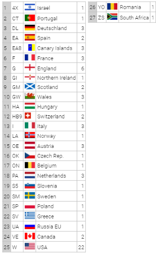

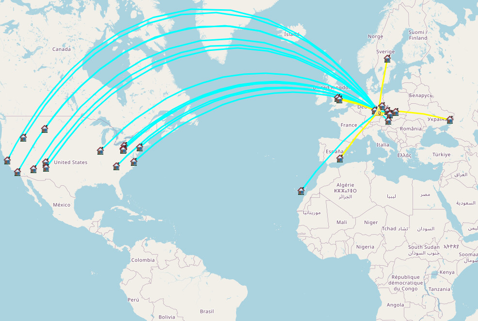

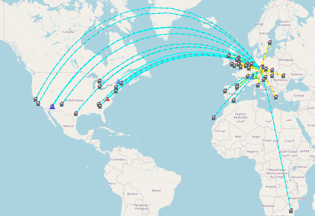

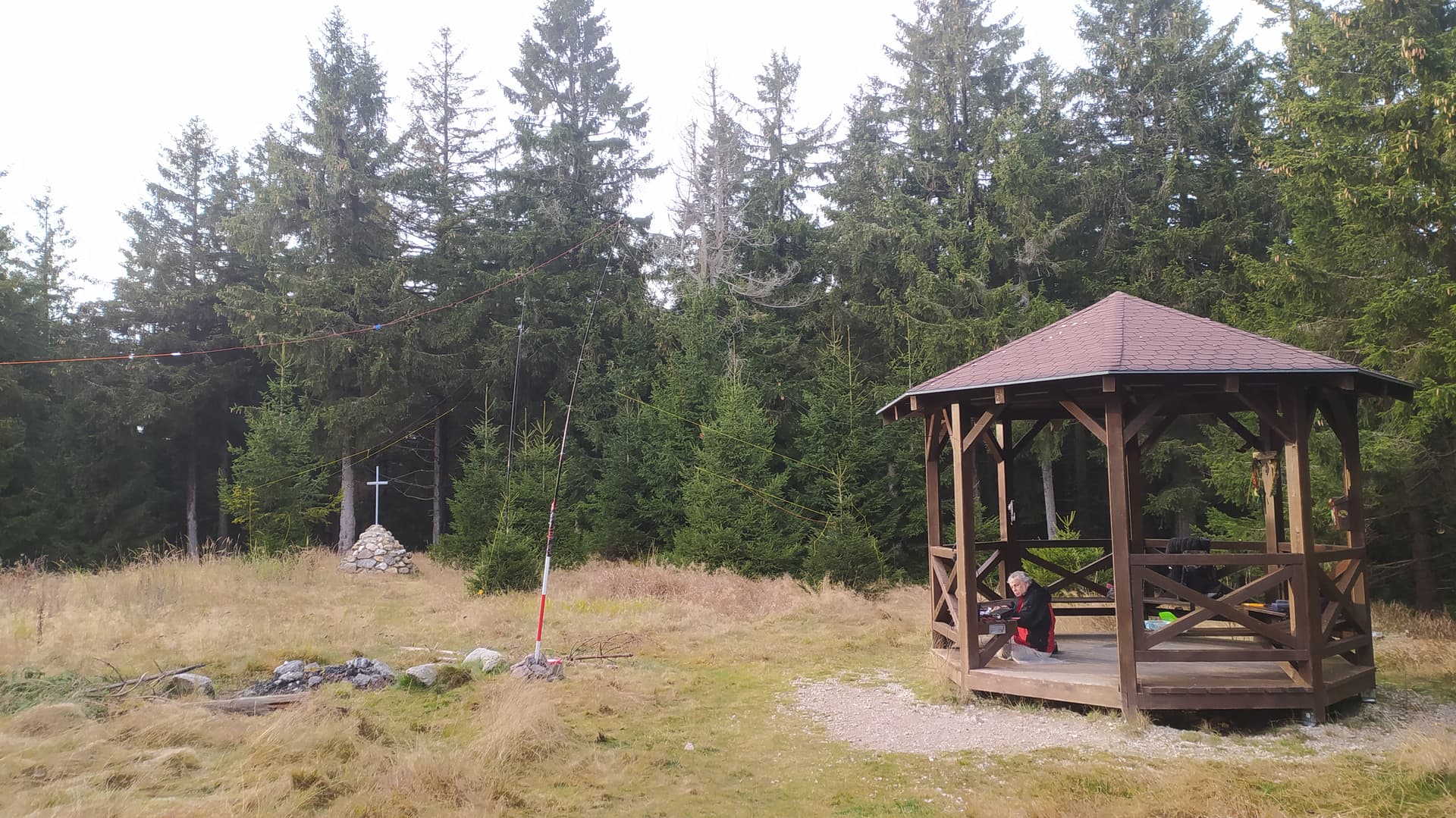

Great afternoon on OK/KA-008. Activation together with Karel OK4DX. Our setup was Yaesu FT-891 with full 100W output power, powered by LiFePo4 24Ah and 10Ah as backup. We had two antennas, both inverted V at about 7m high for 14-21-28MHz. The Weather was foggy and about 4°C, but there was no wind.
Many DX contacts made, most W, but also VE and 1xZS. I remember PY1NP called me, but signal was week and lost in QSB.
As usually Karel OK4DX focused on CW, me on SSB. There are the results:
(statistics from http://tools.adventureradio.de/analyzer/ )
OK1MCS:
Total 8x S2S (4xDX S2S)
OK4DX:
Mni thanks and cu next time!
Pavel

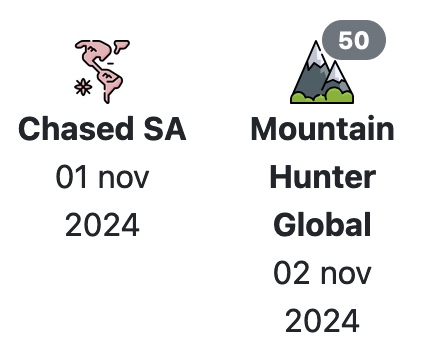

Hi Carlos, thanks to you too for the two S2S, my first with PY.
Two new badges earned in chaser stats for the QSOs of November 1st and 2nd :slight_smile:

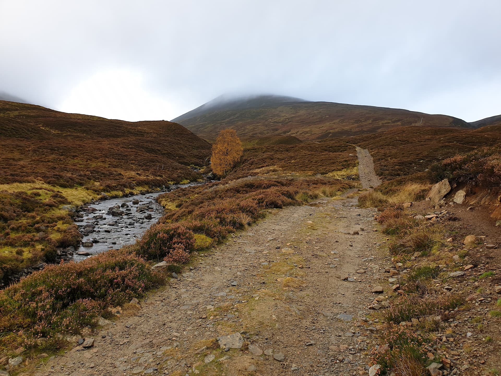

Finally I find a few minutes to do a very quick report on last Saturday’s S2S event from my perspective. For me it started out okay, but the weather got progressively worse the higher I climbed and then worse still as the day progressed.
At this point it looked promising if that cloud base got higher… err, no.

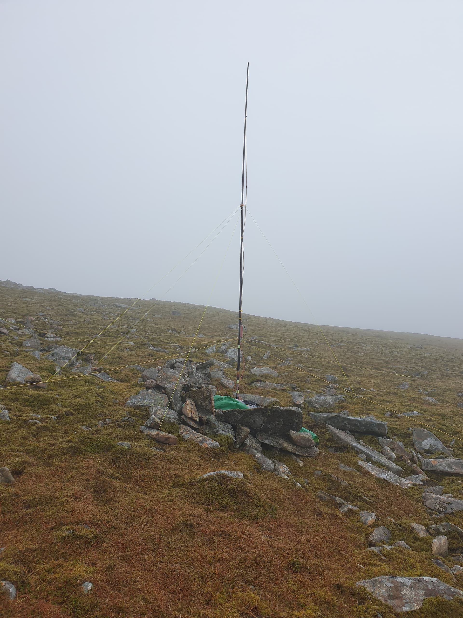

Pole lowered to 5m due to the wind.
I had decided to run a quick 40m SSB session to give the summit an airing for the UK and near EU chasers before getting into the S2S event proper. It was easy to tune the Slidewinder vertical and I worked a total of 11 contacts on the band, 4 of which were S2S.

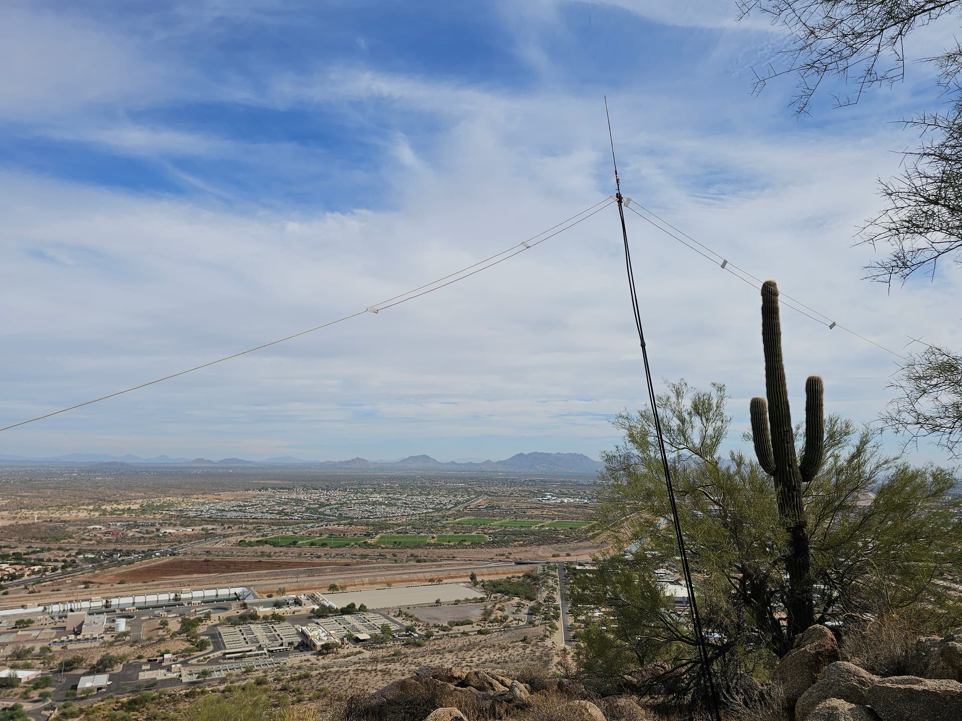

Conditions on 10m were good unfortunately my decision making was not. I was feeling under the weather on the day before the event. As a result, I decided to change my summit for the event. I went for the closer, shorter, easier summit instead of the more distant, longer, steeper and more treacherous summit. As soon as I turned on the radio my mistake became obvious. I had an S7 noise level on the new summit while the other summit usually had a very low noise level. After my first spot it became obvious, I was an alligator, all mouth and no ears. With 30 watts of transmit power and an S7 noise level many stations were coping me, and I was having a very difficult time copying most of them. I did work a few stations with much difficulty, and I want to apologize to the stations calling me that I could not copy. I eventually decided it was best to search and pounce instead of spotting myself. This way I could at least call the stations I could copy. I eventually filtered for only 10m SSB stations as the spots were scrolling by so fast. I was able to complete S2S contacts with HB9EAJ, OE9HRV, KJ7OGF, HB9HCS, EA4IS and OK1MCS.
With the number of European spots disappearing, I switched to 10m FT8/FT4 to work on the 10m challenge. I was using a new 6m/10m fan dipole I had just built for this event. A local told me 6m was open and I was able to copy an EA station on 6m. With 10 watts on six I was unsuccessful. Later I was able to work a VE1 on 6m FT8.
All was not lost but I have marked this summit off my list for working DX.
The new fan dipole for 6m and 10m.
