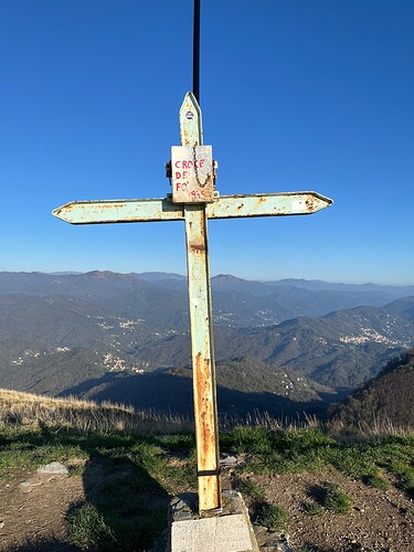

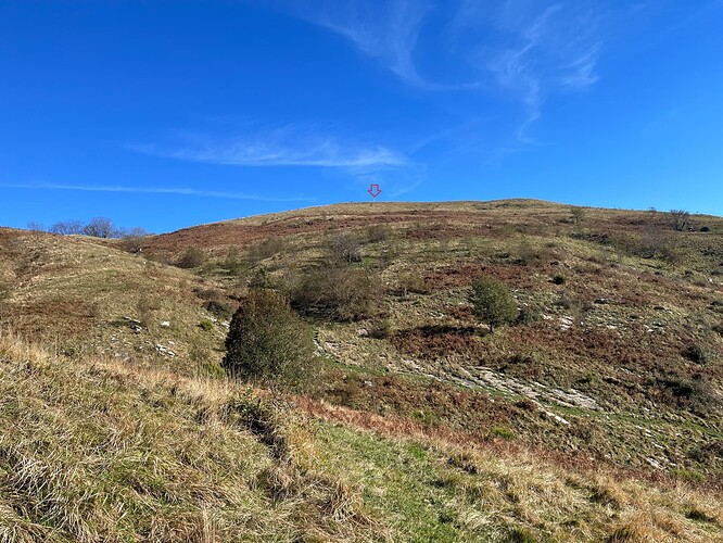

My summit today was I/LG-029, an easy ascent that can be completed in 15-20 minutes from the car park.
Today there were some cows in the footpath, they didn’t seem to care very much about me.
Same for the usual wild horses that inhabit the area, they are not curious and are best left alone.
There’s an iron cross on the summit, it can be spotted from quite a distance
Setting up station was quick, no wind interfering with antenna work: I used a 40m EFHW in an inverted-V configuration, a 7m fiberglass pole to support it in the middle and the walking sticks at the extremes to tension it.
Radio today was a KX2, powered by an external 2Ah LiFePO4 battery, 10W power output.
I started by chasing @VA2NM, @WN3F and @W4GO on 10m, since the band sounded promising I started calling and I got WK2S, @N4EX, @PY1NP, @W4JKC and @N1ZF. Then I moved on 15m for a quick S2S with WB2LJK, back to 10m with @W4AQ and @N4MJ. Another attempt on 15m got another QSO with @N4EX and finally a S2S with @VA2EO on 10m.
At this point I noticed a group of kids sprinting their parents quickly approaching the summit and I decided it was the appropriate time to pack up. 14 QSOs all DX, I couldn’t get any European contacts.
