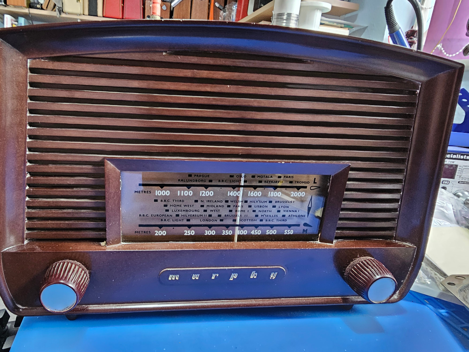

I’m currently listening to Radio 4 on LW on a Murphy UH198 Valve radio. The first Valve radio I’ve had from a BVWS meet at Golborne a few years ago.There isn’t much on MW except Talk Sport, Radio 5, Occasionally Radio Derbyshire and at night BBC Radio Scotland. When it’s all switched off it will be of no use except with a pantry transmitter.

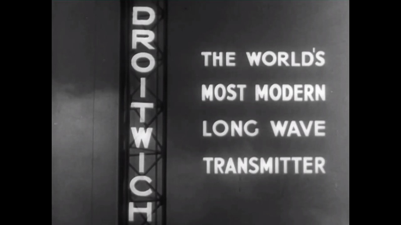

Here’s where it all started - a few handy ideas for SOTA portable kit, too…
@GM4LLD was there when they applied for planning permission. :laughing:
Looks like the fella at 1m31ms is testing an early FT-891 + ATAS prototype for a drive-up QRO SOTA.
That’s a great docu, I’ve it saved to watch fully later on, thanks Adrian. :+1:
