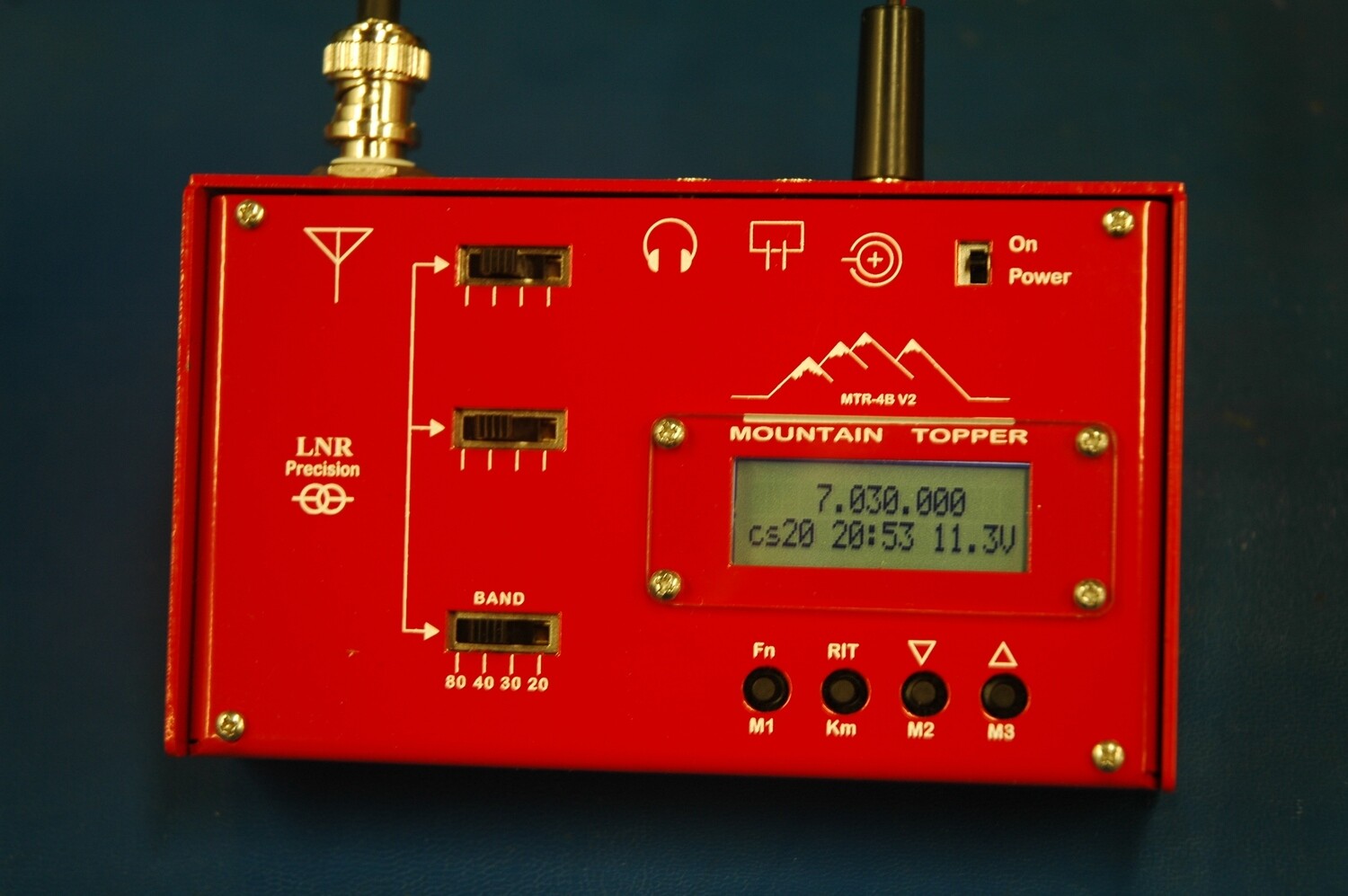

I have a MTR4BV2 as well. I have only been using these micro-QRP rigs since July so I am very novice so take that into consideration! The two transceivers are very similar in performance with the only very slight difference being better filtering in the MTR.

See LNR have a production run of the MTR4b v2, could take a few weeks for delivery though.
