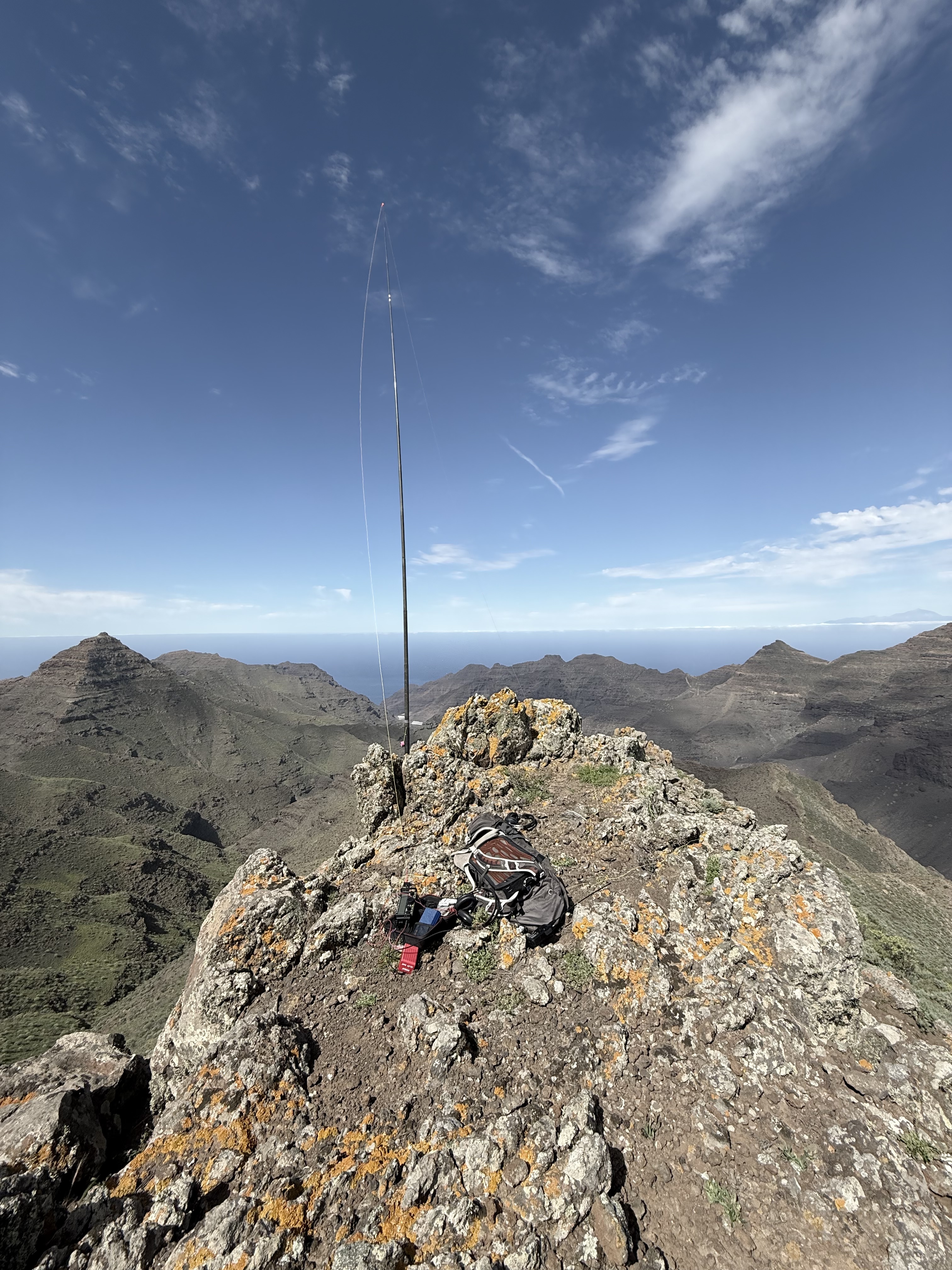

That said just using my KX2 and 10watts gets me very impressive results. That’s all I took on my recent trip to Gran Canaria and I don’t think a QRO radio would have made any difference other than the extra weight I’d have to lug around !
When you up high you don’t need much

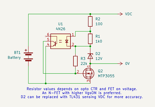

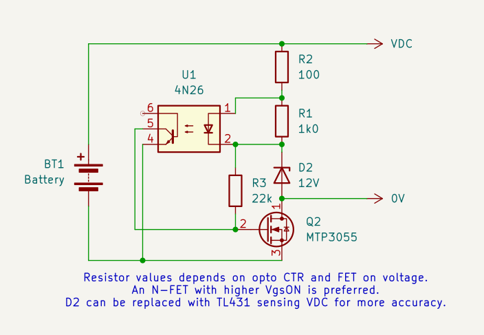

For those with a more delicate constitution , this is a simple regulator that has very low burden voltage when VIN<VDC
A benefit of doing this is when the voltage might go high enough to cause damage. A variation of this was used after a software controlled SMPS, where a bug or a fault, or just insufficient load, could put 40V on the equipment.
