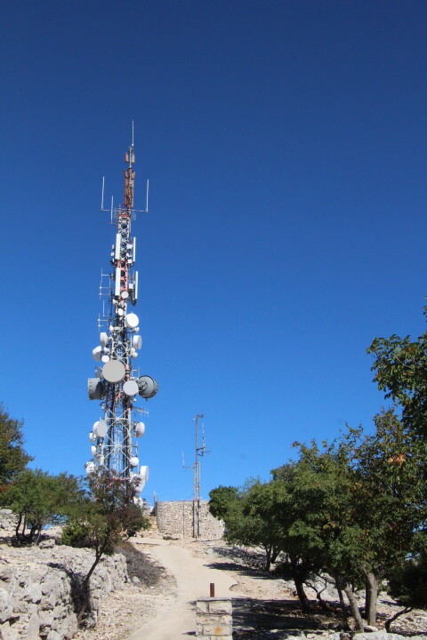

QO-100 on 9A/DH-053 Vidova Gora with small antennas 2022.09.18
9A/DJ4FF/p on Vidova Gora, SOTA reference 9A/DH-053, in digital modes with small antennas.
After my first test in August on Wülzburg in DL with small aluminium dish I reduced antennas sizes
drastically and it still works, so this might be interesting. 12 digital contacts in 90 minutes from Vidova Gora, the highest elevation of the Adriatic Islands. Longest distance VU2.
