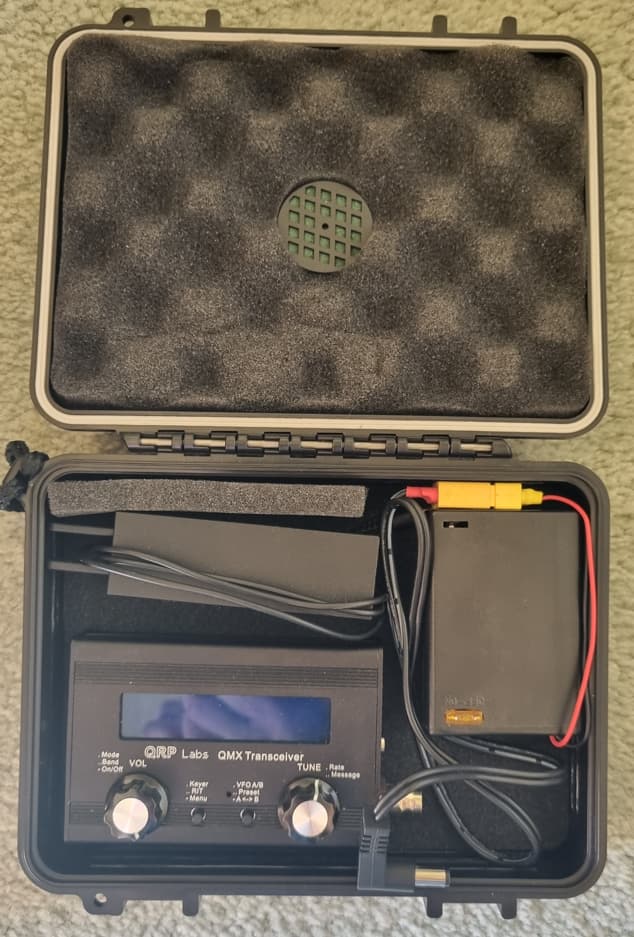

Very happy with my QMX so far, I had a problem with a shorted FET pad on the regulator board which caused some grief, but it’s running now. Sensitivity and power out is good. I’ve packaged it up and it’s powered from 3 x LiFePO4 AA size cells to keep the voltage safe. It fits nicely with a key and 3 cell pack in a mini waterproof case from Jaycar. Hope to test it out in the field soon.
Cheers, Glenn VK3YY
