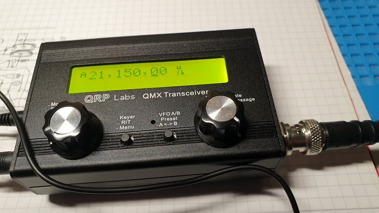

Today I had time to test the current beta version of the SSB mode. I didn’t change any settings.
Maybe it’s missing a bit of mic gain, but listen for yourself…

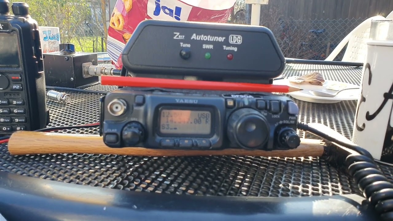

The second test was even more impressive. Transmitted with the QMX and heard with the Yaesu FT-817. Mic gain 55, compressor first 3, then 5 and 4 in the end.

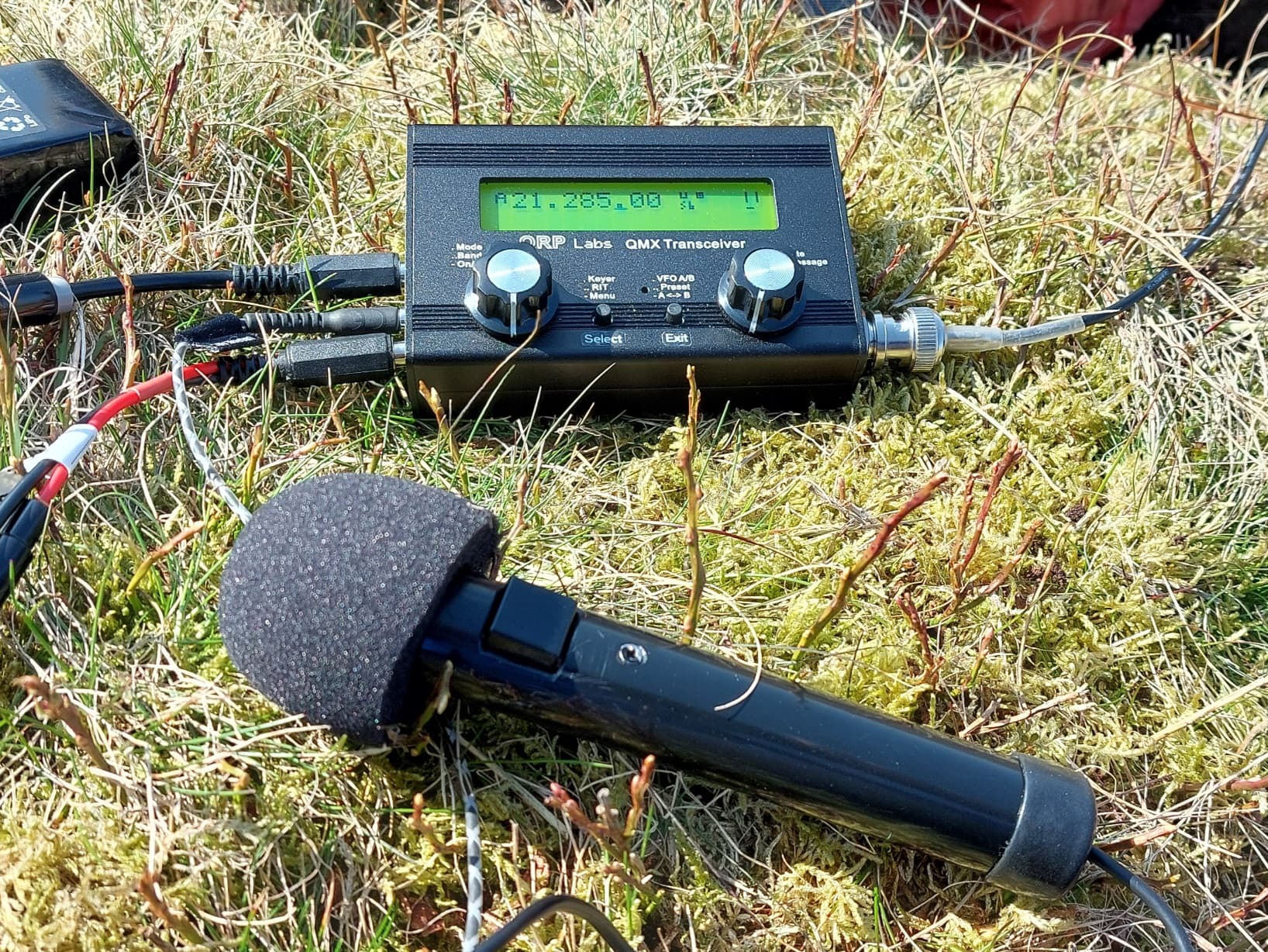

Was running out of time yesterday on Wards Stone G/SP-003, as it was a long walk back to the car, but I found a few minutes to plug my old BITX microphone into my QMX, and try for some SSB QSOs on 15m.
I managed 4 SSB QSOs before packing up.
73, Colin
Congrats on your first SSB-QSOs with the QMX!
I like that your microphone is much bigger than your radio :rofl:
73 Heinz
Yes, I have ideas to build a smaller microphone.
The microphone didn’t seem so big with my home brew SSB transceiver!

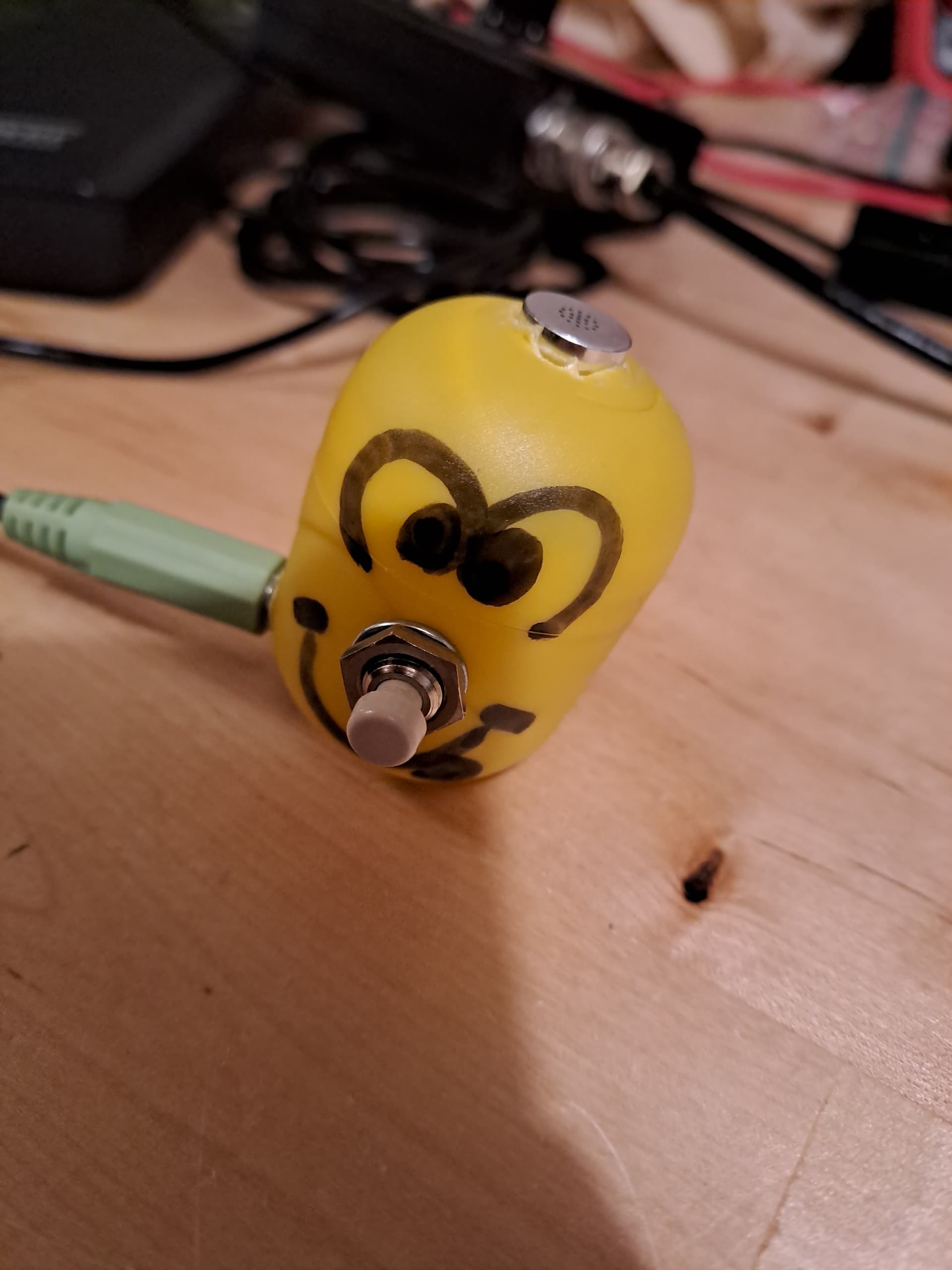

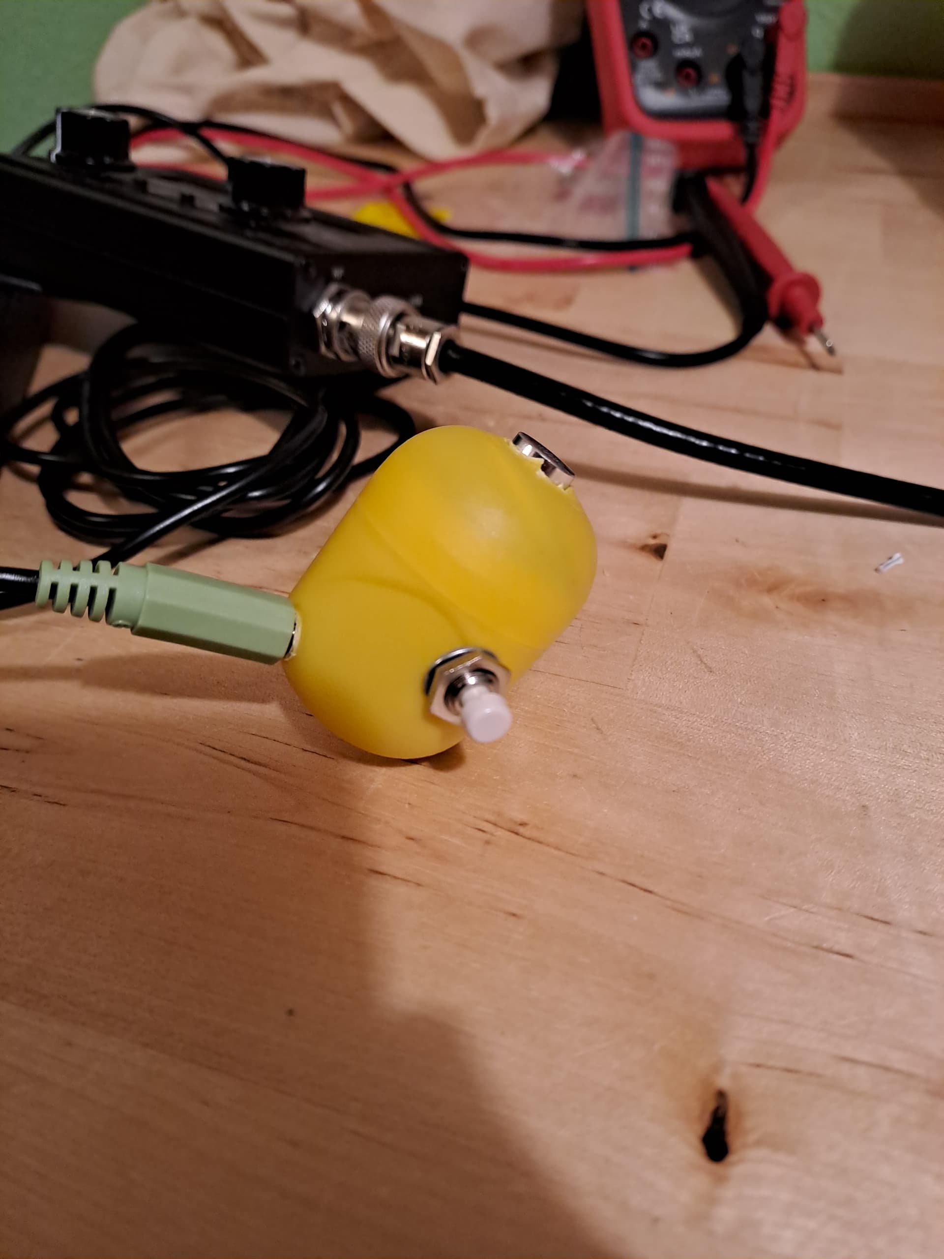

Good evening everyone. I have bought a small suitable microphone but I am not sure how to wire it up. Plus from the microphone goes to the switch. Ground also goes to the switch and also to the microphone. At which point does the jack socket go? The tip of the jack socket goes to ground.
Marcel DM3FAM
I made a mistake in my thinking. Now the microphone works. Currently housed in a former surprise egg for testing. And because it looked a bit boring, it was renamed the microminion :wink:
73 Marcel DM3FAM
Microphone is Ring and Ground
PTT is Tip and Ground
When using and old Yaesu mic, I had to cut some pcb tracks and re wire the PTT switch to Tip and Ground
Thank you Paul @MW0PDV We responded at the same time. It works.
73 Marcel DM3FAM
