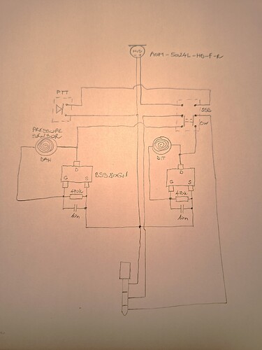

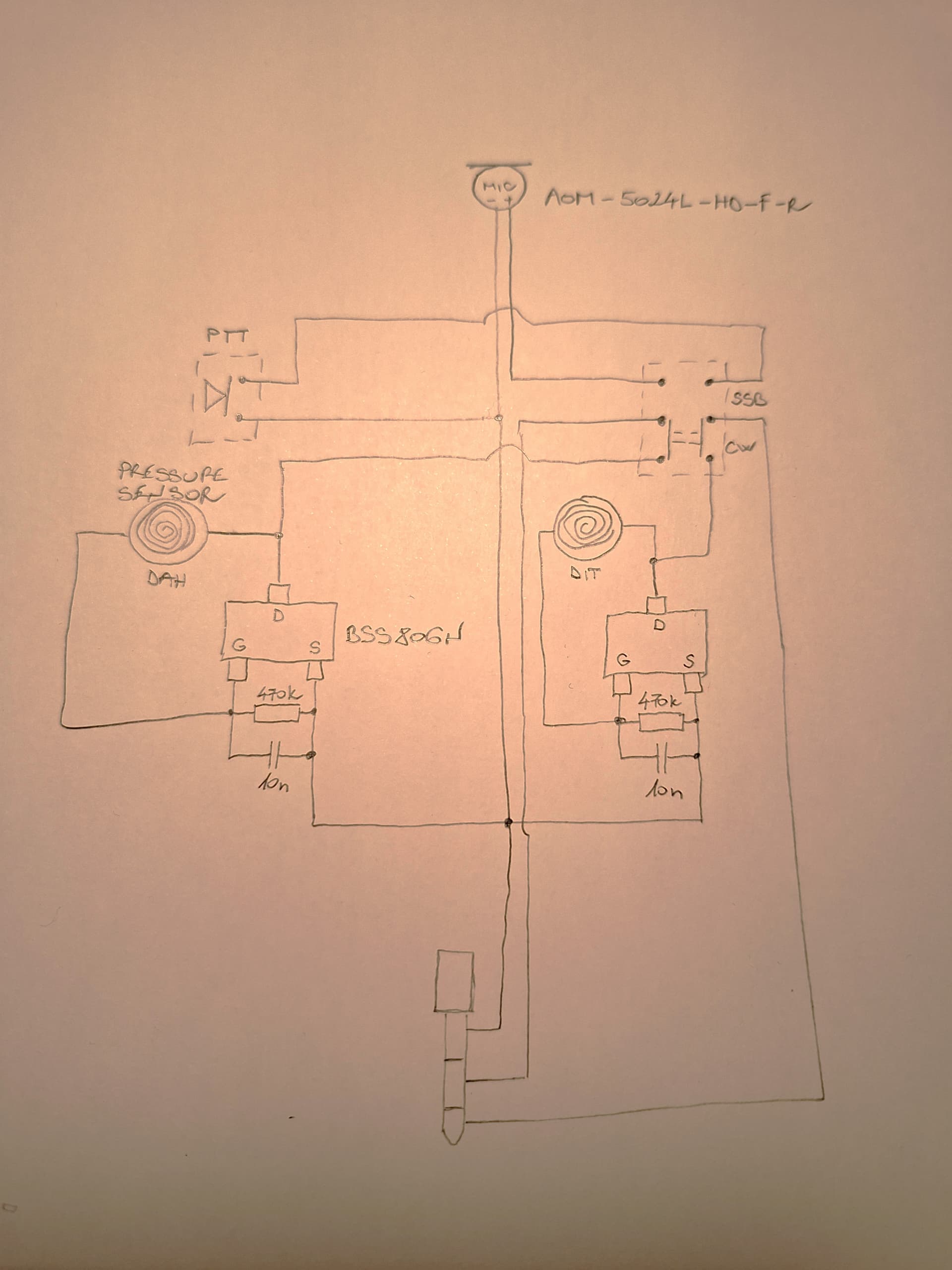

I like that one, do you have the building details documented somewhere?
That looks brilliant, well done. Do you have a build anywhere for it and perhaps the STL for the case? I would love to give this a try.
I still can’t get the @K6ARK mic I built to work with my QMX, the KX2 one works fine though. This looks like a great little all in one solution, perhaps to modify the mic wiring so you can make them for other radios too?
Pressure paddle is based on VK3IL paddle:
Here is my schematic:
For STL files and other details, send me email (adress is on qrz.com).
