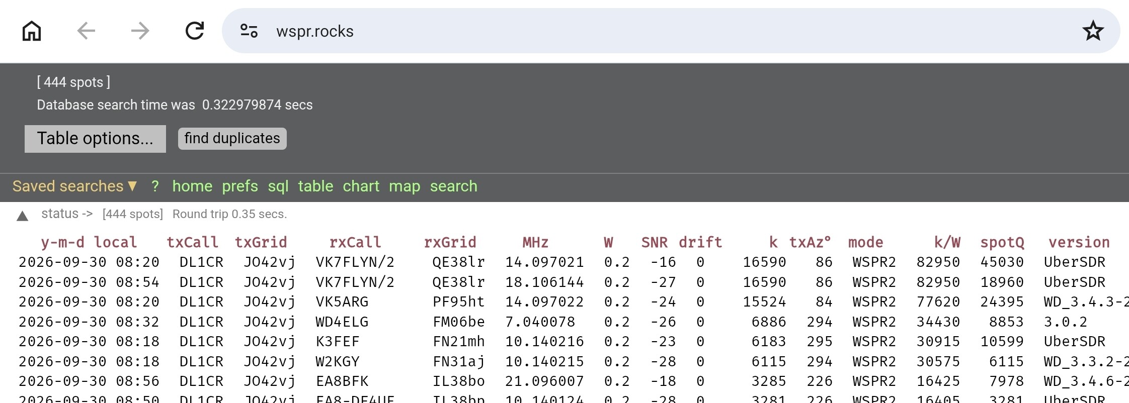

To better assess local DX conditions, I cranked up my WsprNet beacon DL1CR to 200 mW.
I was obviously lucky when I recognized VK4FW on POTA this morning and heard him working through a pileup of European stations - without my being able to hear a single one of those stations myself (meaning zero QRM from kilowatt PAs or beam antennas, hi).
So, I only had to call for about five minutes before making my first chaser POTA QSO with VK - and all this using my ā€œalmost invisibleā€ indoor doublet antenna. (BTW, a P2P POTA QSO with VK is already in the log …).
As it turned out, my luck lay largely in the fact that the QSO happened just moments before he went QRT, right after he had thoroughly fished out the ā€œpond,ā€ hi.

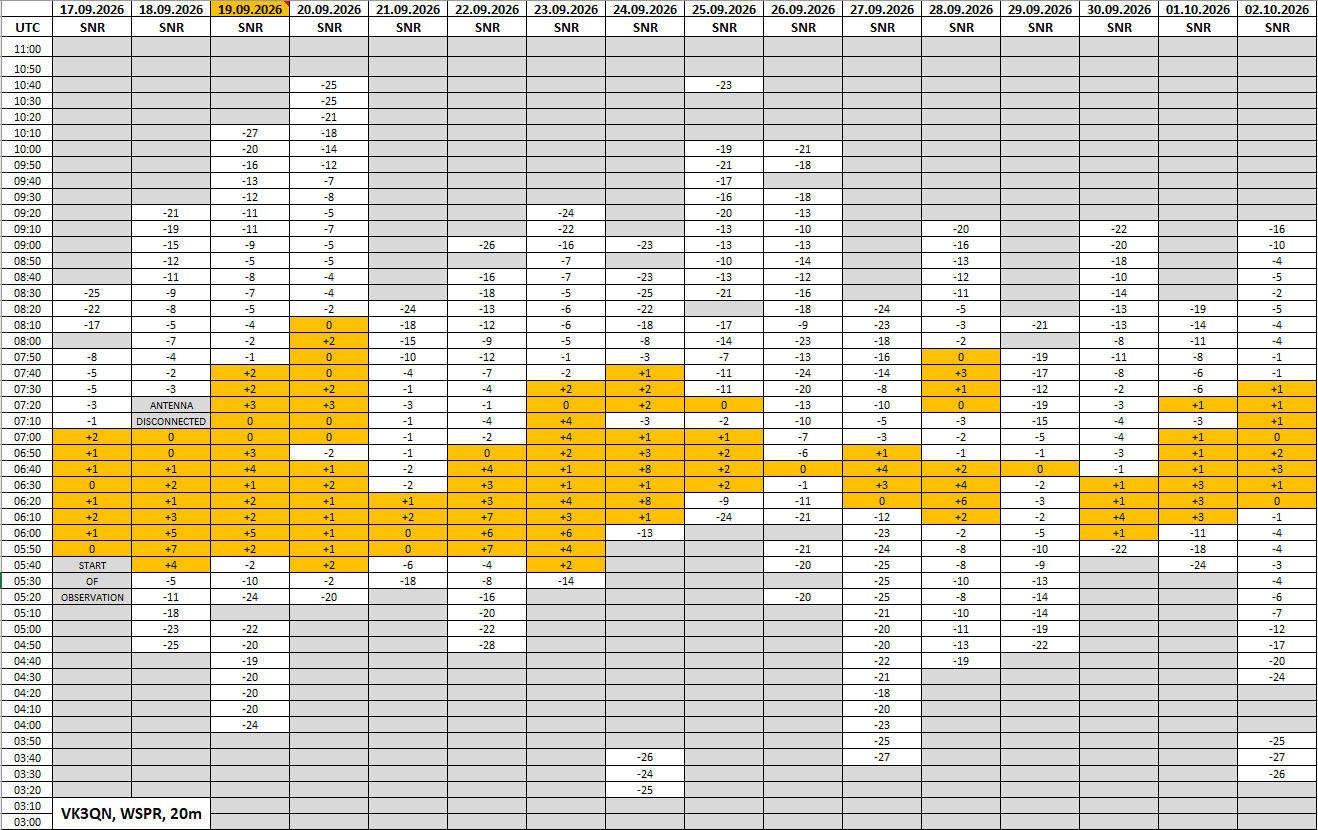

VK3QN on 20m WSPR at my QTH in JN48 with fairly high local noise level.
A few experiments suggest that the signal path should be suitable for SSB once VK3QN’s SNR becomes positive. However, this is not a fixed rule.
The assumption is - of course - hat the noise is more or less constant but that’s not under my control.
It looks as though, after a few days of rather changeable conditions, the situation is returning to something more stable. Let’s wait and see what impact the forecast CME has.

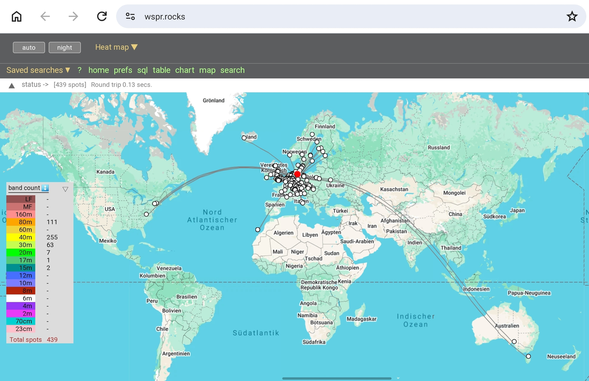

My VK1AD 200mW 20m WSPR: EU long path opened at 06:02 UTC and was still open at 08:20 UTC.
Edit: now closed at 08:30 UTC
Andrew VK1AD

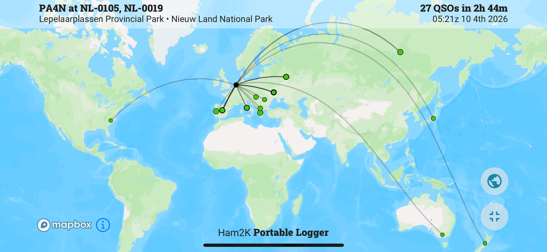

This morning I was on a park bench in my home POTA park before sunrise, testing out my gear for the upcoming VK/ZL - EU S2S event. I had brought my QCX-mini plus the QCX amp which puts out 35W on the cordless drill battery pack, and an inverted vee dipole with the apex at 10 meters. All the gear turned out to play nicely. And the conditions were pretty good too.
I’m looking forward to being on PA/PA-003 in 13 days! Hope to hear many of you then!
Some of the highlights from today:
  • I heard VK1DA/P who was (again!) on Mt Stromlo but I couldn’t get through the pileup. I think I heard Andrew working a JI2 station, maybe JI2MED? I was surprised I could hear the Japanese station; I hardly ever hear JAs here…
  • ZL1TM called me at 0620Z (35m after my sunrise; 2m before his sunset). He was a solid 559 at my end; I got a 539 in return.
  • At 0626Z I heard VK3PF calling CQ a couple kHz above me. I worked him easily, handing out a 449 and receiving a 539 from him. This was 40m after my sunrise and roughly 2h before his sunset.
  • Some time later, JI2MED called me at 0716Z; he was 549 at my end and I received a 559.

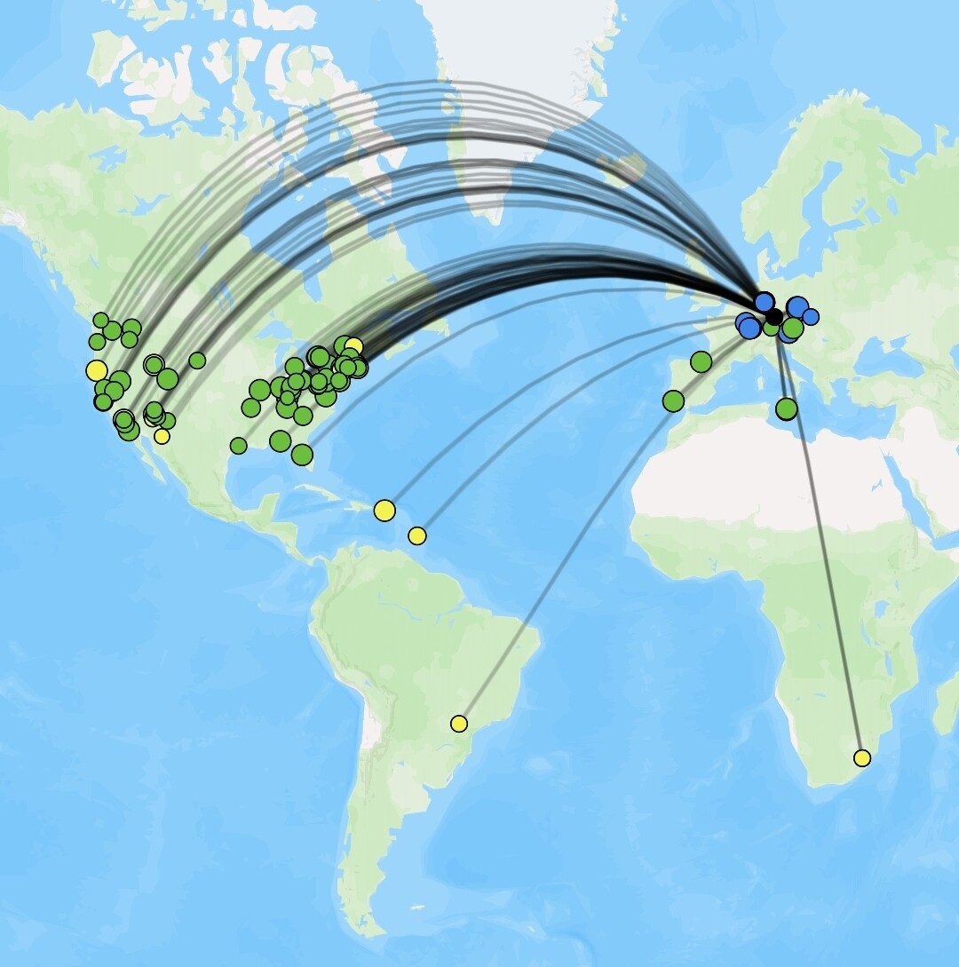

All of the DX QSOs on that map are chases of portable SOTA and/or POTA staions! Towards the end, Keith @KR7RK made my day on HF. I had worked him before, but he was spotted again on a new summit W6/NC-178 on 20m CW with the comment ā€œKH1 with whip only, not a nice summitā€. To my greatest enjoyment, I was really able to hear him deep down into the noise. He has not yet uploaded his log, but I heard parts of my callsign, my rapport and the 73 in the end :face_with_hand_over_mouth:
So even if there was not a single long path QSO, I had a great DX evening!
Thanks for the report, Thomas!
CONGRATS on your great achievements, both, with your special event ā€œTüren auf mit der Mausā€ as well as with chasing SOTA DX!

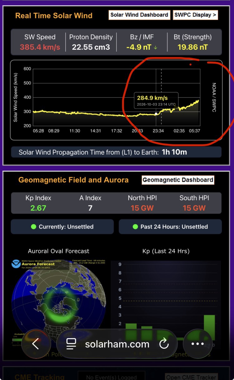

Looking at the QSO-map, one gets the impression that condx must have been excellent. It was exactly the right thing to stay in the shack - looks like you’ve caught the hours before the solar wind speed and density picked up significantly.
73, Roman
Thanks for sharing this plot, Roman. I picked just the right time to be at the station and I also went home at the right time :joy: :heart_eyes:
