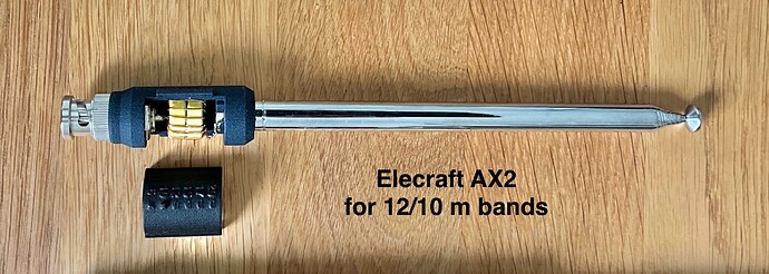

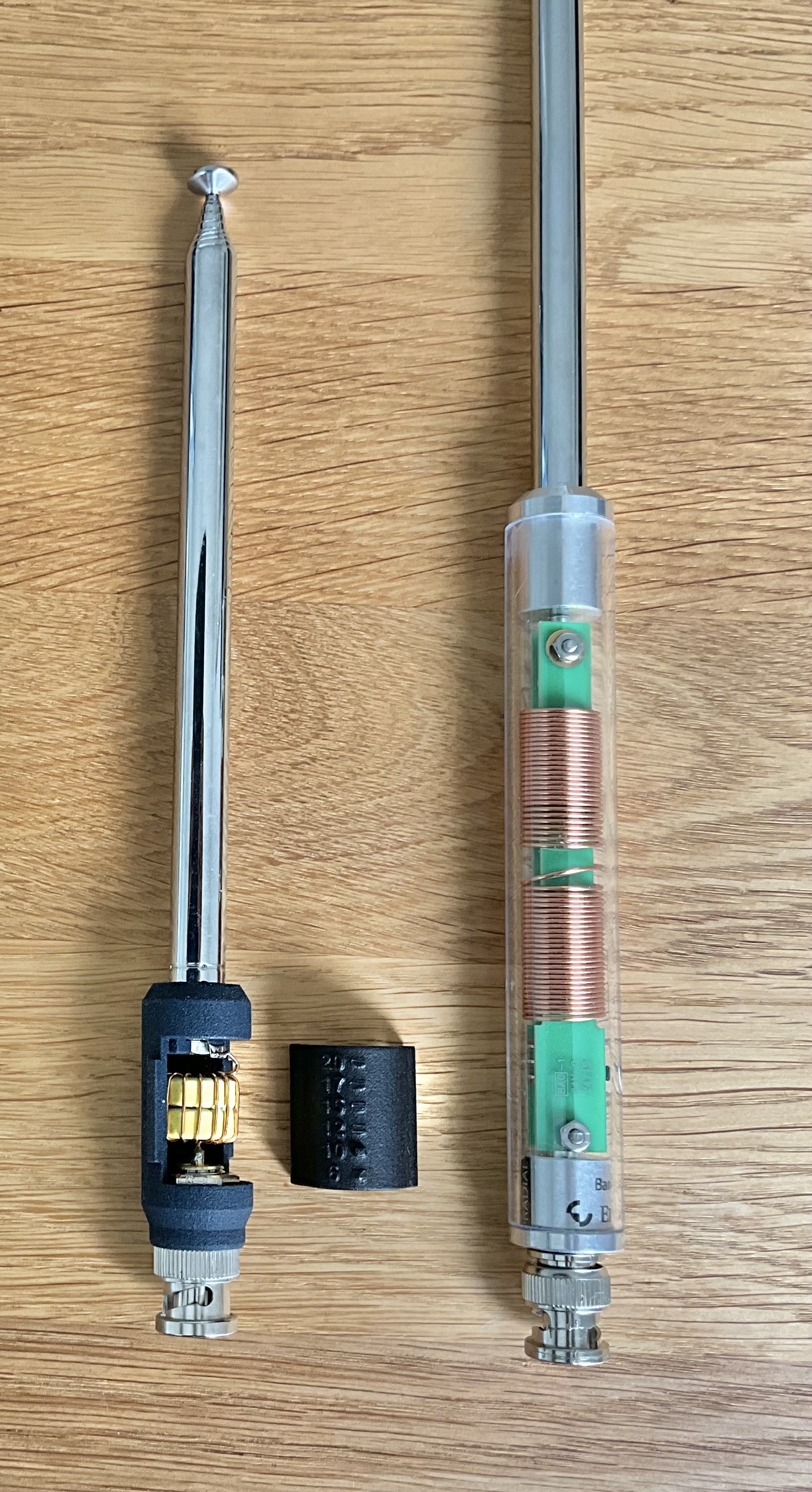

[quote=“HB9BCB, post:3, topic:35797, full:true”]
Edit
Markus, I could actually give you the loading coil for the bands 10/12m (built into the AX2 housing), with or without AXW1 whip, for your retirement, a little late but maybe not too late, hi.
Hw?
BTW, I know of a SOTA colleague who uses the AX1 on the switch position 17m with the KX2/ATU without any problems (VSWR 1) even on 10m.
Is there possibly a contact problem when connecting the radials to the KX2 or is a long coaxial cable still being used?
