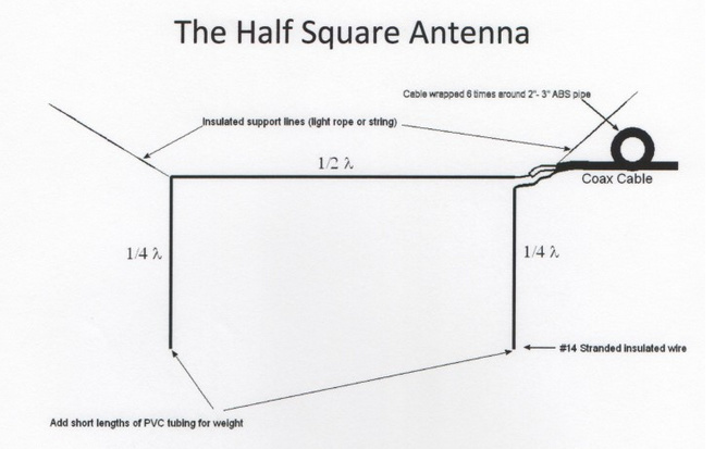

I haven’t used one for SOTA work, but I’ve had very good luck with both 17 meter and 20 meter half-square antennas at home. They are easy to make, but need 2 supports and should be considered single band. That said, it’s a phased vertical arrangement that works very well, even without a ground array. Here’s an article for guidance http://w6af.org/makerspace/build-your-own-ham-antennas/half-square-antenna-easy-wire-dx-antenna/ 50 Ohm feed makes this a very attractive antenna for summit work if you can find a way to get it hung in the air.
Interesting antenna Bruce, the only “complicated” factor is that feedpoint at the top of the righthand 1/4 wavelength vertical that may not be fed vertically along side the right-hand 1/4 wave vertical - I supose the feed coax could come down a guy line if used, otherwise pulled off to the side.
Ed.

I made one of these a while back… checked it on the antenna analyzer but never got it to the woods yet… I put 3 1/2oz lead weights on the vertical 1/4wave elements and fed it with RG174… Used 26ga wire from Sotabeams. pretty huge antenna (for the woods) that would benefit from a known location set-up…
I also made a wire Moxon for 20M… also HUGE and fairly unwealdy… The half square should be easier to use… but they should have gain and be ideal for this event…
