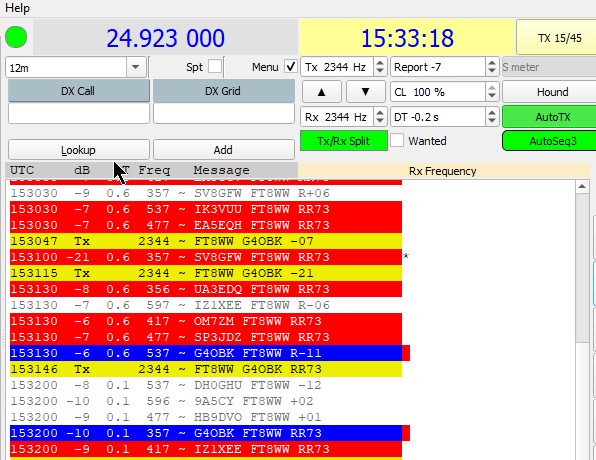

I got a 12m FT8 QSO this afternoon with FT8WW, new band for me for the DXCC Challenge. My 3rd day trying for 12m, total TX / Monitoring time to get the QSO over three afternoons about 3-4 hours. He peaked -4 today with five streams running and I got him when he was -6 just 2 minutes later. He faded out at 1620z which was 50 minutes after my QSO. He was stronger for longer today than the last two days despite him upping the MSHV ante from 4 streams up to 5. I still await that elusive CW QSO though for #339. When he has been strong enough to hear well he has been on FT8! I tuned in today between 1230z and 1330z on 21045 KHZ and at best he would have been 439 with a VFO QSX spread of at least 11 KHz up. Good luck with the DX!
73 Phil G4OBK
ScreenHunter 173
PS Correction after 1620z he went to 24891 CW now trying for him… a good 559-569 he is 1656z

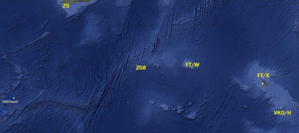

With the Marama already ~300 miles north of Bouvet heading to Cape Town (ETA approx 6 days from now), a closer look at the Garmin tracking map shows some other rare DXCC entities way in the distance. We don’t know next plans for 3Y0J group but any one of these entities is welcomed! Readers may also be interested to watch the video below of Axel DL6KVA making contact with another rare one!
https://twitter.com/i/status/1626660732430438400

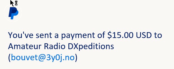

QSLing for 3Y0J - if you have worked Bouvet and need a QSL / LoTW confirmation quickly the current UK exchange rate is £13.12 (€15) via PayPal. I see this as serving as a well deserved small donation to the DXpedition. QSL via OQRS from the QRZ page of Charles Wilmot M0OXO
Club log check log
73 Phil G4OBK
PS Edit: The OQRS money goes direct to the DXpedition organisers not the QSL manager:
